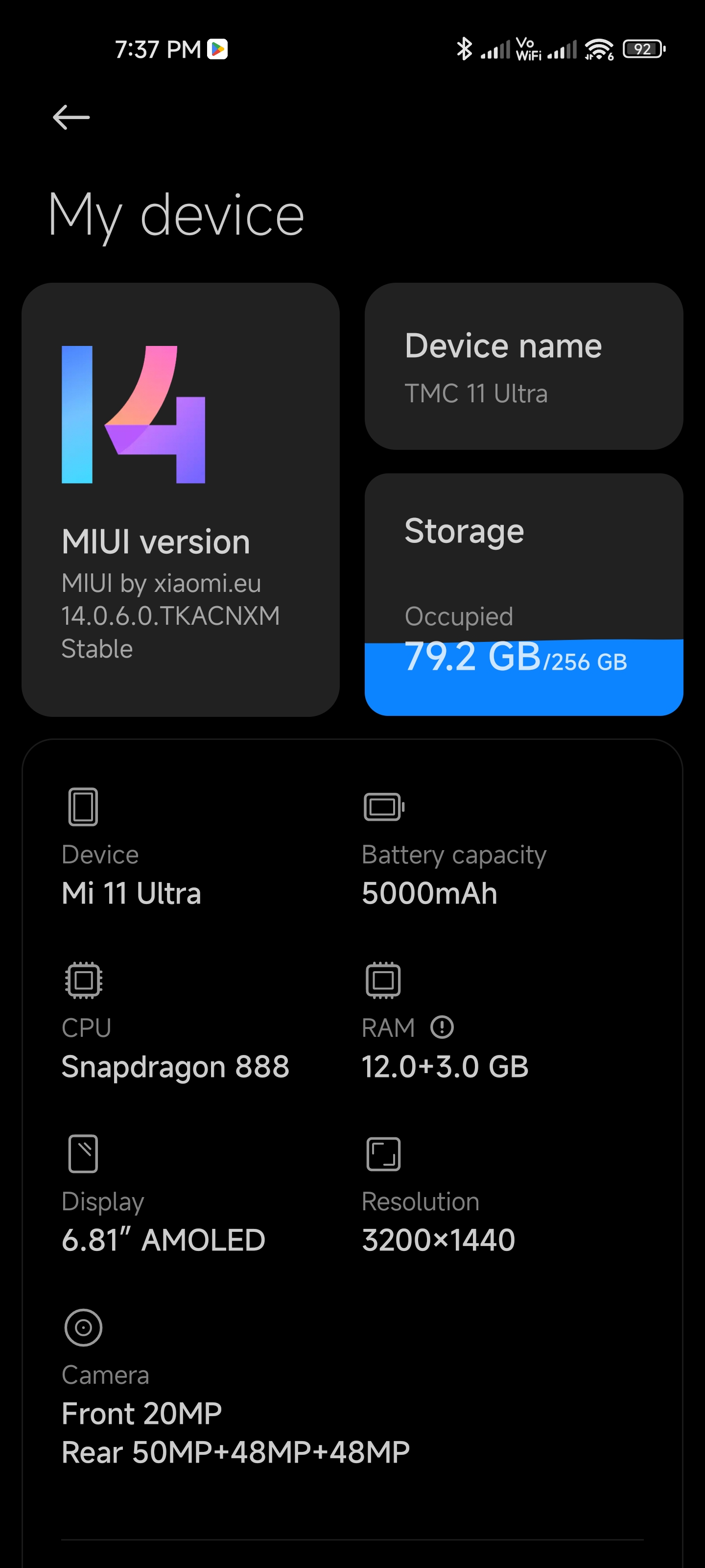

Just upgraded My M11 Ultra (star) from MIUI 13 Stable (Latest) to MIUI 14 Stable.
Downloaded the latest TWRP and Xiaomi Rom and copied them into my platform-tools folder
from admin command prompt
fastboot boot twrp-3.7.0_12-v6.9_A13-star-skkk.img
Copied the new ROM to the downloads folder
Selected install in TWRP and installed it.
Flashed and received errors about remounting '/system_ext' etc
Ignored them and rebooted. First boot didn't take too long.
Upgraded successfully.
Upgraded successfully.View attachment 45808
