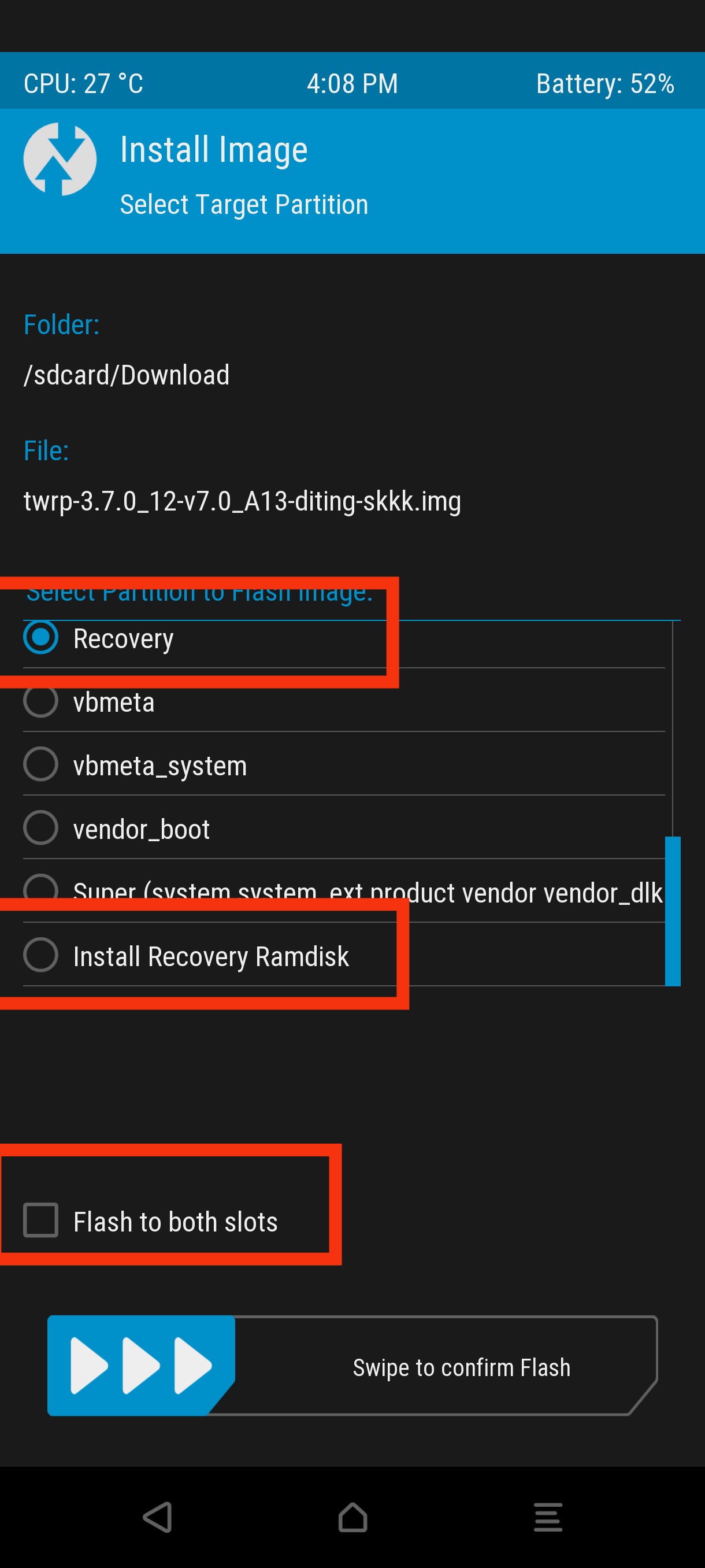

Hello, I have a 12T Pro (Diting) I would like to update the existing TWRP.
Since it's a A/B type of device what options should I use to update?
You should read the how-to:
