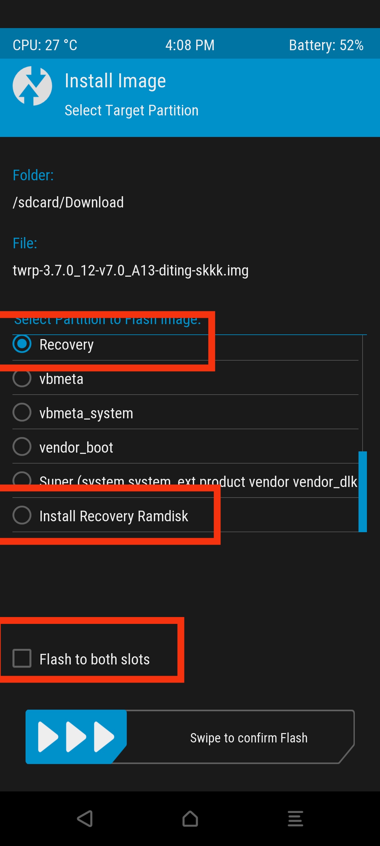

Yes I did mention that it is a 12T Pro (Diting) A/B device.
I just want to update the TWRP and I have these options
You answered your own question then since Diting isn't a ramdisk recovery device. ;)
And no, you didn't mention your device in the reply. I shouldn't have to go hunt again for your previous posts to figure out what device it is.
Ok so in TWRP I select recovery and flash to both slots option?
Or just recovery?
Or just recovery?
Yes, either should work, since I don't believe this rom uses A/B for alternating updates, but flashing to both slots should make sure its in both A and B (recovery_a and recovery_b) partitions incase for whatever reason your phone did decide to use slot B.
I don't have a A/B recovery device here to test, but worse case you'll just have to reflash the recovery with fastboot.

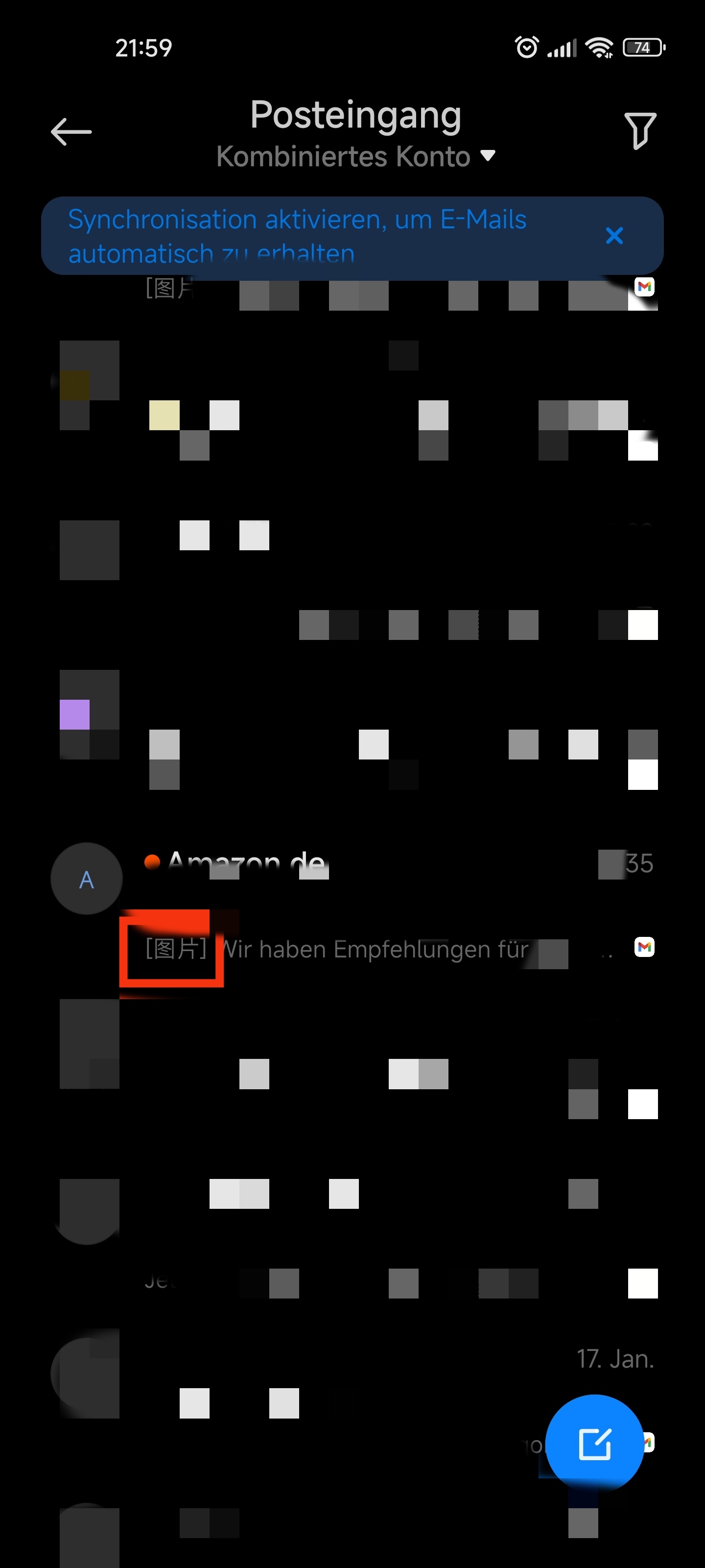

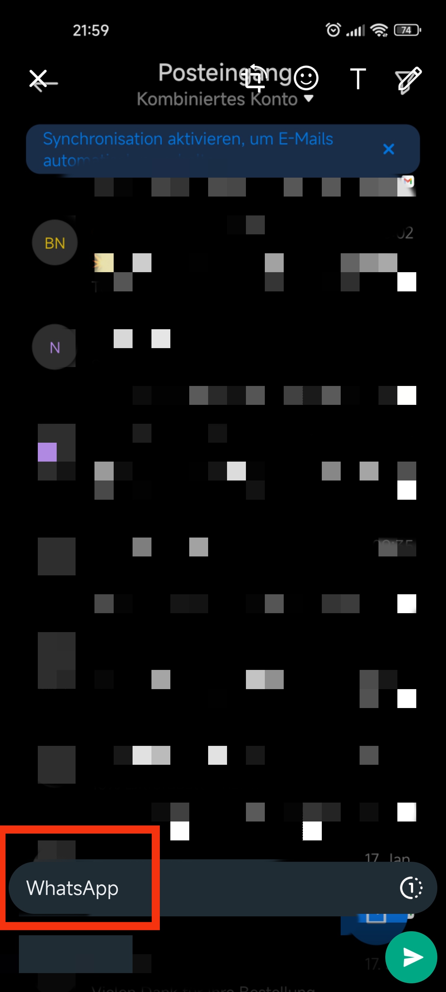

First of All big thanks!
I found two minor bugs/errors:
Dont know for sure if this might be some WhatsApp error, but i recognized since upgrade to miui 14: whenever you want to share something via WhatsApp theres a Standard Text "WhatsApp" below the File you try to send.
Also in Mail app there are some Chinese chars in the preview, i think they say "picture" or "Image" ?
Maybe Translation errors?
