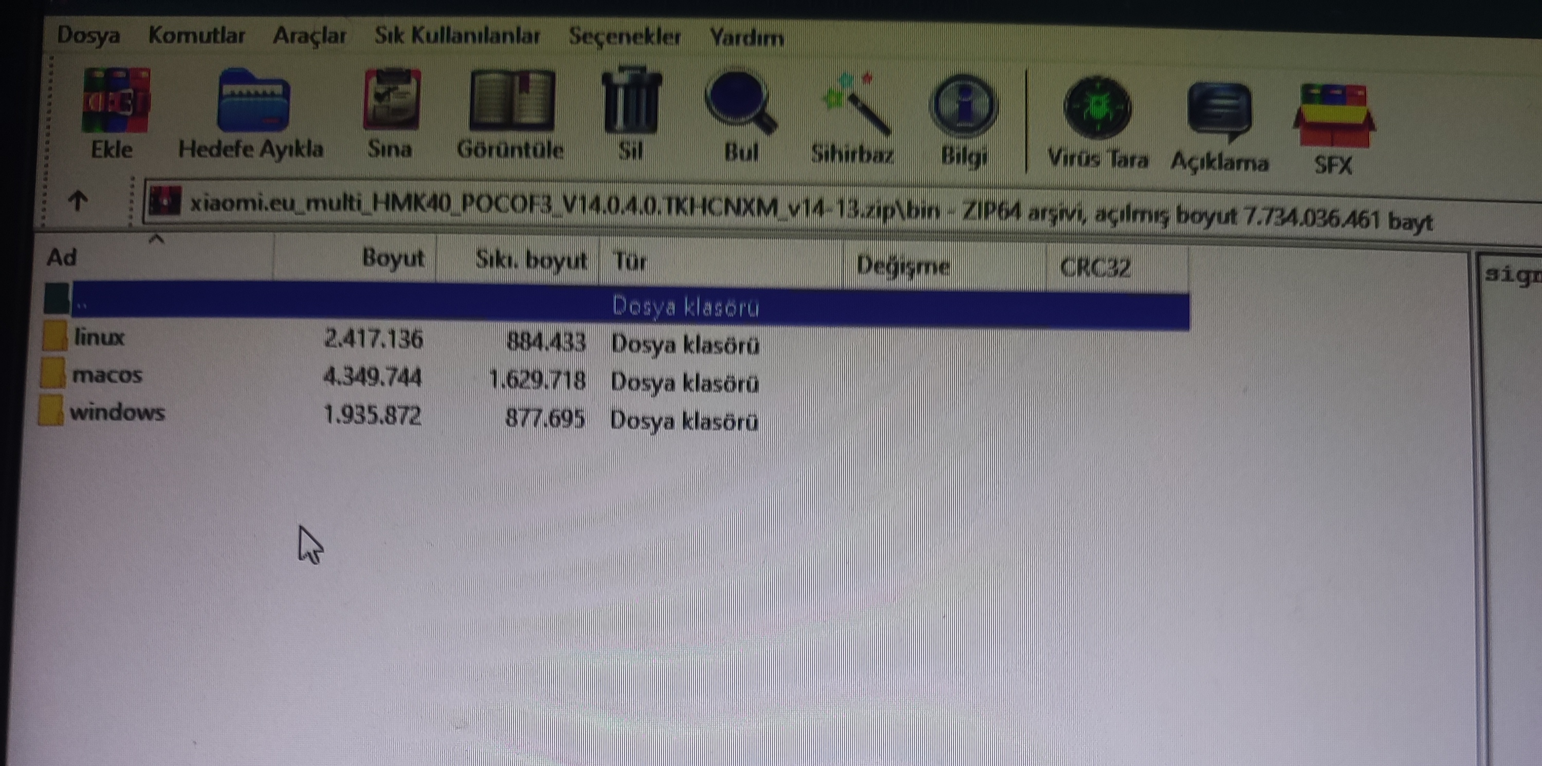

Hi, In Linux, fastboot path should /bin/fastboot and not /bin/linux/fastboot. Please correct it for the future builds otherwise newbies will be screeming out loud :D

1) Learn how to use your operating system, if you chose to use it.
2) You'll have to run these commands in Terminal inside the extracted ROM's folder:
Code:
chmod -x bin/macos/fastboot
chmod -x macos_fastboot_update_rom.sh
chmod -x macos_fastboot_first_install_with_data_format.sh
I do It but nothing..when I give the command in Terminal it reads "permission denied"....
I also had that, but if you check YouTube, there are people translating it. Also, I think there is another version that is English.

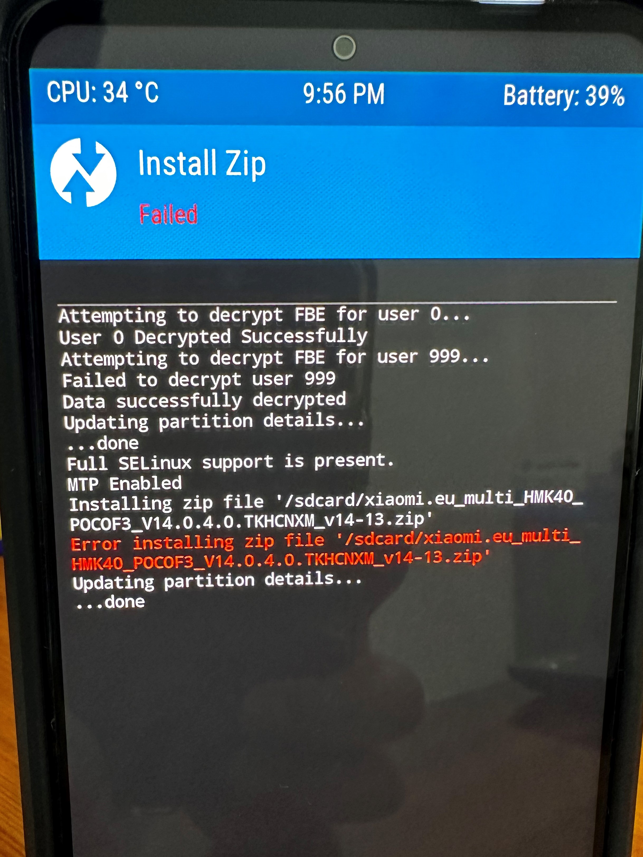

Hi, I am using a Poco F3 version 12.5.18 xiaomi.eu and want to update to MIUI 14. I downloaded the zip file, open Updater app -> chose the package -> the phone reboot into TWRP -> chose install -> chose the zip file and get error installing as the pic below. What should I do?
Safest bet is to extract it on you PC and flash using the Fastboot method.
After that, your TWRP will be updated automatically and you'll be able to flash using TWRP next time.
Your current TWRP is probably ancient.
Or you can try a more recent TWRP from here, your choice. I'd use the Fastboot method this time if I were you.
