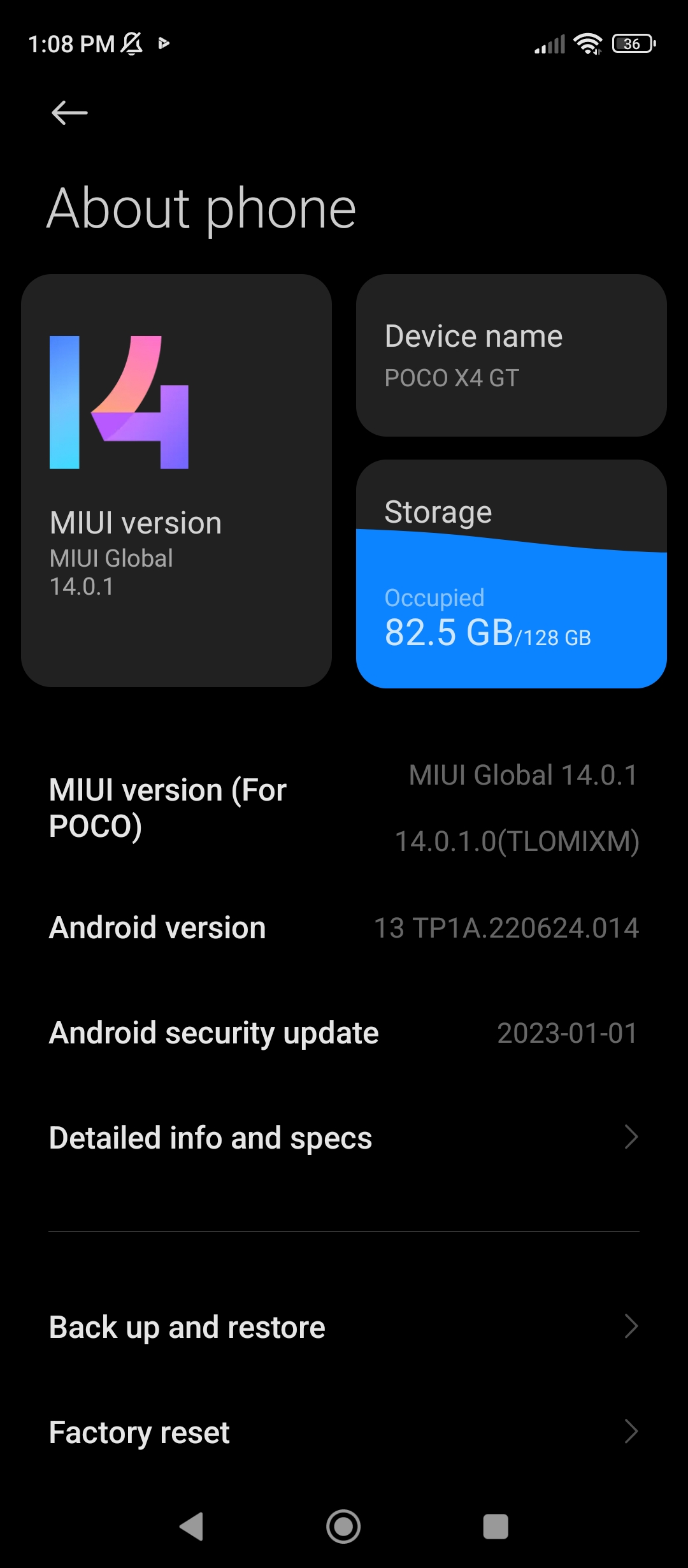

Hello, just want to ask do i need to downgrade my current version, from Miui 14 to Miui 13, to install Miui 14 eu version via fastboot? my device is Poco x4 gt. hope to hear from you guys soon thank you

You probably don't understand the written text. It doesn't say you should downgrade before installing.
Install the current version of xiaomi.eu ROM normally using the script - first_install_with_data_format
