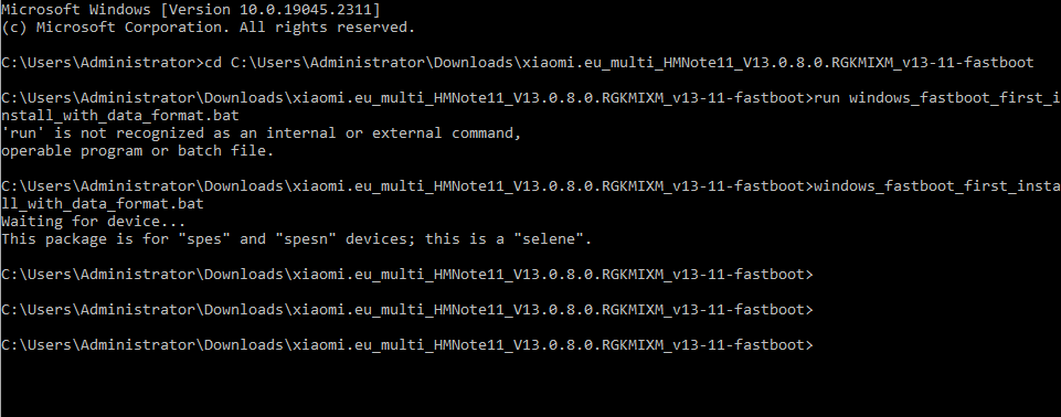

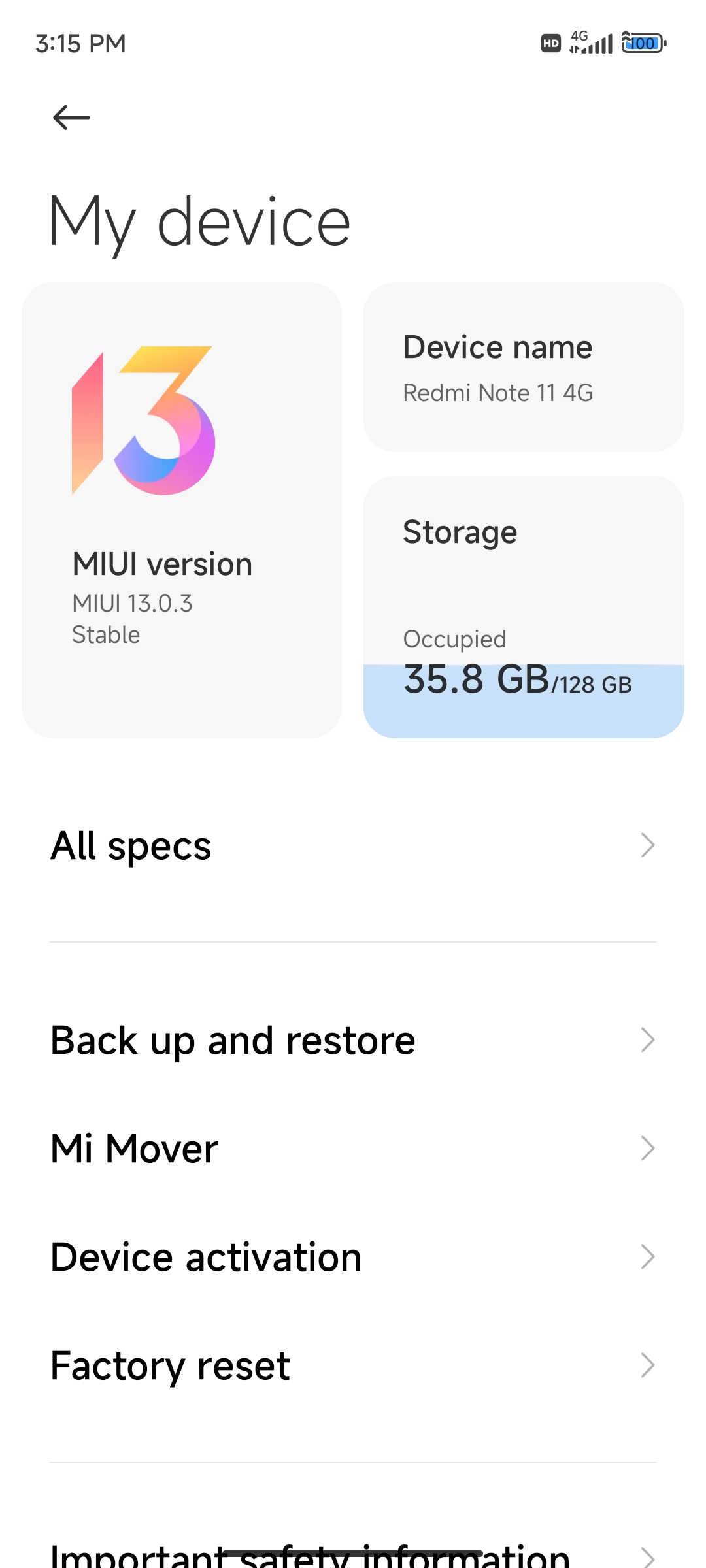

I have the Chinese version of Redmi note 11 4 G, but the name code he shows is completely inconsistent with the official forum as the attachments, and I can't find a way to flash TWRP,or flash boot any rom.
What should I do next? Or how do I do it again.

You are trying to install a ROM intended for another device (spes/spesn) with a Snapdragon chipset. You can't (mustn't) do that.
Your device (selene) with MediaTek Helio chipset is not supported by xiaomi.eu developers.

There is no global rom for this phone. If you bought it with global rom, it's a custom one. It's stuck on MIUI 12.5, and you can't update.
So you can use custom rom like Nusantra project.
