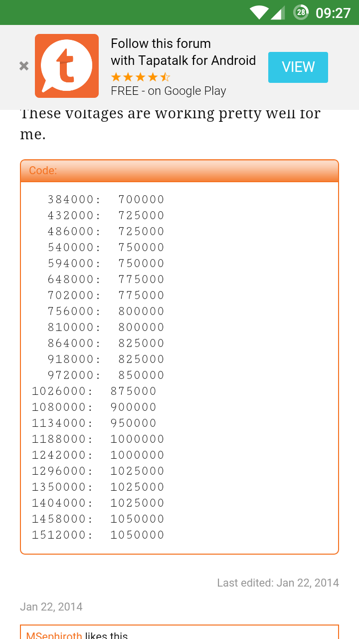

I use waiks undervolting settings and never had problems if you want to try them to
