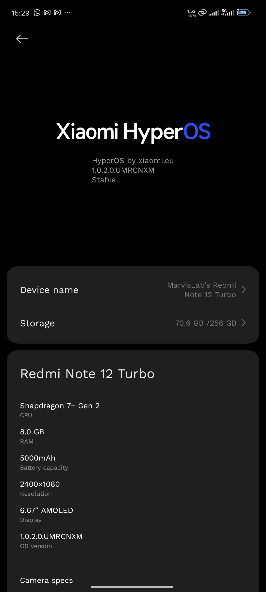

Thanks, I've flashed the rom already. Been using for 2 days now and so far the network and calls is very perfect no drops atall. The hyperos has been optimised very well, feels awesome.
Battery also has life improved very well compared to miui & aosp I've used before

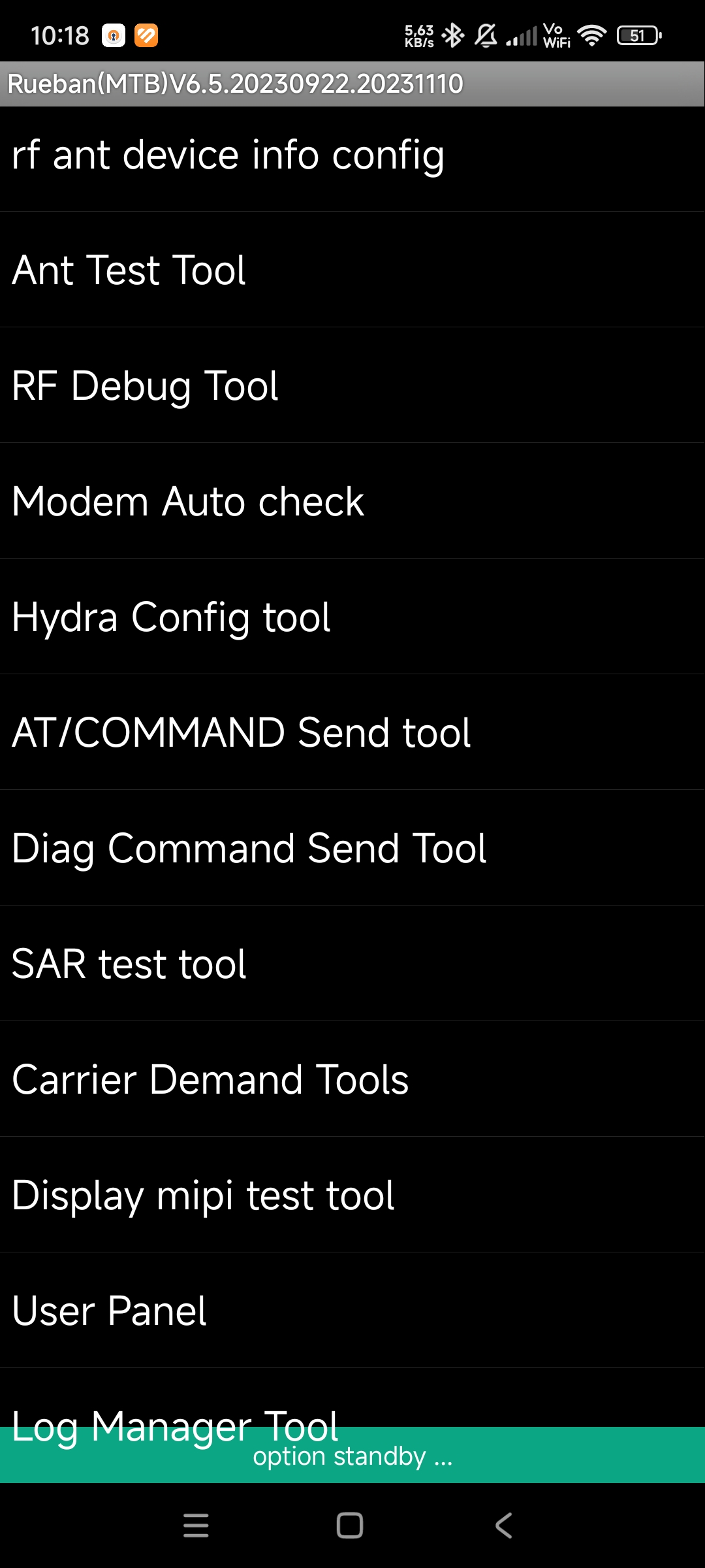

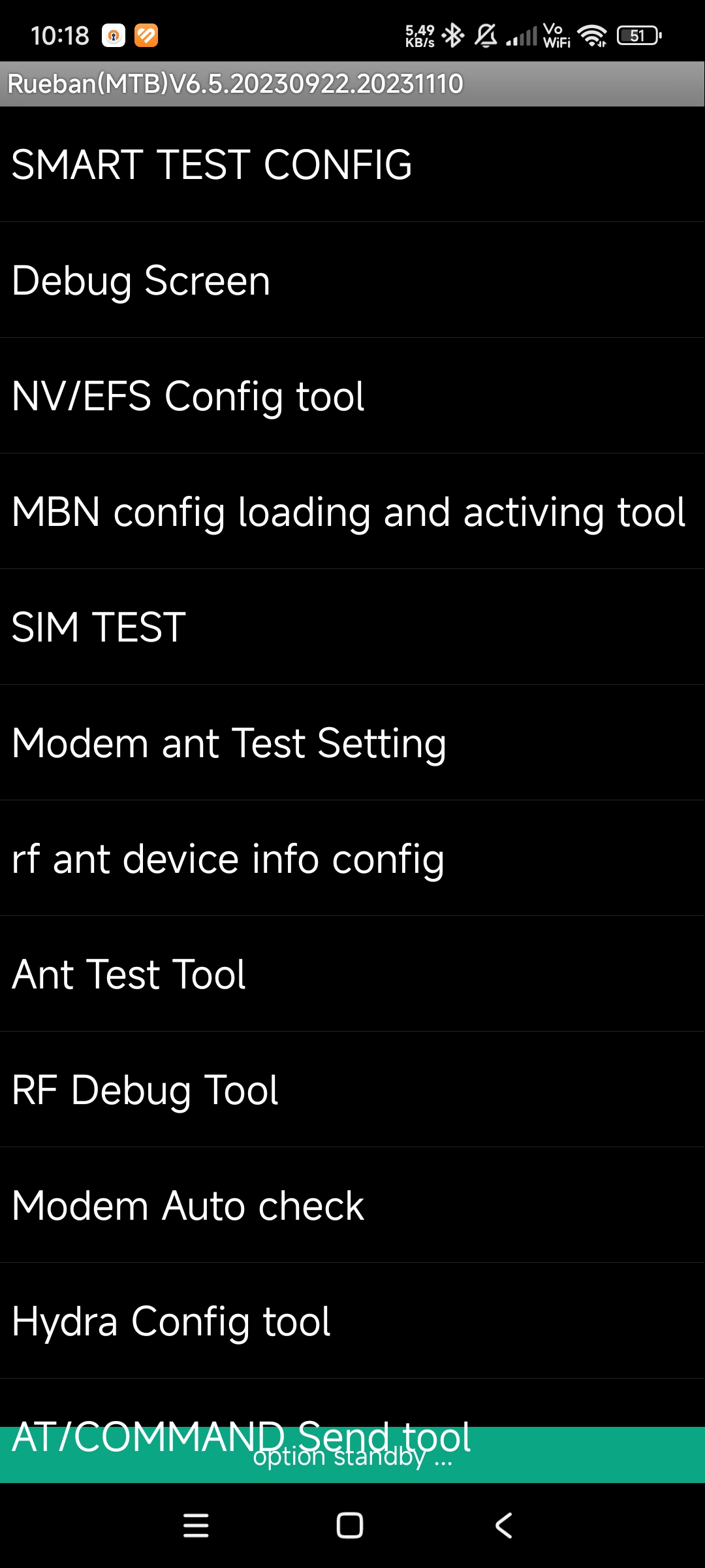

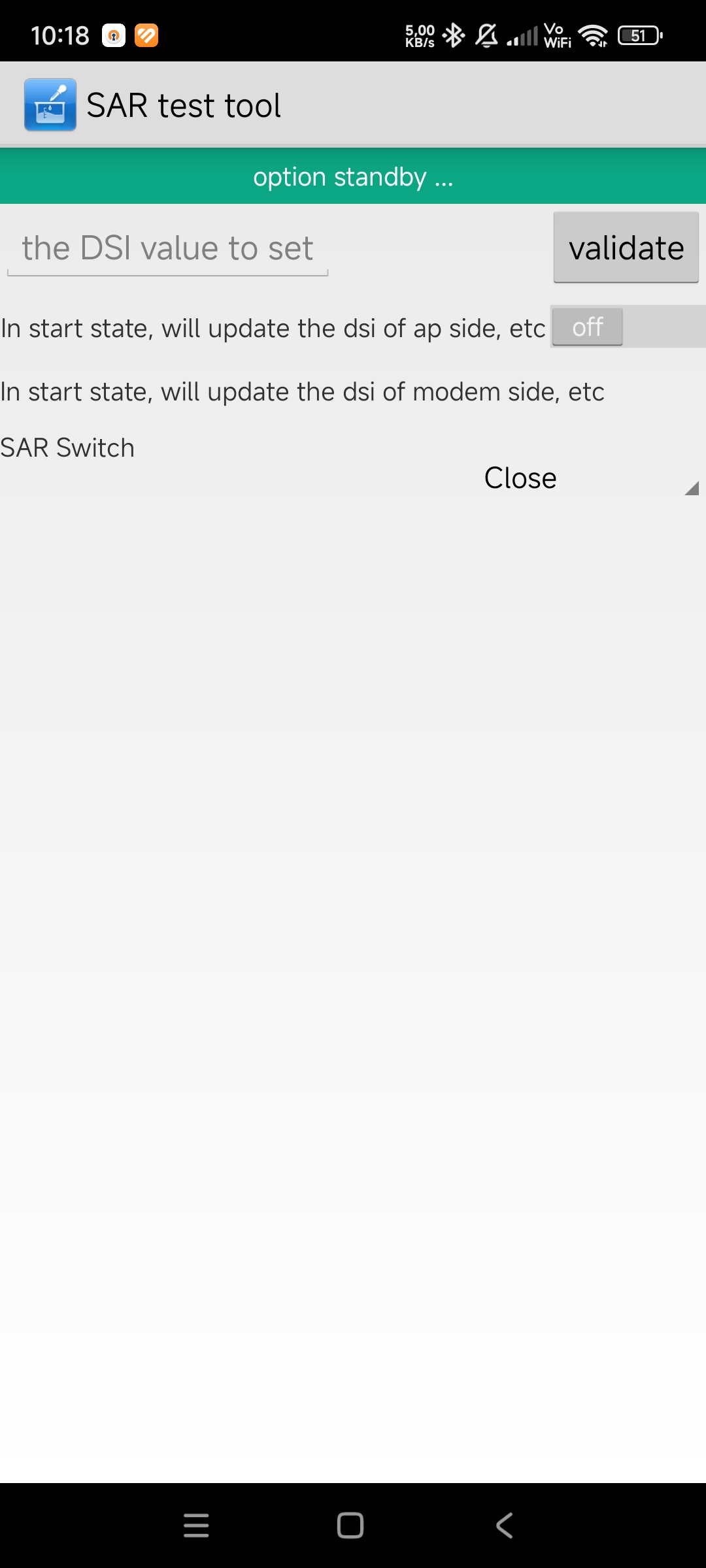

code is working on my phone, but i have the patched rom version installed..
but sounds interesting..
I'm not patched and I have not OFF switch.
