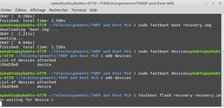

look what i have

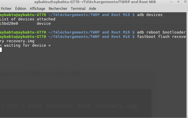

ok i've done that
i'll try again
Still have "waiting for device" ! pfffffffffff
when I using "sudo" it's working, but when i like to boot in TWRP, the phone boots in system again !

if the phone is in fastboot mode (which I assume it is, if you've done this before - it'll show FASTBOOT on the screen), maybe there's a driver or fastboot issue on the linux workstation.
