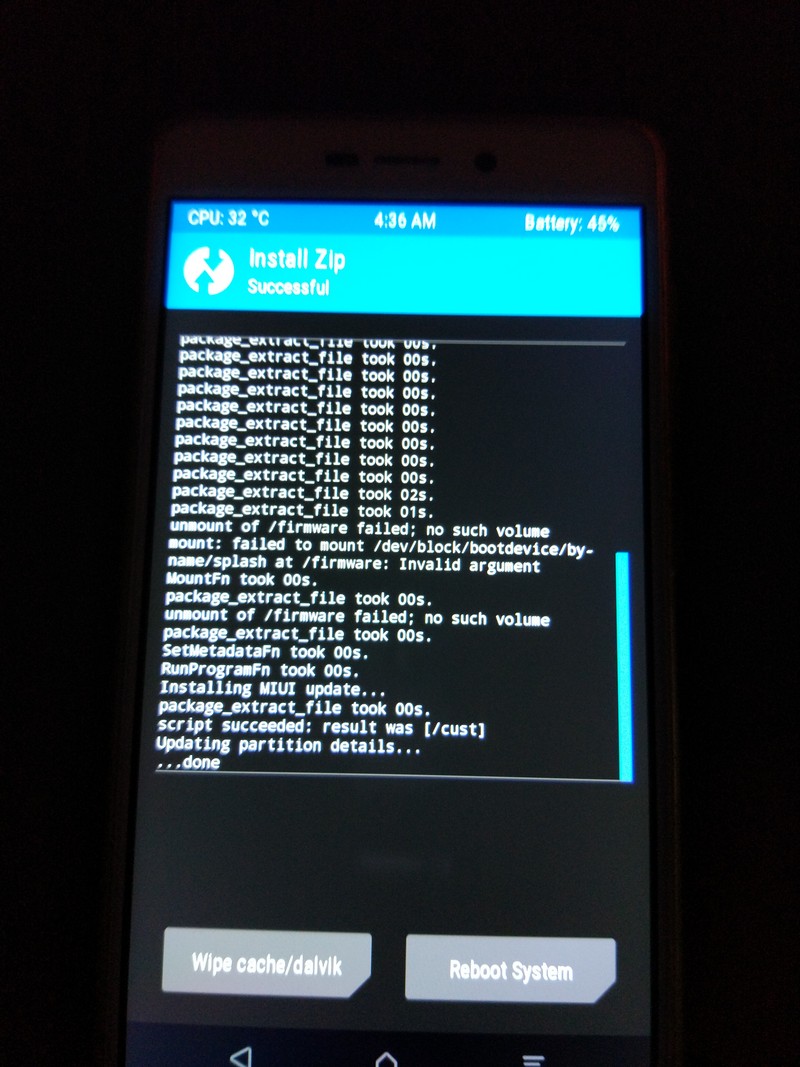

Since 8.1.1.0 each time when I flash in TWRP I get an error
mount: failed to mount /dev/block/bootdevice/by-name/splash at /firmware: Invalid argument
Flashing is successful and everything seems to work fine, so I don't know if it really is an error.

#12
I too noticed this error when flashing 8.1.2.0 (probably was there on 8.1.1.0 too, just didn't notice). I unlocked my bootloader personally, using the official method (authorized MI account and MiFlashUnlock tool).

Nov 12, 2016
2
#17
Got the same problem since I remember and still no answers. I use xiaomi.eu dev roms. Bootloader unlocked officially.

#20
I don't know if it's really a problem or rather a strange quirk, because it doesn't seem to have any negative effect... ROM installs and works just fine. Nevertheless, it's a bit unsettling to see an error in the flashing process...
