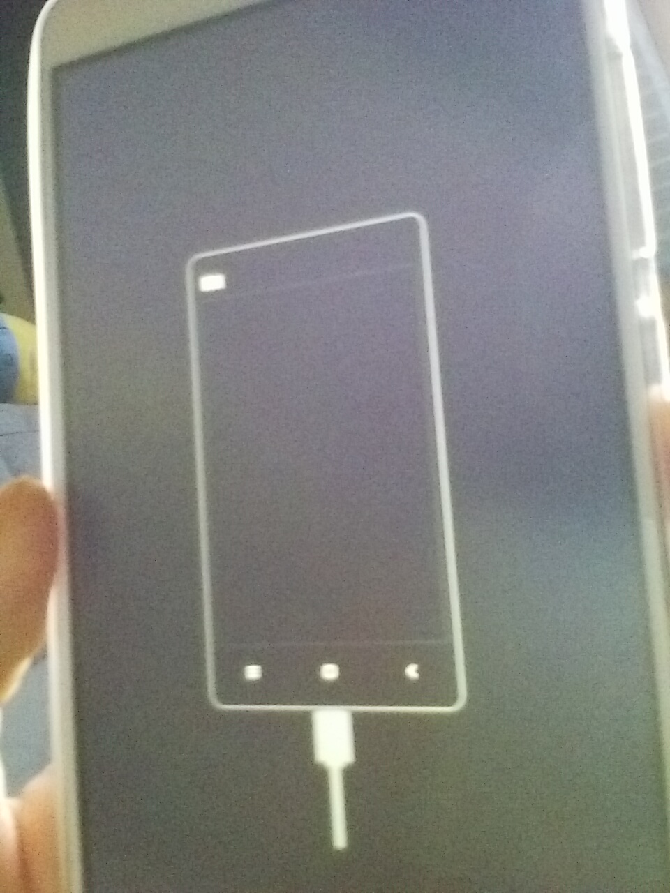

i dont understand i do all perfect the program show to me all ok but i still continue to have stock recovery!!! why???
Flash the recovery img then run: fastboot reboot
NOTE: hold the VOL UP key on the phone with the USB cable still connected when you enter the fastboot reboot command. When you see the MI logo on boot, release the VOL UP key. Wait another few seconds and it will boot into TWRP.
This is what I see when I try to enter in recovery when I finish the process

i have solved my problem. It's NECESSARY install super su app and update binaries first to flash recovery or it will not work

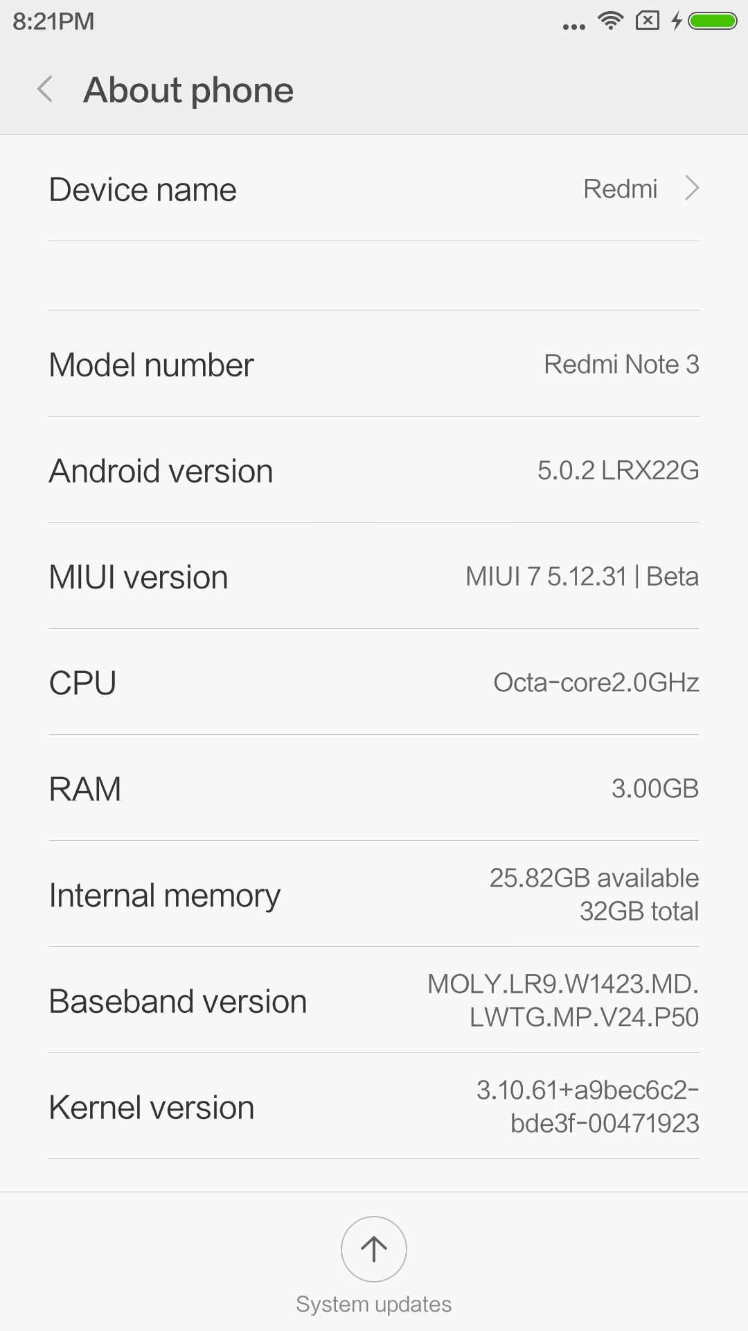

Hoa good happy new year, I'm following your instructions to install Developer Rom but I get the following error can't verify update. verify couldn't update, please try others.
Could I say I do wrong ?, because I downloaded the rom from your link, thank you very much

I put rom development but can not not let me not tendo driver preloader to note 3 or to Fastboot whether any attempt I make is useless to me, please appreciate some help because I'm lost and not to do, the rom I have is the 7.00.11.00 (LHNCNCJ) any suggestions? Thanks and happy 2016
