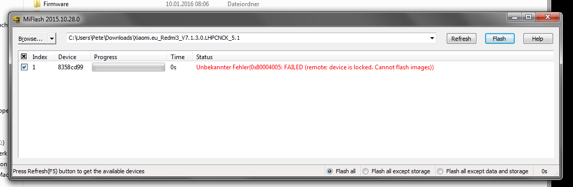

ok, because the tutorial at http://en.miui.com/thread-218644-1-1.html talks about special Qualcomm Drivers, which I already installed, and they say, you have to go into recovery, than into download mode and install it than. The tutorial here talks about Fastboot Mode and flash it through MiFlash and I tried this at first and got all the time the message, that Bootloader is locked. After that I tried it in Download Mode and with the Qualcomm Driver and it flashed, without the message of Bootloader locked, but after 59 minutes of flashing, I have removed the USB and now the phone is bricked. Can't get into download mode, only into Fastboot and there I got always the problem with the locked Bootloader message.

Did you enter download mode via stock recovery?
Vol+ and power then select download
Sent from my Redmi 3 using Tapatalk
Yes there was description that to power + volume up, after MI logo comes up just press 10 and more times on volume up and a screen appears with a lot of Chinese and there is a button for download mode or fastboot mode and other stuff. And yes it was stock and original the Redmi 3, bought through Xiaomi.
Gesendet von meinem PLK-AL10 mit Tapatalk

thanks, but this is the problem, I don't see the menu with all the chinese symbols anymore, I can't get into download mode again. When I know press the button 10 and more times, nothing happens, Mi Logo stocks and reboots.
ok got it, got even into download mode, but than you have to change at the top the descritption from
Just MiFlash it in the fastboot mode. Set the images folder you extracted.
in
Just MiFlash it in the download mode. Set the images folder you extracted.
because I think in fastboot you will get always the error of bootloader is locked.
You don't flash in fastboot mode, but you have to flash in download mode.
Follow this guide to get download mode and after flash a rom with miflash (only 64bit system)
