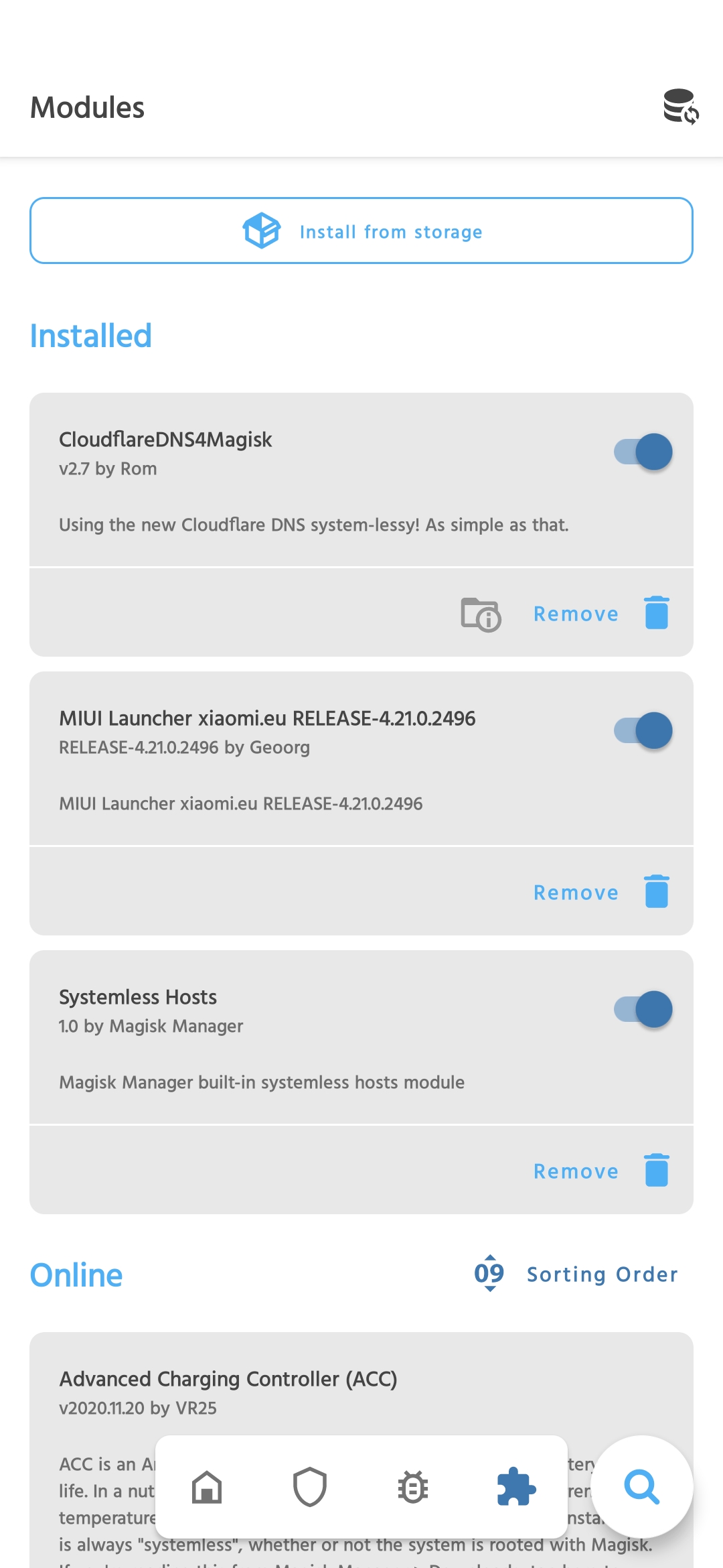

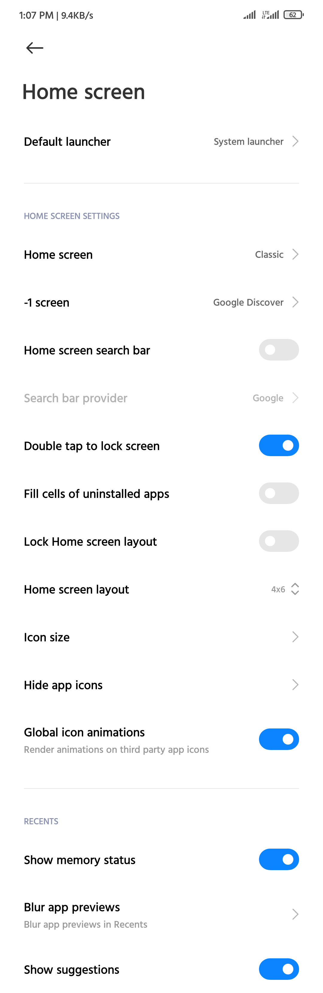

But I have followed your instructions but somehow it didn't work. I don't know if I'm not doing it right or something. I installed the magisk module, still nothing is happeningView attachment 32949View attachment 32950View attachment 32951
E shock me oo, coz you do am well.

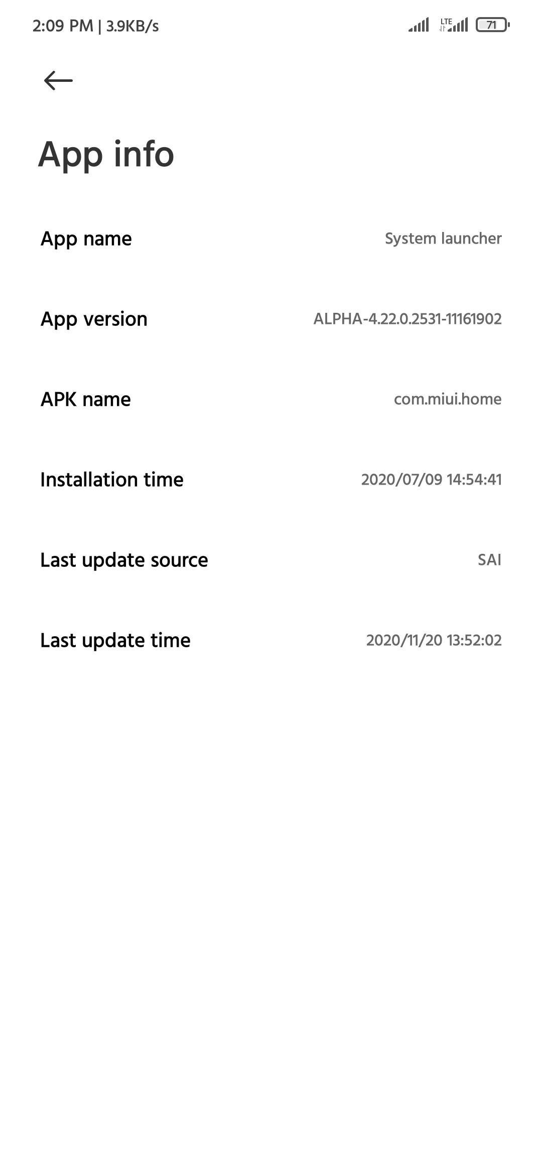

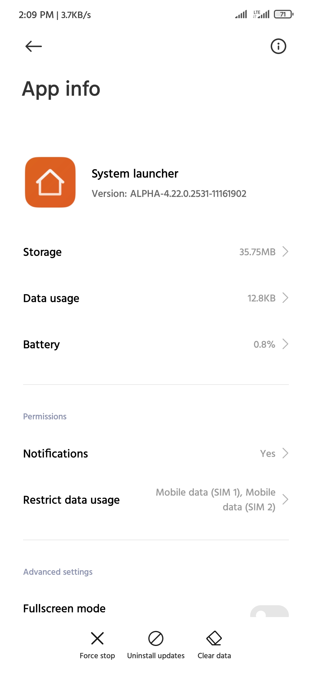

Which device and os version do you use and also show me the version of the launcher
Settings->apps->manage apps
Search for "system launcher" and tap on it
Omo I don even do another thing. I find latest Launcher and side install am with SAI. Yet no show.
Na Redmi Note 8 Android 10
Na Redmi Note 8 Android 10View attachment 32952View attachment 32953

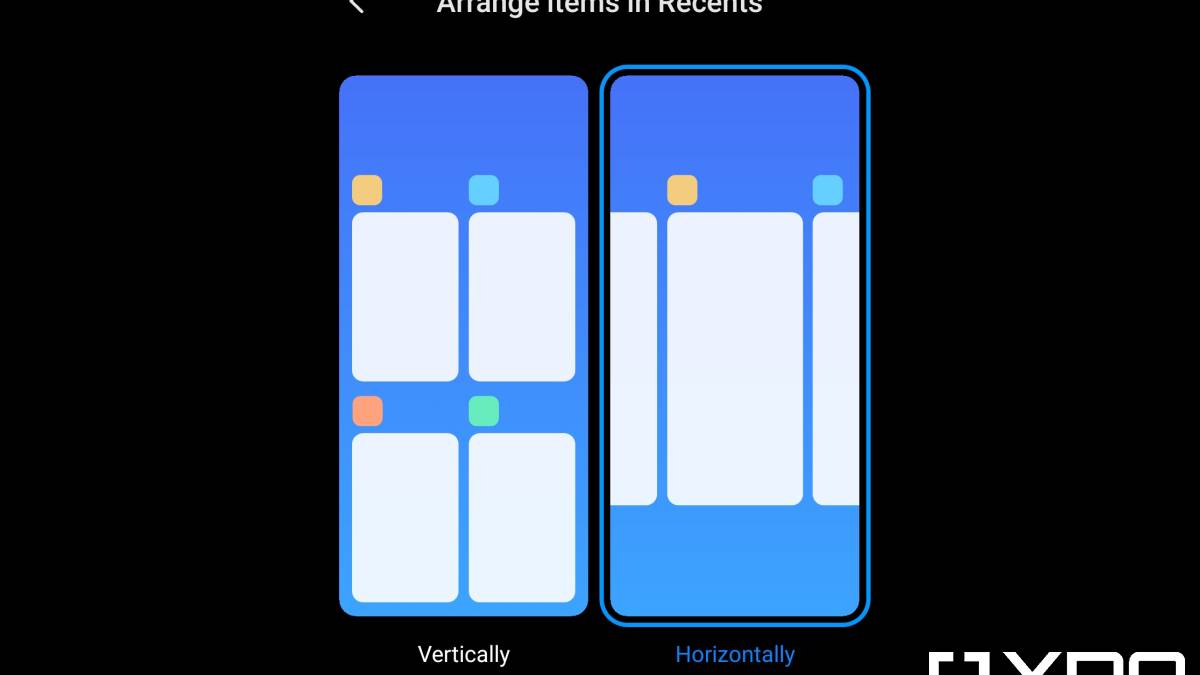

Found this while searching about the issue
The last sentence reads:
"While you can sideload the APK on your Xiaomi MIUI 12 device to get the feature toggle surfaced, note that it may not actually work. If everything goes well, you can expect to see the feature reach your device on a stable MIUI 12 update."
Maybe that explains why you can't see it

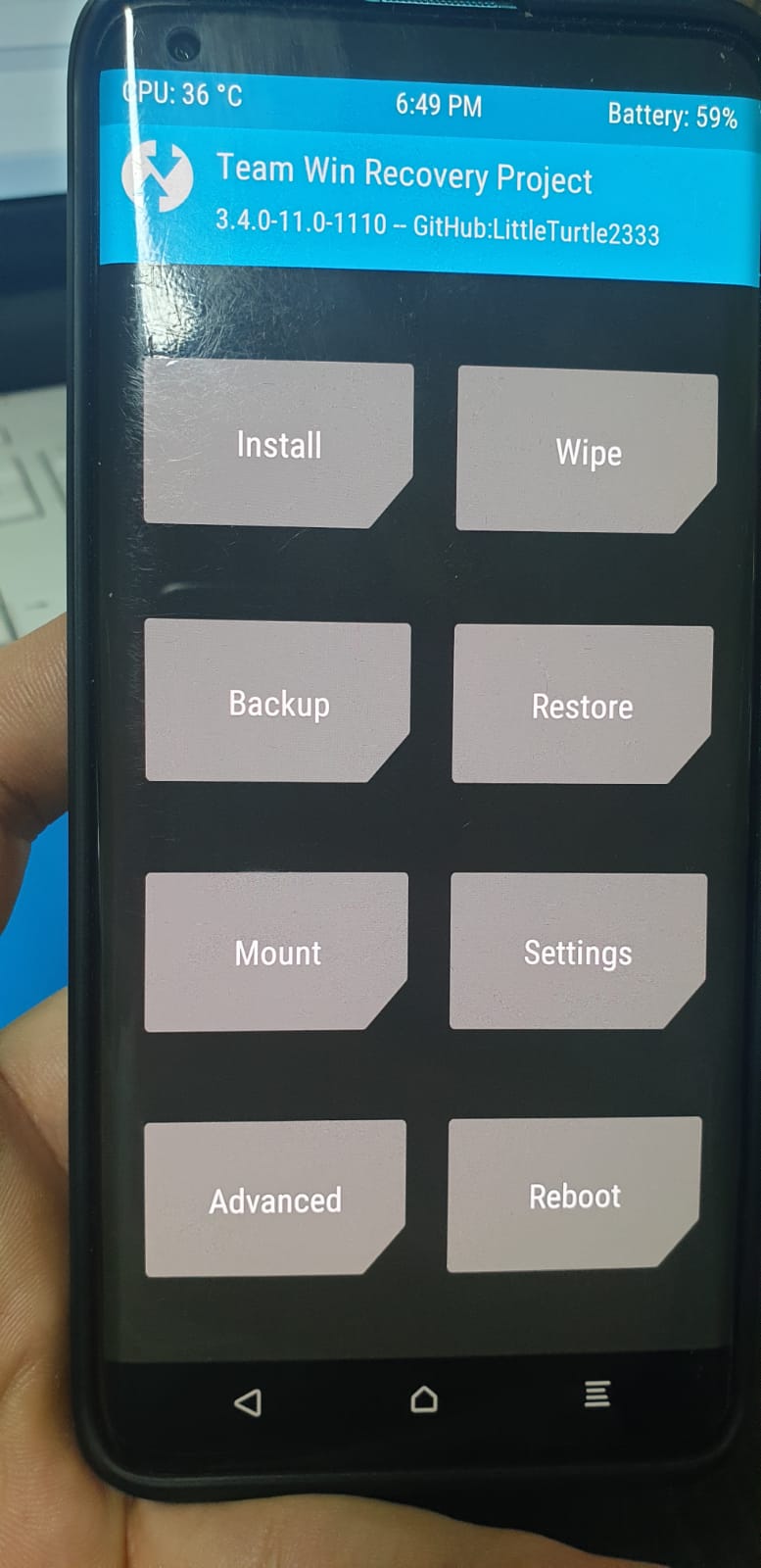

You are currently using the recommended version of TWRP, that was included in last week's ROM.
The way I am going to explain is really for advanced users, and involves passing files from your PC to your phone. This is the way that I do it for myself, and I know that it works for me and with my Mi 10 (umi).
You need to have adb and fastboot drivers installed. If you do not, here is where you can find out about it, and get the necessary files.
The version of TWRP that I have been using is 3.4.2b-0623, which you can get from here, and put it in the same folder where fastboot is installed.
You need to have the version of ROM that you are going to install, already on your phone.
Boot your phone into Fastboot, and connect it to your PC.
Open a DOS command box from that folder and issue the command: fastboot boot TWRP_umi.img
Your phone will eventually boot into this version of TWRP, where you will eventually be able to put in your pattern in order to decrypt.
Install the ROM. Wipe Dalvik and Cache, and delete the (root)/data/system/packet_cache folder.
Reboot back into the system. Sometimes it helps to reboot a second time.
Providing there are no real pre-existing problems, that should install the ROM correctly.
That explains it. Thanks man

Download this twrp .. https://androidfilehost.com/?fid=8889791610682877442
Put file img in adb folder , enter fastboot and connect usb ..
Open a cmd and type ..
fastboot boot twrp_umi.img ( wait over a second until twrp loads , don't worry about blackscreen , just wait )
Do not type nothing else , not flash not anything just this , it needs almost 70 seconds to load the twrp ..
Install rom again and wipe cache and dalvik when installation finish ..
If you don't mind could you refer me to the particular latest launcher you flashed so I can try it with my RN8. The one I just flashed doesn't seem to work. Thanks
I already told you again and again that the new Recents and FSG are disabled for Redmi Note 8, both in framework and the launcher. It doesn't matter how many launchers you try to flash, it won't work unless all device checks are manually patched...
Sent from my Redmi Note 8 using Tapatalk
No, that doesn't. And it won't just appear on a Stable update for no reason, Xiaomi disabled it on purpose, there are explicit checks for low-RAM devices.

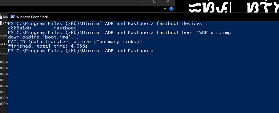

hi sir. i cant boot twrp 3.4.2b-0623. whats the meaning of this.?
