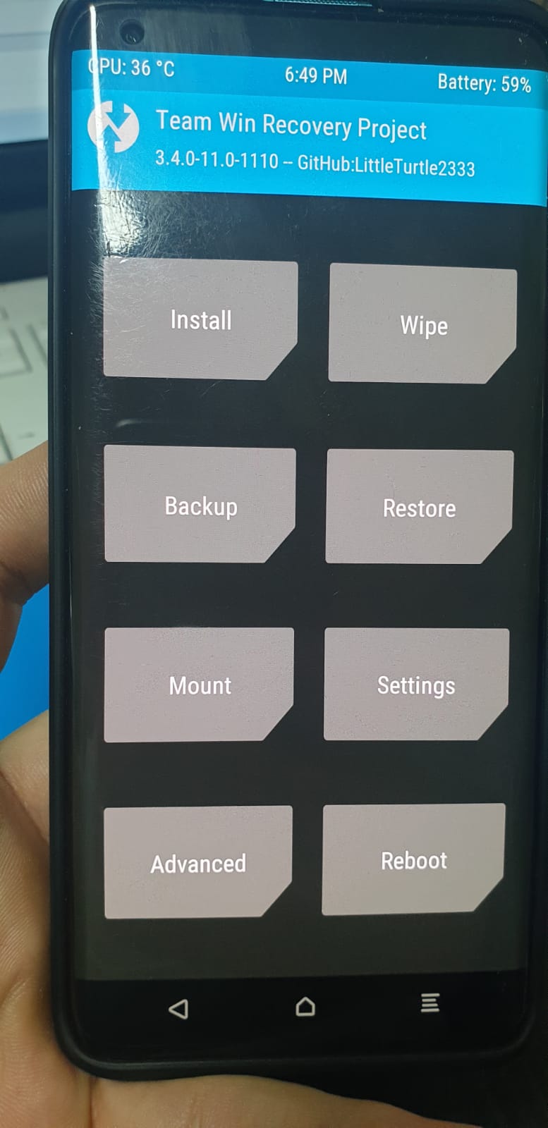

Which version of TWRP are you trying to flash?
If you look at some of my earlier posts, you will see that I can successfully boot into 3.4.2b-0623 TWRP, and use that successfully.

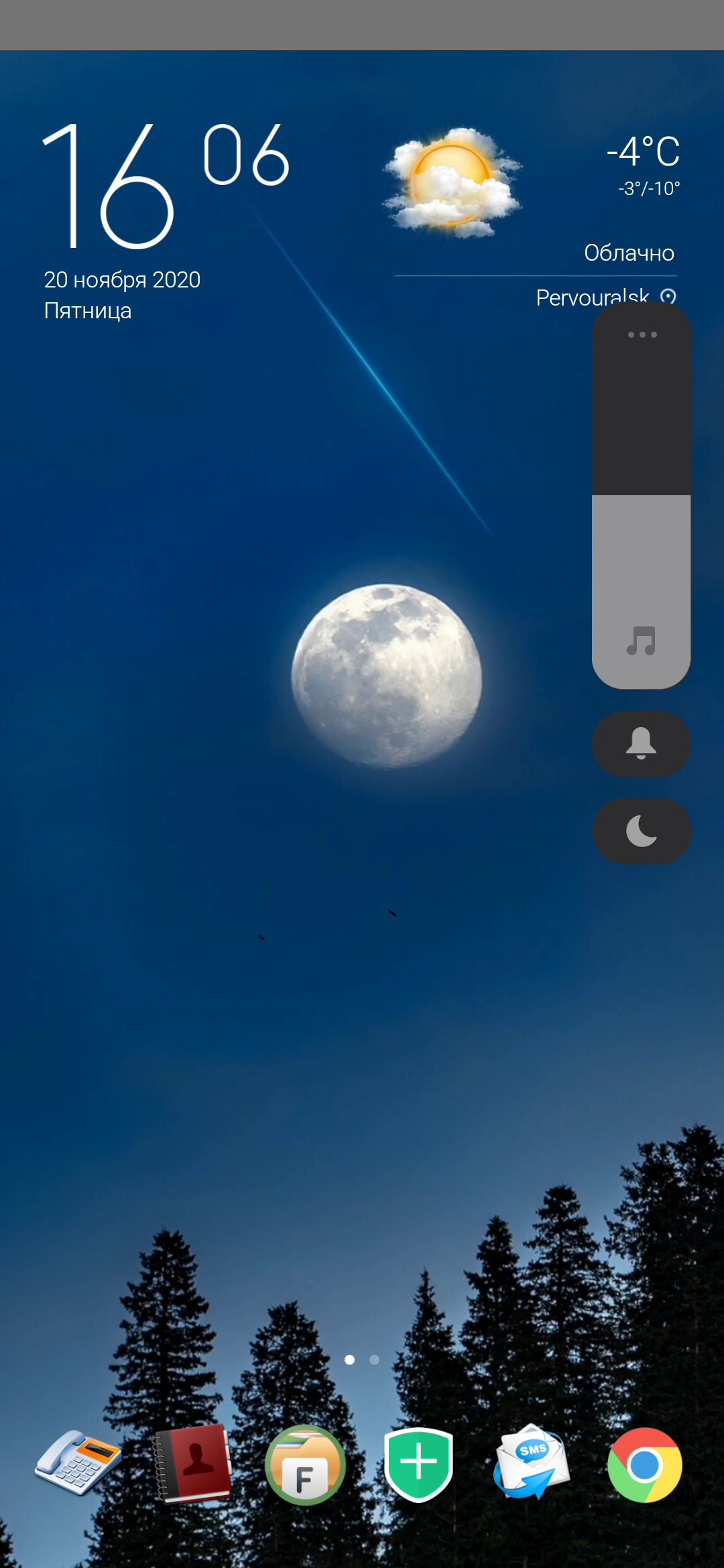

When adjusting the volume in the new design, a gray color appears in the shutter, like the control dial itself. MI 9 LITE
It is in dark mode, everything is fine in light mode

The gray bar disappears after switching the dark theme mode, but after the screen is locked it reappears

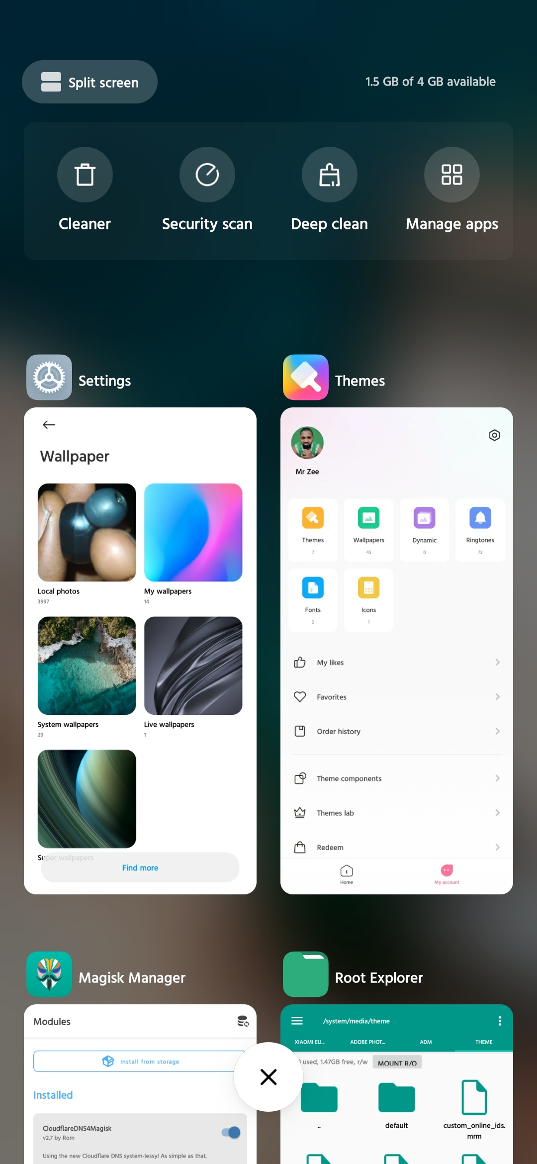

No, new recents thing is not supported because RN8 will not get android 11 which is essential for this feature.
What does Android version has to do with a launcher feature? I flashed the latest launcher on Mi 8 (Weekly 20.9.4 Android 10), and the new Recents (including Horizontal and Vertical layouts) works perfectly, along with the new full-screen gestures. So please, if you don't know what you're talking about, better keep it shut and don't spread misinformation, and definitely don't try to argue with me.

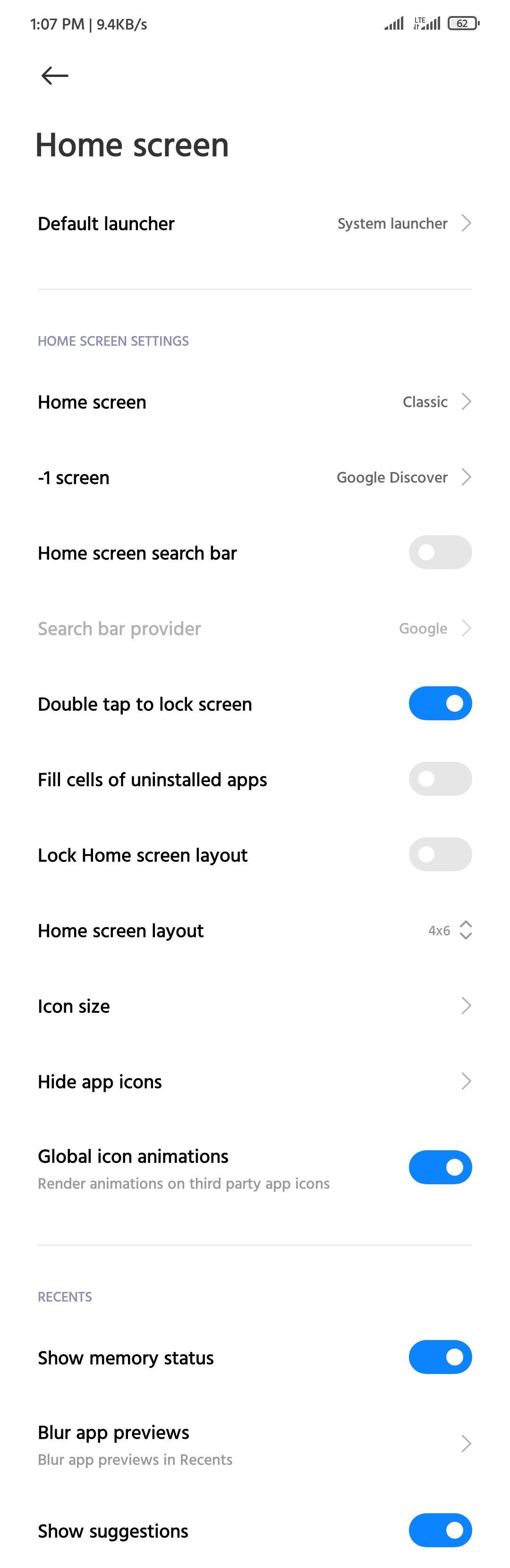

the full screen gestures aren't working. Can someone please advise if i'm doing anything wrong? i'm on K20pro.
Use the default launcher...

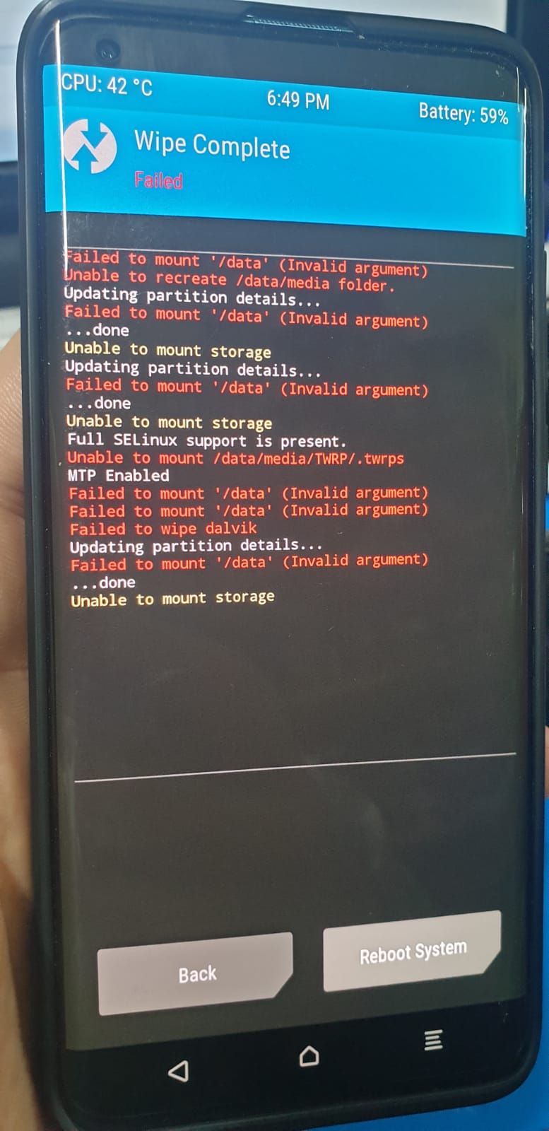

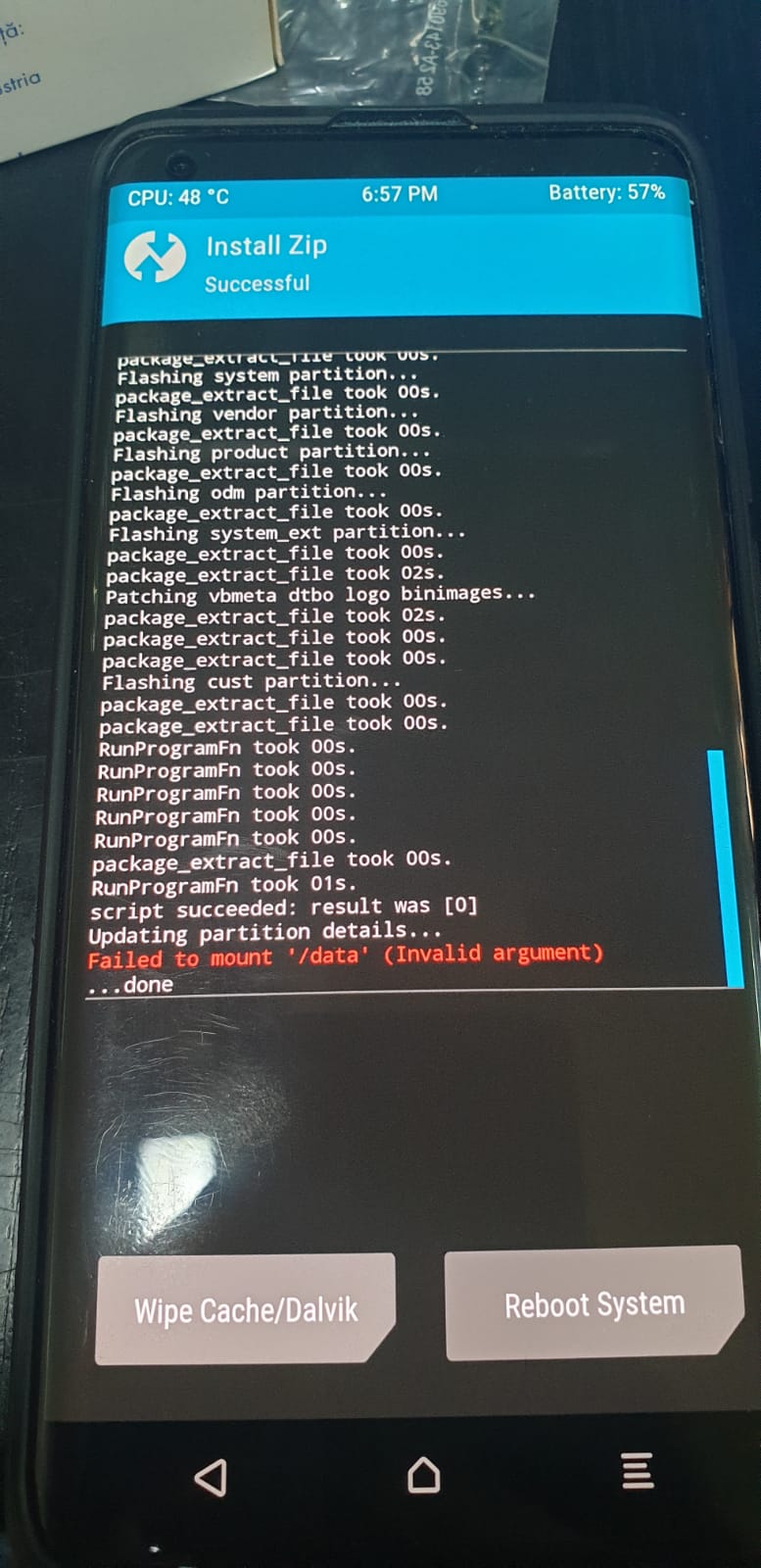

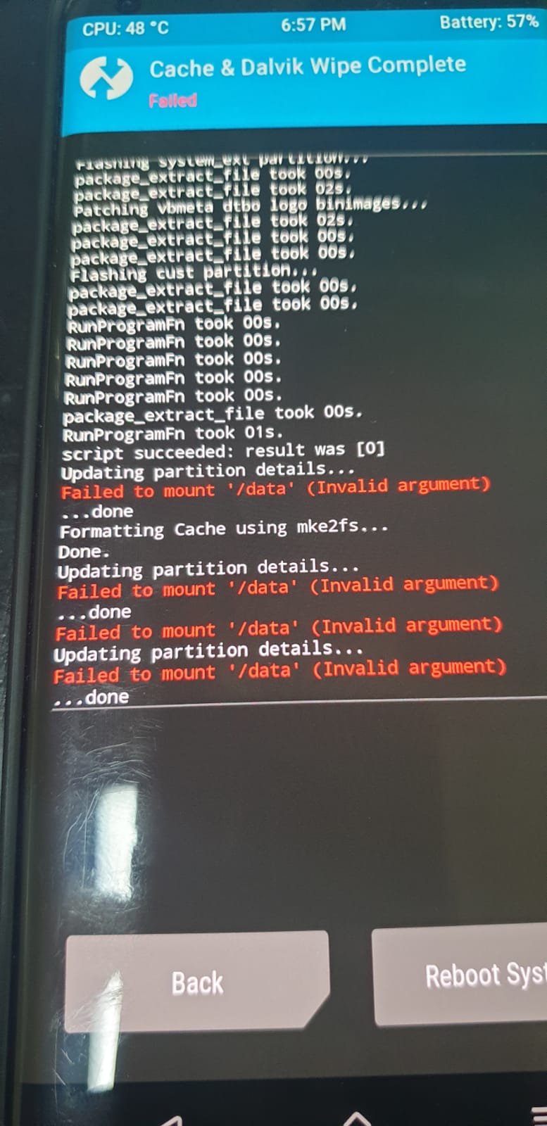

Hello. I have a problem for mi 10 umi
I was able to install both the new twrp and the new system. But since then, a few applications are closing gallery, map, xiaomi wear...
Dalvik and cache wipe failed, I attached the picture.

I believe it. Soon also Xiaomi MI 9T Pro will receive Android 11 as MI 9T brother
Thank you for the new update :)
If you don't mind could you refer me to the particular latest launcher you flashed so I can try it with my RN8. The one I just flashed doesn't seem to work. Thanks
New volume control works great on RN8 20.11.18. both day mode and dark mode. No issues

This is for the Mi 10 (umi)
In case you do not have the 3.4.2b-0623 version of TWRP, it is here - TWRP_umi.img.
You would go into Fastboot and issue the command: fastboot boot TWRP_umi.img .
You should then be able, after putting in your pattern to decrypt, to install the ROM.
The reason for all of the errors when trying to clear the Dalvik/cache is because your system is not decrypted. You are using the safe and 'new' TWRP which does not decrypt. If you have not already done so, try a reboot. See how it goes.
