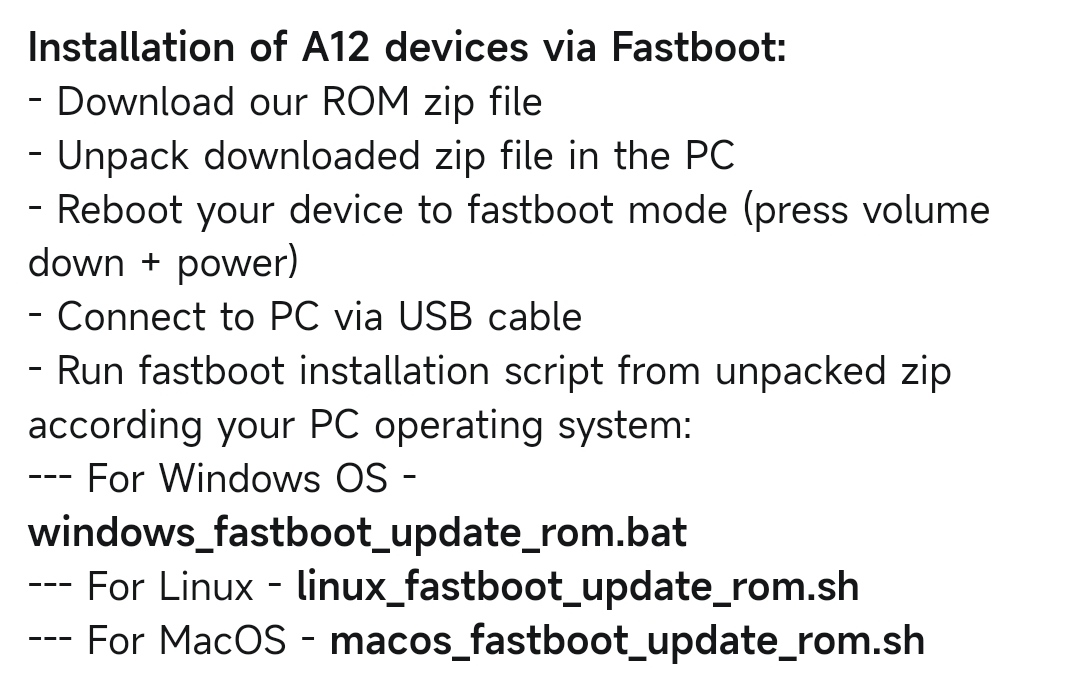

Would it be possible to include "Android Factory Reset is recommended to fix storage issues after windows_fastboot_first_install_with_data_format.bat" on the first post under fastboot installation instructions?
Having loads of issues including Telegram, WhatsApp, Android Auto... A number of other people are having similar issues.
and other people dont have any issues… so why reset device by default?
regardless of the fact that certain prerequisites must be met…
Because if you do a CLEAN install, it takes 30sec to fix majority of the issues by doing factory reset and absolutely does not hurt anyone since you already formatted data.
Otherwise people come here and post questions/complaints and everyone tells them to do a factory reset anyway... Forcing them to reconfigure their phone for a second time.
In your own post history on the newest 5 pages of your posts, there is atleast one recommendation about factory reset. You made a brilliant post about fastboot in which you posted the solution. Having the same info on first post as a recommended optional step for people coming from A11 with clean install would be briliant.
Specifically talking about the fastboot_first_install_with_data_format.bat scripts only and not upgrade flashes.

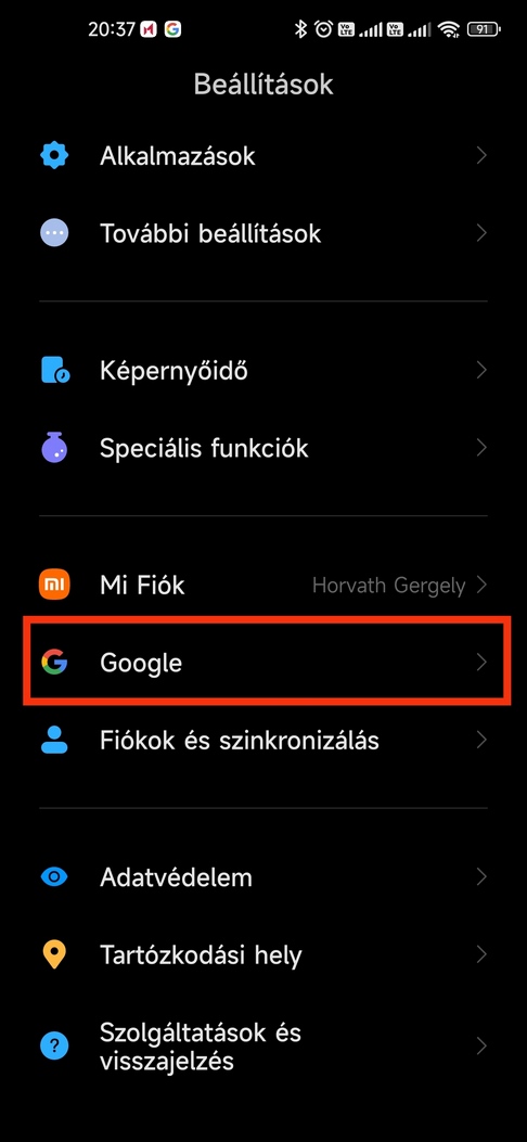

It can not be opened. I can not enter. Settings ... Google... What could be the problem? Mi10 (UMI)
Anyway, it's a very cool job! Thanks to the developers!
