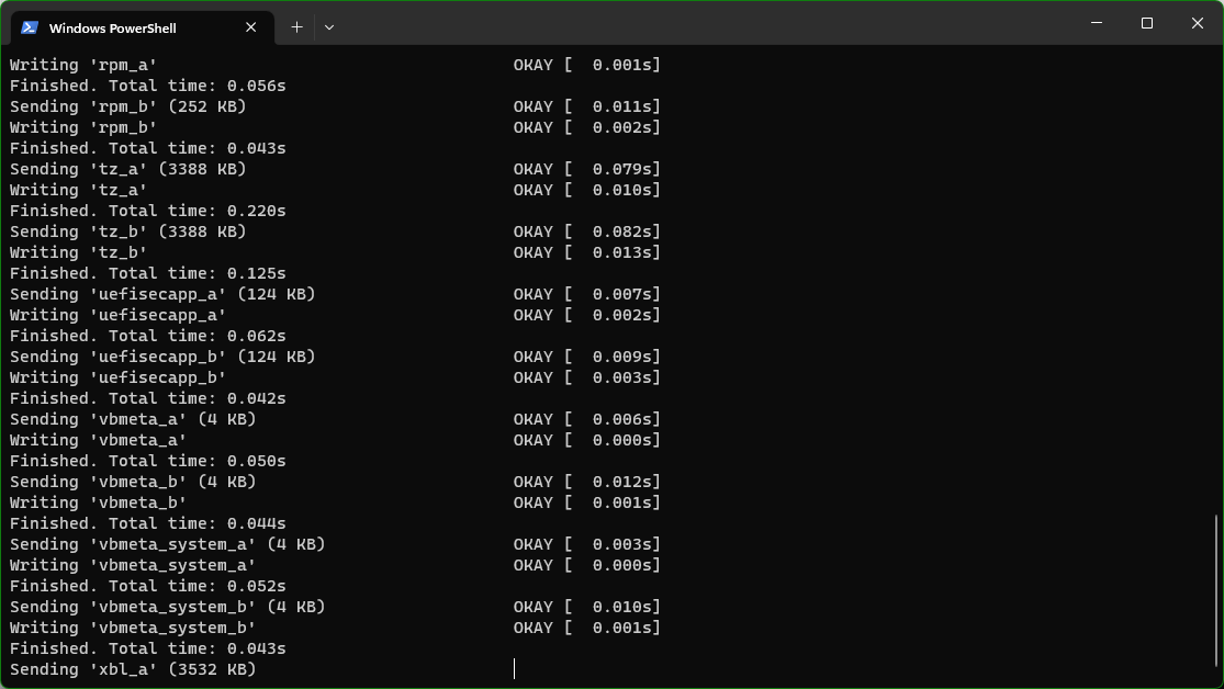

Hello, I'm trying to update my Poco X4 Global with the latest xiaomi.eu_multi_VEUXG_V13.0.7.0.SKCMIXM_v13-12.zip, but it seems stuck at the step
"Sending 'xbl_a' (3532 KB)" for over half an hour.

EDIT: Somehow my device stopped being recognized by fastboot mid update. Trying it now on a Linux machine.
Sounds like an unstable USB connection.
