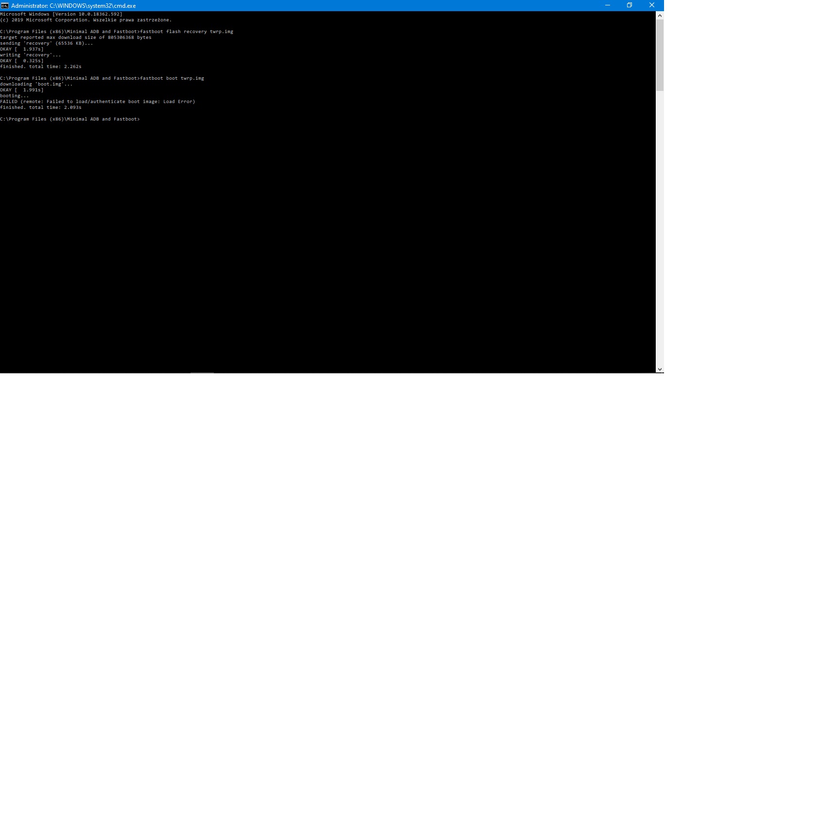

I can't enter twrp at all. I tried to install twrp via adb and twrp installs but in no way can I get to it

recovery flashing and showing that a Fastboot restart entry is available and I hold the volume up button but are still not available in twrp.

Here is what you should do:
1. Type "fastboot flash recovery twrp.img" without the quotes
2. Press enter and wait for the success message
3. Press and hold Vol Up + Power button until phone reboots
4. When MIUI logo appears, release the Power button but keep pressing the Vol Up button
Do not reboot to TWRP using the command line.

I tried it. will not enter twrp now it hangs on the logo unlocked me but luckily you can enter fastboot mode so i will try to throw rom through me flash
Fastboot boot ----- the lines are the name of your twrp
Or fastboot Boot recovery----- the name of twrp
Or fastboot reboot recovery------name
I finally succeeded but only when I installed the first recovery I had installed after unlocking the bootloader.
