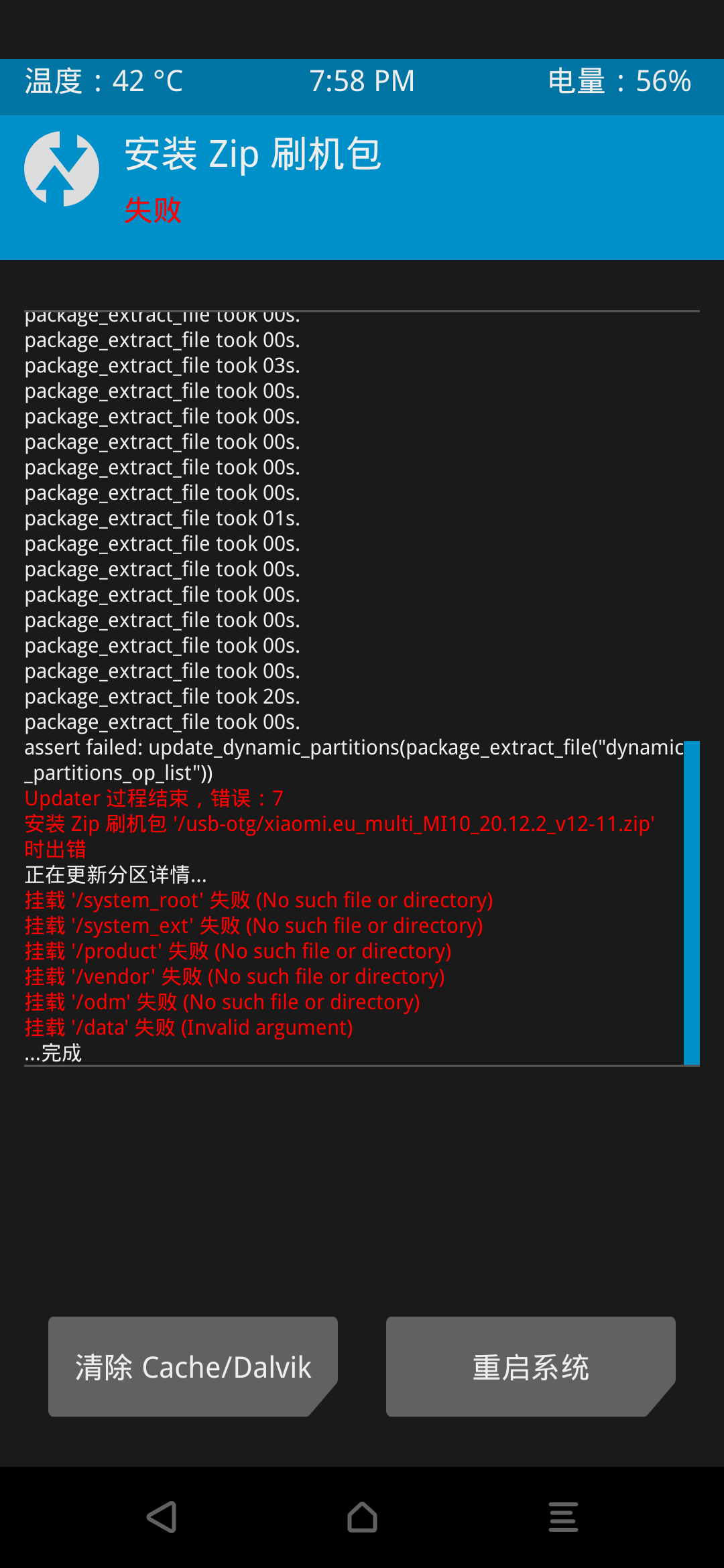

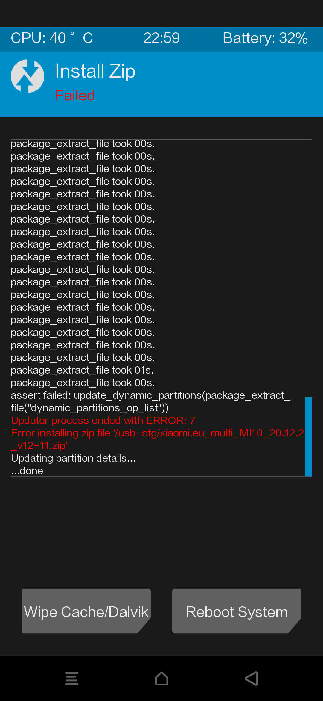

what is the correct TWRP for Mi 10. Now i tried several TWRP, nothing is working. After MiFlash and then installing TWRP and installing via OTG or not OTG my device is always going to TWRP. what can be the issue??????
for me the same.... installed @ the newer chinese recovery (that was mentioned a few versions before) i got error 7 an serveral warnings about no permissions to write on the drives /
im not able to install anything, or change anything / installing with otg stick not possible // changing the recovery to an older version not possible -> vol up + power goes everytime to fastboot. now using xiaomitool v2 and i was able to install twrp 3.4.2b and got write permission ... lets see if it works in a few minutes

Wipe Data = some errors = no write permission = Old rom stays in place /
Flashing with both recoverys = error 7 ....

I dont know any further... flashing the 20.11.18 firmware works without any problems. 20.12.02 gives me error 7 every time. tried with 3 different recoverys / wipe / without wipe / reboot / flashing & booting the recovery // i downloaded the rom from 4 different mirrors....
i stay now locked in 20.11.18.... waiting for the next rom or a new twrp? idk 5 hours of no success are enought now
