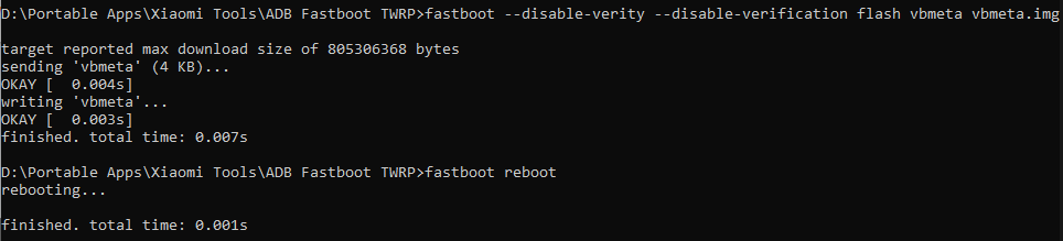

Guys, I messed up and need some help. I used the reboot to recovery option in top menu in settings and now my device is stuck in fastboot.
Things I tried:
- adb reboot (from adb) - didn't work
- flashing the recovery I used before again - didn't work
I'm stuck in fastboot, what do I do?
MI9SE (Grus)

Use fastboot to flash a recovery like twrp3.4 also. Then try reboot recovery.
Then uninstall magisk and try boot.
If not boot.
Go back to fastboot and flash vbmeta again.
Use the vbmeta I shared in my post.
It will work.

UPDATE (for anyone that has the same issue).
Flashed this twrp instead and it's working again!
@Poney70 / @PPM-Droid since I flashed vbmeta beforehand, will it affect my system in any way now or in future update?
What I found in MI forum:
This device uses Android Verified Boot (AVB)
This means that installing TWRP or swiping to allow system modifications will prevent you from being able to boot. To bypass AVB's boot prevention, you will have to disable it or install a custom ROM that ships with disabled AVB.
To disable AVB via fastboot, grab the vbmeta image from the ROM you are on, and flash it with the following command:
fastboot --disable-verity --disable-verification flash vbmeta vbmeta.img
AVB should be now disabled on your device.
I think the verification should be disable here. Maybe this comand it's missing in the last update?
