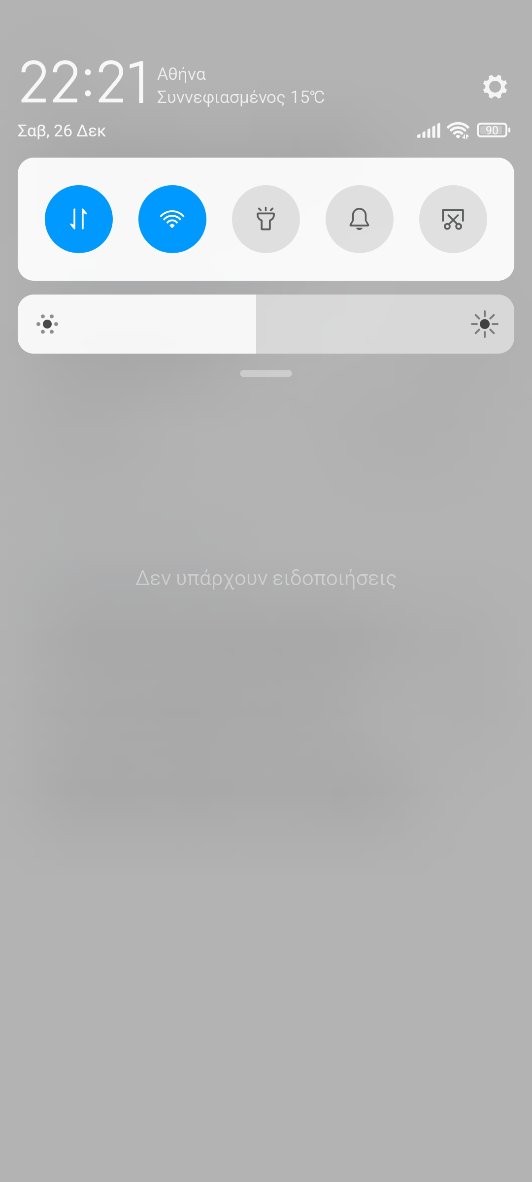

How do you get rid of data usage on the Quick Access bar? I've pressd the ? icon and there is no options to turn it off.
I am on about the bar that you turn your Wi-Fi on/off, mobile data on/off and flashlight etc. The data usage is just under it.

It's weird that you can disable it , @geoorg told you exactly the steps ..
Take a look at screenshots ..

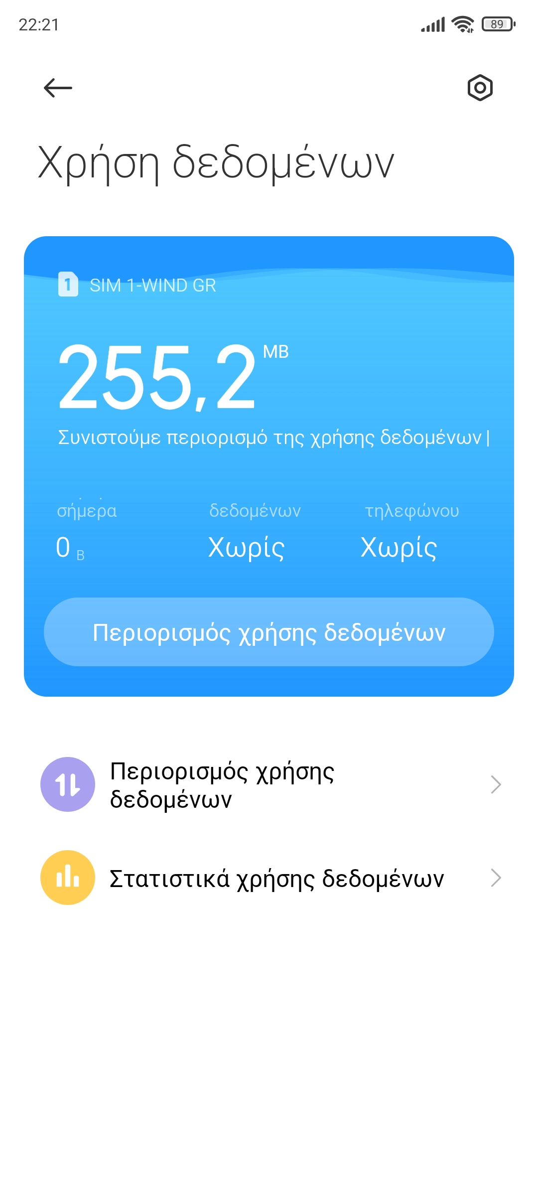

Screenshot_2020-12-26-22-20-47-442_com.android.settings.jpg .. tap on data usage line and will enter here ..
Screenshot_2020-12-26-22-21-44-337_com.miui.securitycenter.jpg .. now tap settings ( gear ) icon on top of the right corner ..

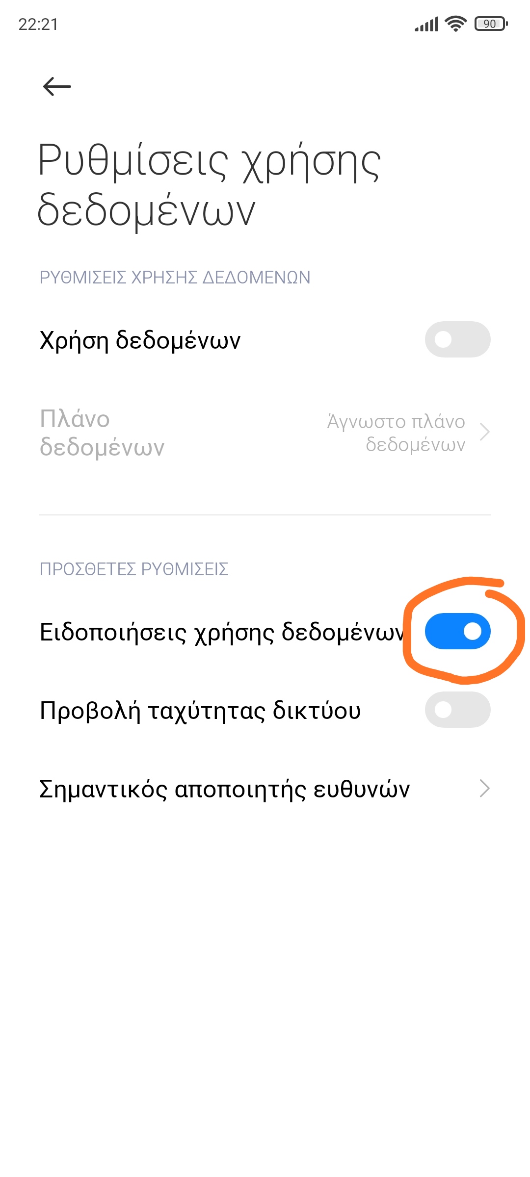

IMG_20201226_222806.jpg .. turn of this and it will become like that ..
Screenshot_2020-12-26-22-21-27-446_com.miui.securitycenter.jpg .. it's easy , i can't understand where you confused ..

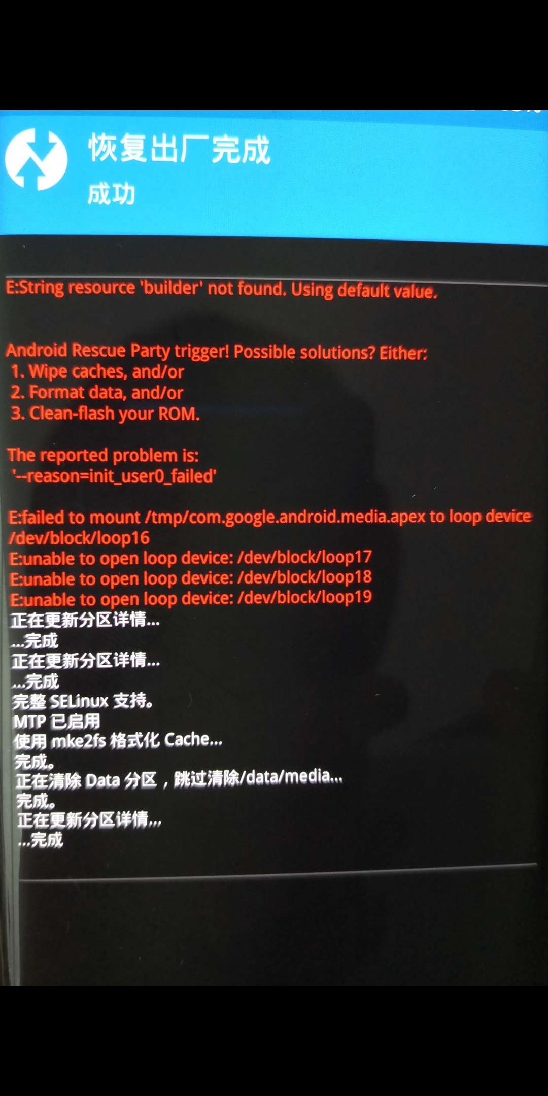

Please help as I'm incapable of solving this issue with TWRP not mounting and not letting me boot back to system: I noticed that TWRP didn't ask for password when I first booted into it. I didn't try going back to system and resetting the password, instead I switched mount mode to ext2 and back to extract and since then I have been unable to boot back to system. Now I'm just stuck here with wiping caches not doing anything. It does give me this error though, but I don't know what it means.
(Btw I have no idea why the interface is in Chinese. I can provided translation if needed for problemsolving but I've never set system language or twrp language to Chinese.)
My phone is Redmi K30i (Please note that "i" is 48m camera), version is xiaomi.eu v12.0.3.0
(Btw I have no idea why the interface is in Chinese. I can provided translation if needed for problemsolving but I've never set system language or twrp language to Chinese.)View attachment 33559View attachment 33560
Device is mi 10 or mi 10 pro , what exactly did you try to do ??
It's your first flash after unlocking bootloader ??
Did you saw anywhere to switch mount to ext2 ??

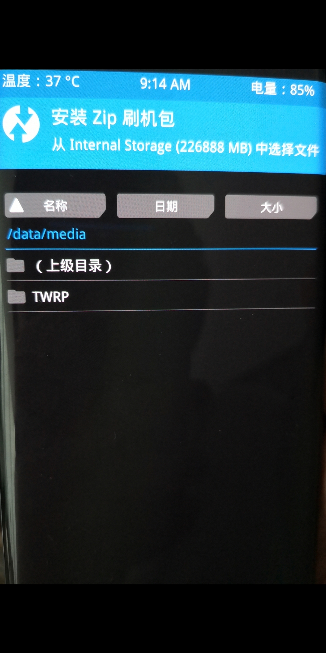

Device is cmi and ive now installed cmi TWRP1206 but still encrypted. I managed to MPT copy firmware into storage and hard install in TWRP but no luck rebooting to android still.
@oknametra @Darius LAD Do you have mi 10/mi 10 pro/mi 10 ultra?
If yes, then you should have probably read in the forum that you should boot in newer twrps (0206/1206) to do what you want to do (btw, I think this might be fixed on mi 10 pro). The one that comes with the rom (3.0.4) cant decrypt the data, so if you want it to work you'll probably havw to remove any password and such (I think it's said patterns are allowed).
Also, the newer twrps are unstable, so they ~mustn't be flashed (even though I accidentally did it..)., only be BOOTED. It may take a little while to boot into that, but ~just wait to get into twrp.
It's first flash after unlock or not ??
Did you try to update rom version ??
As i can see you need to perform a format data , so if you already install the rom you can do a format data and reboot to system..
Wipe/ format data / .. type yes and hit enter
Then reboot to system ..
You will loose everything in internal memory after this ..

On CMI it's not like UMI , twrp is working fine and decrypt data without issues ..
Friend just followed his own procedure to flash ..
