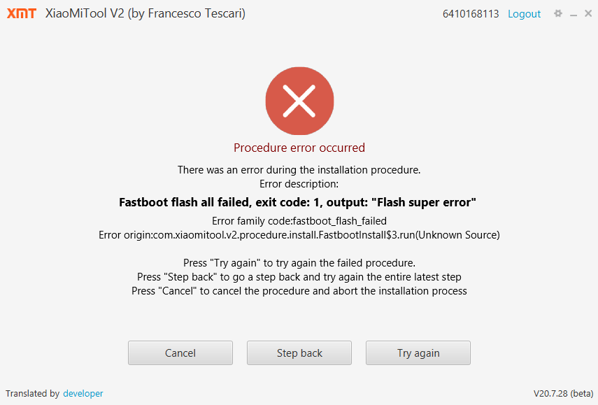

HI I have mi 11 with chinese rom and I installed the fglobalfast boot , but it didnt go through and stuck in Fastboot logo and can not do anything
I tried to install the original chinise rom with flashtool and it give me error
error is Antirollbackcheckerror and when I edit the .bat file text and then try it give me to cant $fastboot
please help me thanks
*UPDATE
I found a rom and it worked and did succes with flashtoll , BUT after finish it is same and stuck on fastboot Logo

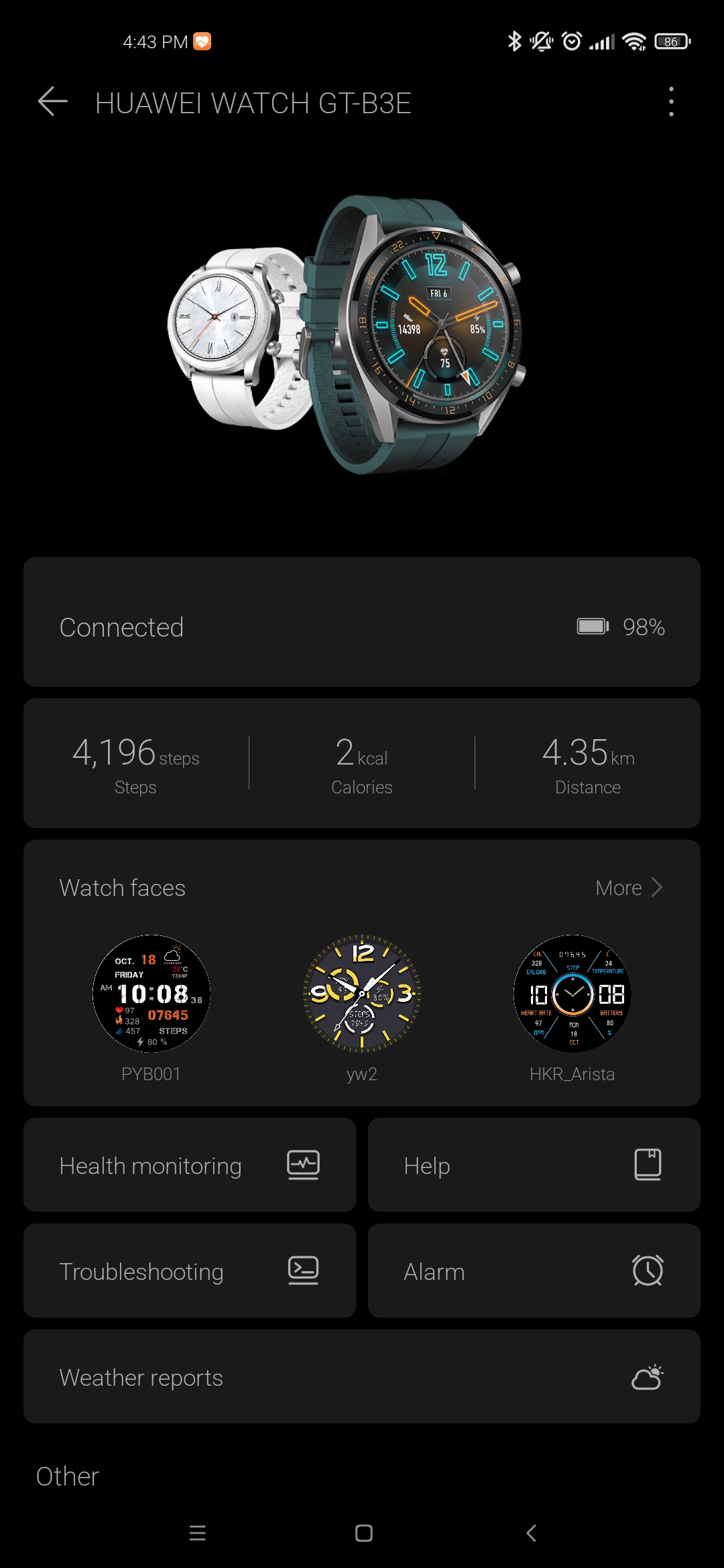

1. Can't connect to my watch GT through Health app. It Sees but can not connect.
2. The Google Maps app went crazy. I almost Crashed with my Car and got Charge. When I start in opposite direction The Gmaps sometimes go crazy and spinning.
Update Health app and HMS from apkmirror and give it a try. Also see if the watch is at the latest version.
Huawei watch GT? If so i have one and it pairs fine? Might not be a rom issue then.
I didnt need to download hms just health app from play store and it worked.
