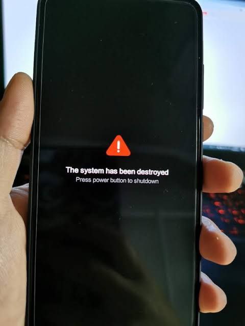

Mi 9T Pro/K20 Pro
Clean Flash; wiped everything except vendor and internal.
Recovery: Ofox v11.0.1 (latest)
System Is Destroyed.
Have to unlock bootloader using Mi Unlock Tool.
System was not encrypted.
Storage was not wiped in the process, even Ofox was not replaced.

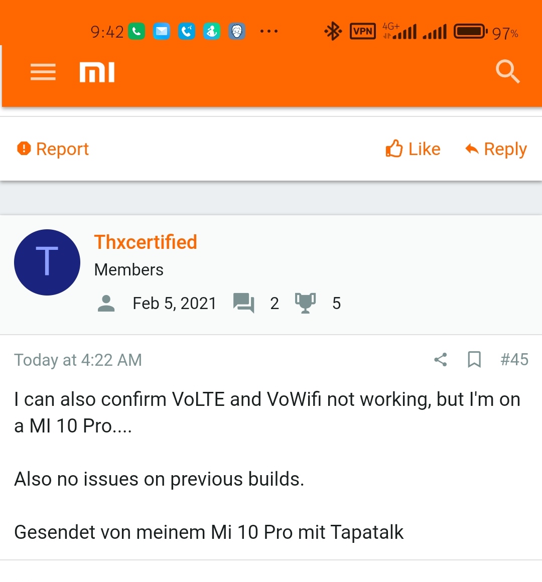

Notification toggles like wifi and bluetooth are working fine with just one touch?
Both VoLTE and VoWiFi are working great on my Mi10Pro.

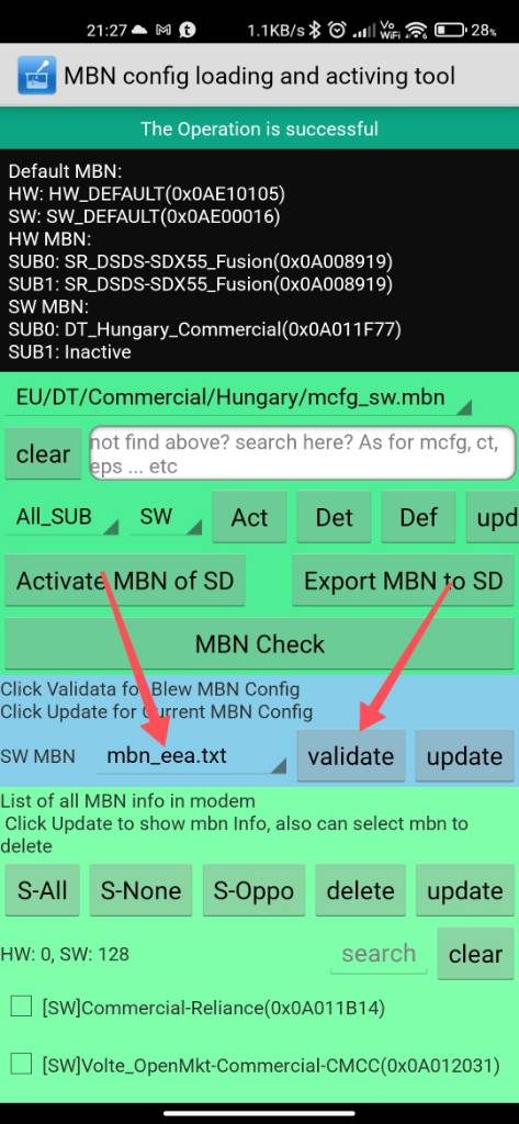

Open Modem test tools by using *#*#663368378#*#* code in dialer > Open MBN config loading and activing tool > select mbn_eea.txt for SW MBN > tap on validate > wait some secs for update.
See attached screenshot

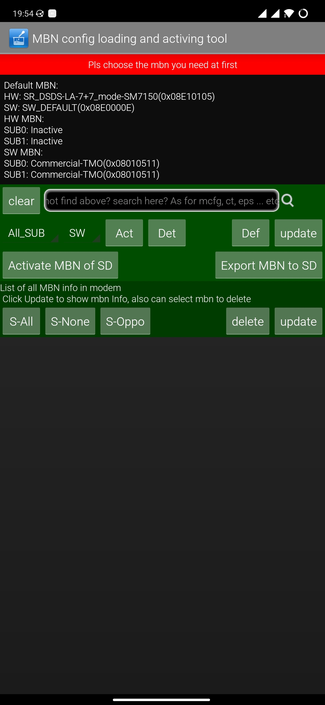

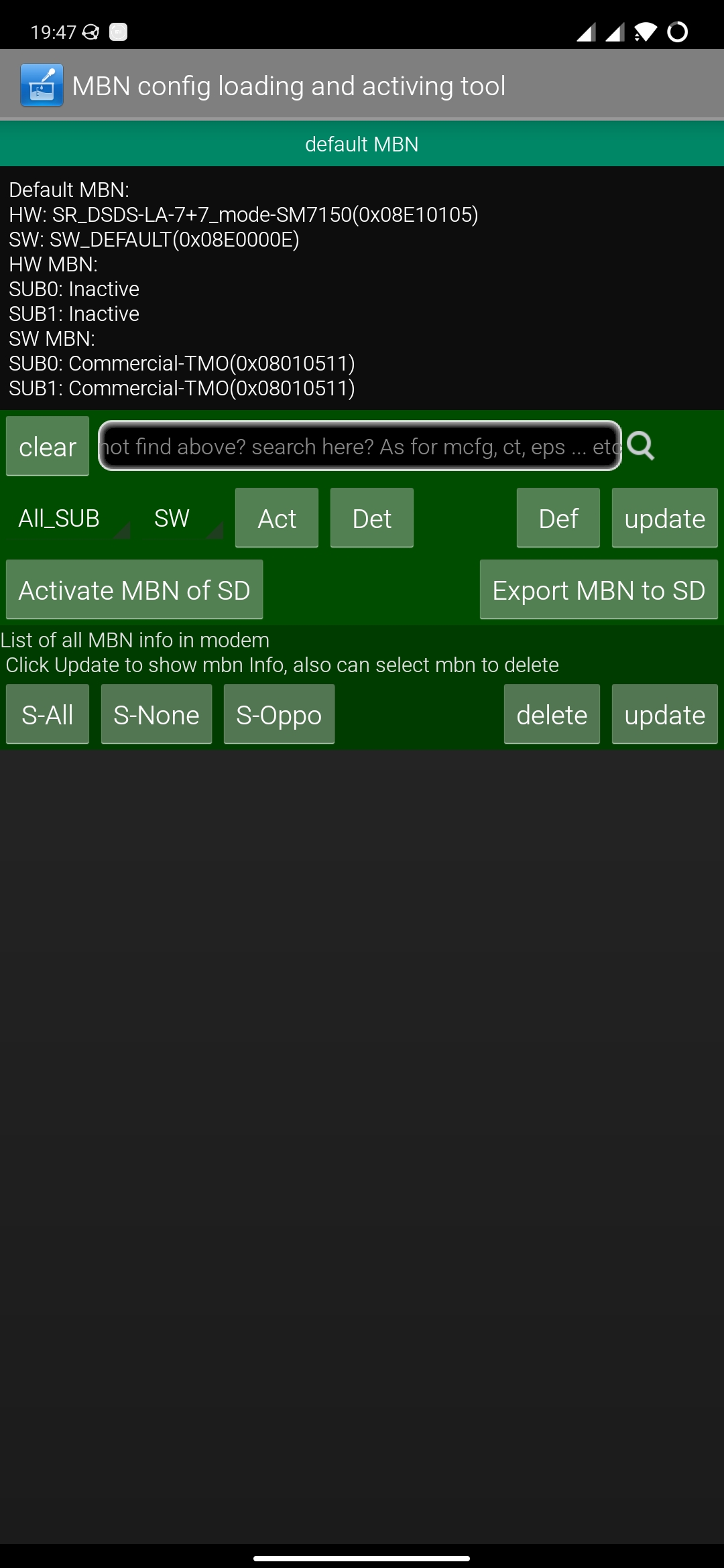

Unable to complete this fix on Mi Note 10 Pro as my menu is different:
34655
Picking export gives me the following error:
34656

Only Xiaomi's Snapdragon 865 devices have a mbn_eea.txt file (apollo, cas, cmi, lmi, umi).

K20 Pro system destroyed is happening more than randomly both on twrp and ofox (latest).
And in both scenarioes, dirty n clean.
Just needs to unlock bootloader n system boots to newly flashed Eu rom. No encryption or data wipes. Even custom recovery survives.
Thanx
