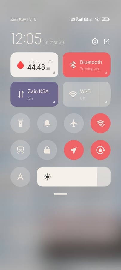

any way to solve this problem .. bluetooth not turning on even after format or istall a new rom
36339
any way to solve this problem .. bluetooth not turning on even after format or istall a new rom View attachment 36339
