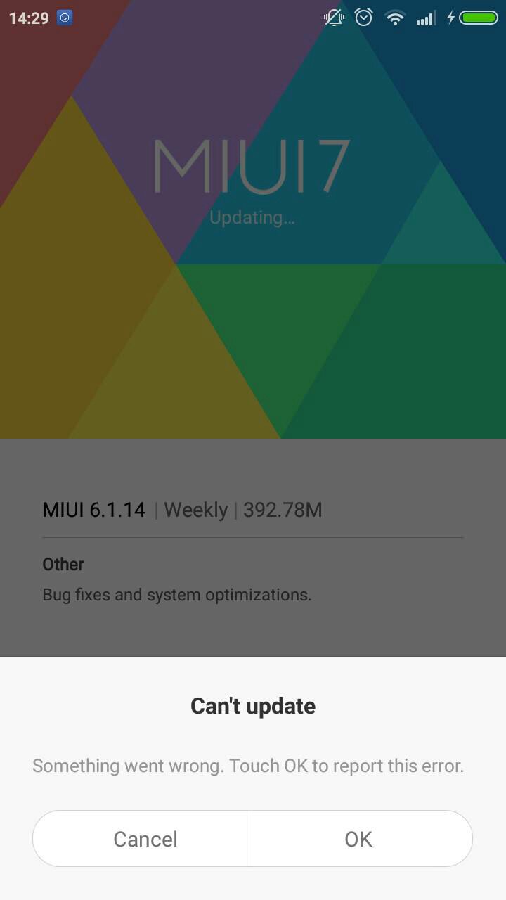

Trying to update to this release with downloaded aries rom through the updater. The updater progresses to 90% and then I get the following error which tells me nothing useful:
What could be going wrong here and how do I fix it?

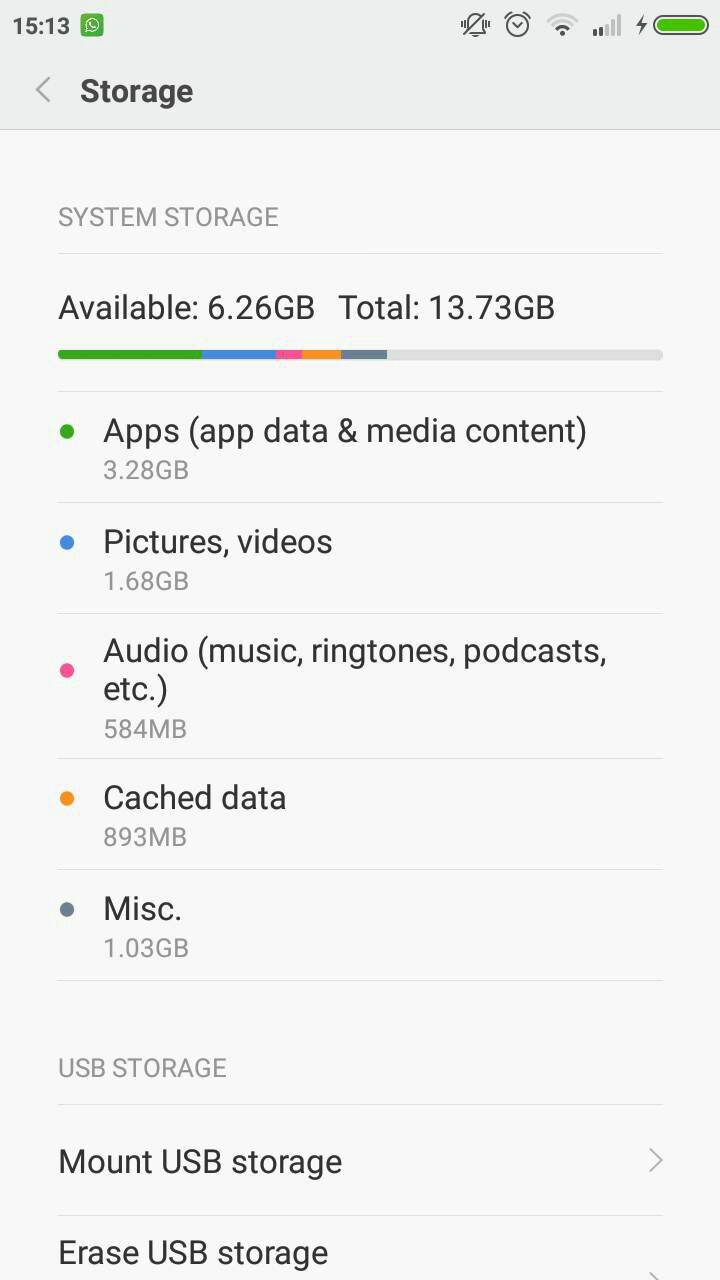

I have over 5GB free disk space and over 1GB free RAM.

Have you tried moving it to root of sd card and renaming it to update.zip then flashing it from recovery itself?

Yeah of course you have this issue, because you don't have new partition layout yet:
Follow this: http://xiaomi.eu/community/index.php?posts/268905

At what release did we go to another new partition layout? Mind you, I already am on MIUI 7; a while ago I already updated through MiFlash and only have a single partition:
So what exactly is this (yet another) new partitioning?
No I haven't; the updater wouldn't fail without reason, so I'd first like to figure out what the problem is.

New partition layout means:
1. Merged data + internal storage (5.4.24)
2. Merged two systems into one (5.11.19)
You have merged data but you don't have merged systems
Ah so there's no system1/system2 anymore!

Yeah, because there was not enough space for further ROM updates on separated system partitions. After merged systems we have got ~ 1GB space.
