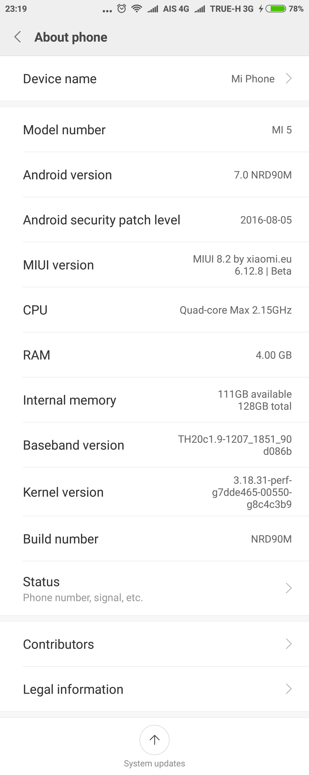

Ok,i've just successfully installed the ROM for my Mi5 3/32 version.here is the step by step i have done :
1. Install the new twrp 302.3 image (im using adb mode)
2.i rebooted the device and enter recovery mode several time until i'm sure that the new twrp has been installed correctly. There was 302.3 written on the recovery mode.
3. And then installing the new ROM.
I did find unknown command (2 red line) but it's ok.ROM still installing.
4. When finished i choose wipe cache and dalvik only.and then reboot system.
5. Devices reboot took a little bit longer than usual.
And my mi5 working as usual.i didn't find any change yet.but at least it's working perfectly
I fallowed your steps and everything is working great.
