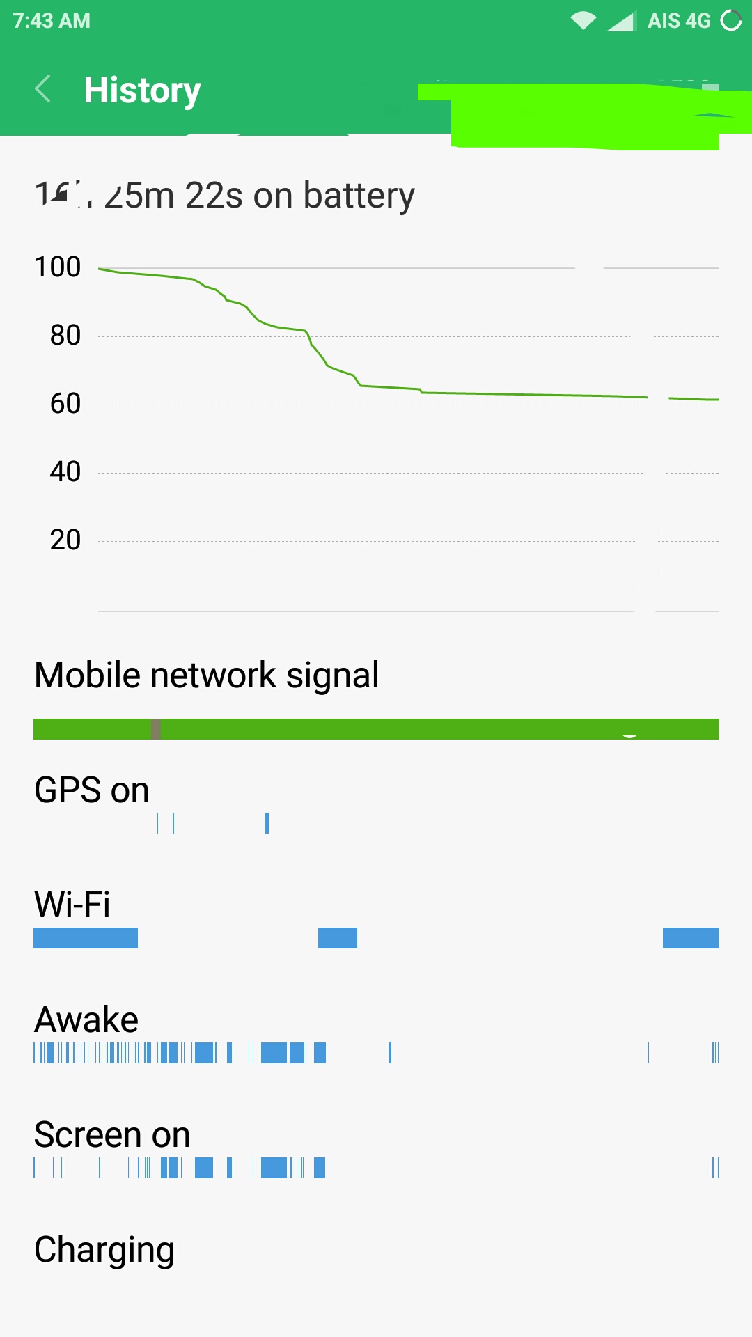

Redmi Pro successfully flashed from 6.11.24. Battery performance is excellent (60℅ left for 16 h 25 m on battery including sleep time on battery saver setting) and no abnormal drainage during cell standby
