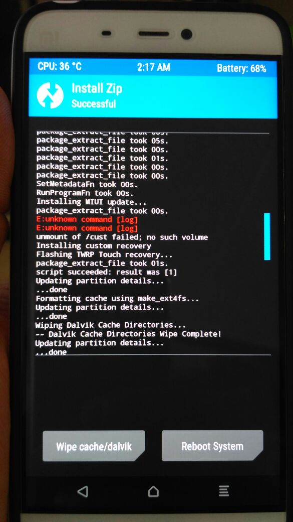

What is this error?
Afew minutes ago installed nugat on my mi5 32GB and had this error, so i flashed older version.
Is it ok to reboot afte installation with this error?

What is this error?
It is OK just reboot
