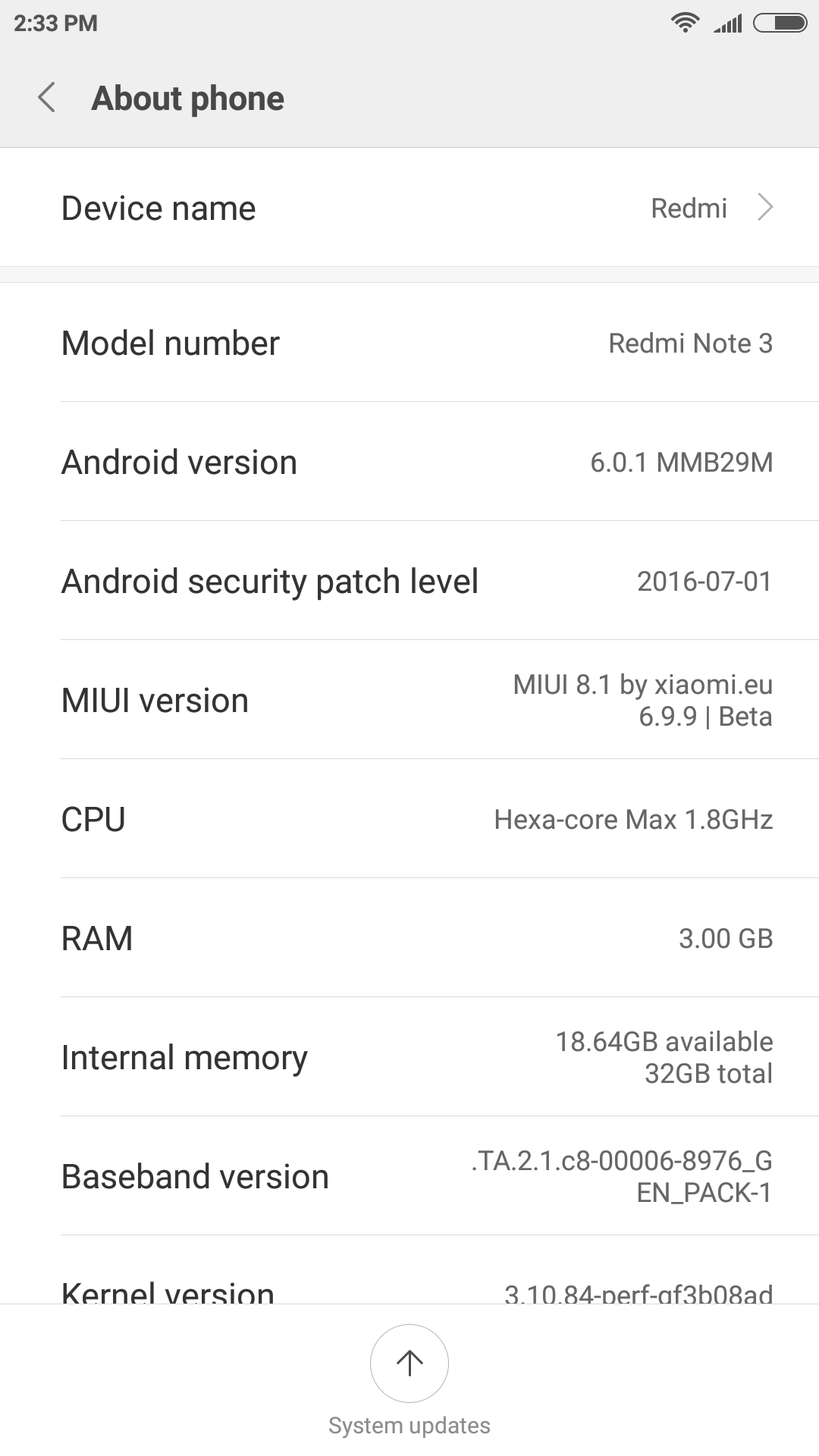

All perfect with kenzo. Clean install 6.9.9 with cofface TWRP. No problem. Thanks!
