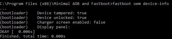

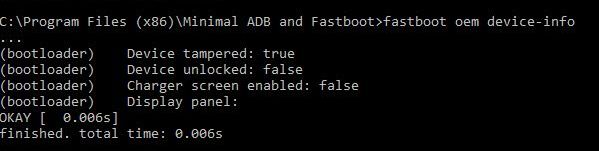

@John O Connell , @dogiex Yeah, so you would think. What I did was: I went and tried global stable ROM because of some issues I had and wanted to test if global ROM has them also. I flashed via miflash tool selecting clean all. But then I received an OTA update that locked my bootloader. Now I'm in hell trying to unlock it again. :( They made it so complicated.
@ivo.hr
In fastboot mode, give three command one by one.
Code:
fastboot oem device-info
fastboot oem unlock
Edit 2: - The above procedure is for Mi 4 only.
Edit: - fastboot oem unlock will well unlock it and erase user data beware
In the threads i linked, it was suggested to ignore what is reported with device-info and flash TWRP anyway.

Can be done on xiaomi.eu ROM if previously unlocked officially before. Just use Mi Unlock.
Really? I tried but unlock says unknown device. I did only try and unlock it using dev version. It's original unlocked using stable ROM. So if I flash stable ROM that the device had before, in theory you mean to say unlock should work?
So, tried global stable and trough OTA update it locked my bootloader. I'm trying to get back to eu rom for days now. Xiaomi allowed me to unlock my bootloader after sending request but it gets stuck at 50% at verifying my phone. (Mi4)
No locked bootloader on Mi4, no need to do anything, just flash twrp in fastboot mode
You need to be logged in on the device with account that has permission to unlock.
In theory flashing the original rom that was used to unlock the device and been logged in with the account that has unlock privileges should work.
Changing Android version is what can cause bootloader locks.
