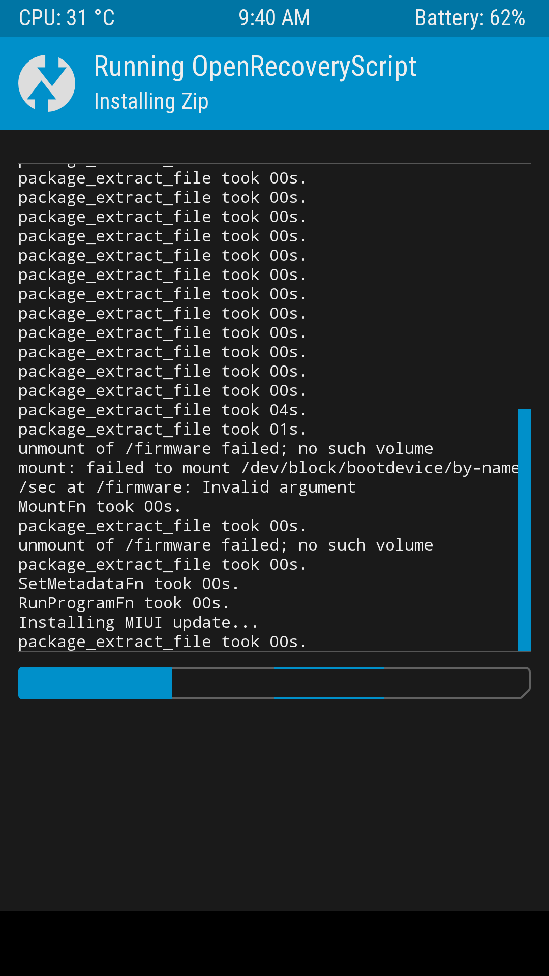

Short question: are those lines about firmware volume not found etc ok during the flash?
