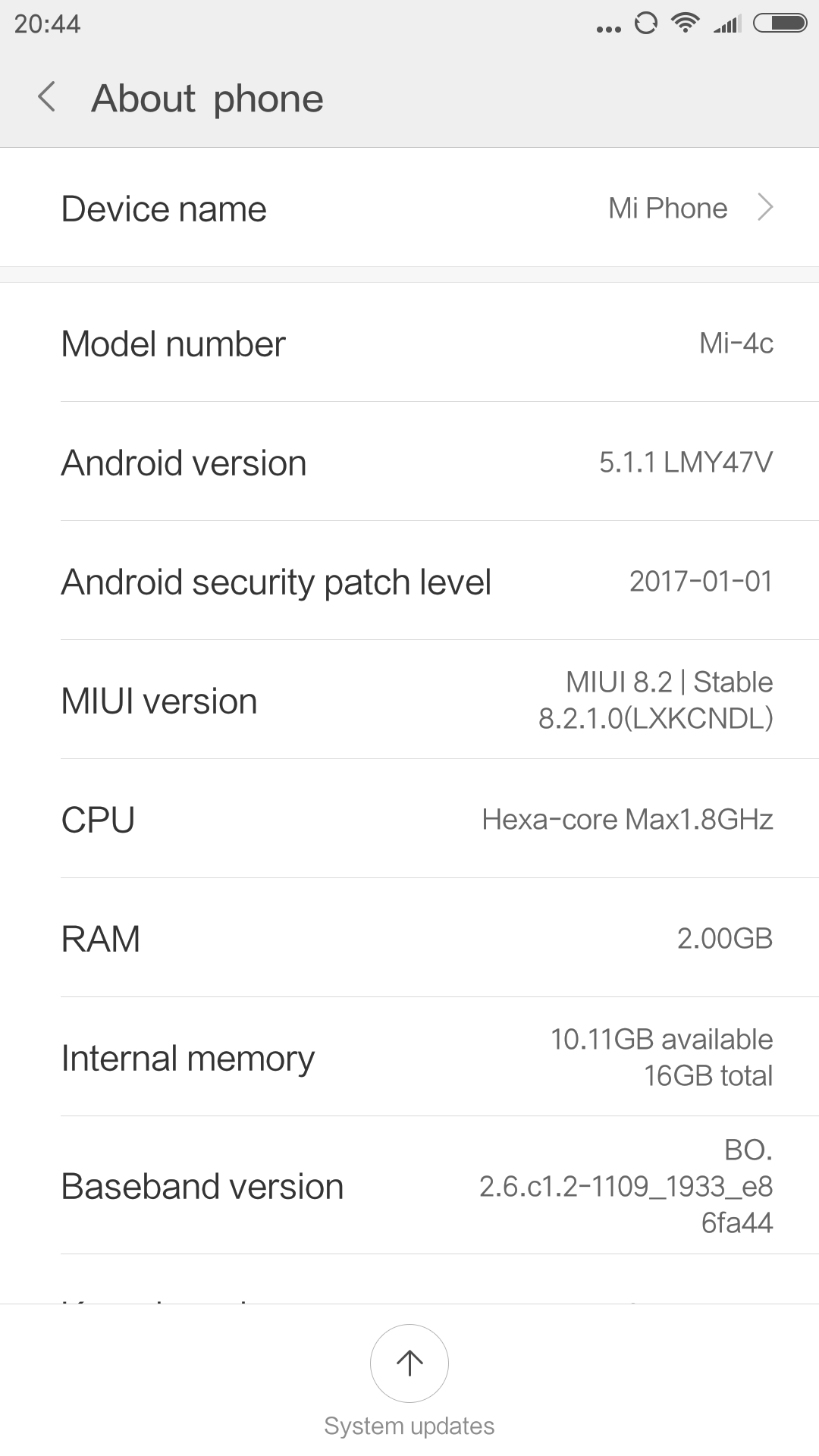

Thanks for the fast response. I am currently unable to do that as apparently my bootloader got locked somehow (despite always using 3rd party roms, either from Xiaomi.eu or others (like CM or mokee)) and I do not have any recovery installed...
I'm now in the process of installing some official fastboot devrom, locking my bootloader on purpose(already asked again for unlock on the miui site for that) and start over from there (see if stock recovery got fixed in the process and all that...)...
It's strange how I lost recovery all of the sudden, remind you that I was able to install 7.2.16 (released a few weeks ago) through TWRP (always had TWRP installed since I got it from the store). And the device was always rooted (I think android version was 6.something based on android 5), because I've always used weekly release roms (which on their specific threads stated they were rooted).
EDIT: Current system updated and screenshot added as attachment. Will stay on chinese rom until I get my request for unlock fulfilled from miui...
it seems the best (easiest) solution.
