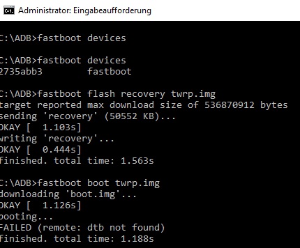

Try to find this image - TWRP-3.0.2-0-libra (Recommended).img and flash it (it's about 20 megabytes).
Thanks for your feedback" Unfortunately this was not the solution. I downloaded the file twrp-3.0.2-0-libra.img,size is 49,3MB.
After flashing I got the same error message „dtb not found“.

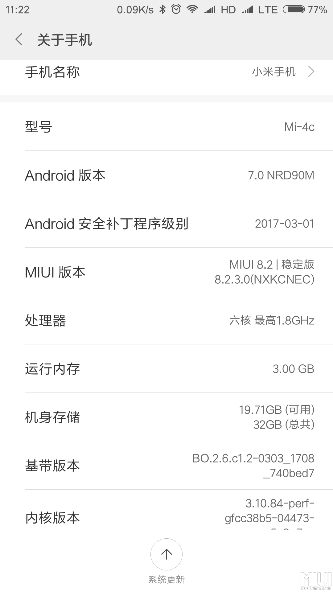

My Mi4C is in the MIUI version 8.3 | 7.2.16. What procedure to install the current one? Do I have to unlock the bootloader?
