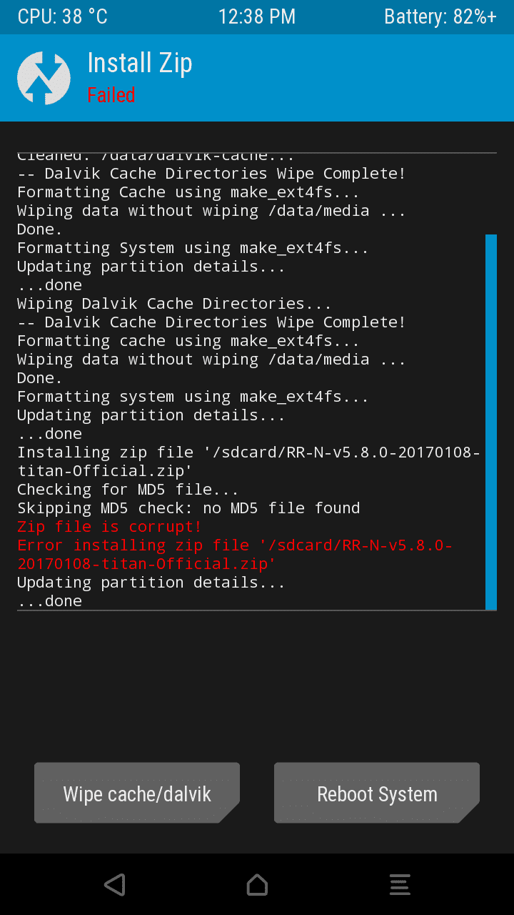

No. i had 8.10.12 xiaomi.eu Mi 8 rom in the phone. i download the 8.10.18 xiaomi.eu rom by Free Download Manager in a widnows PC. Then i copy the corrutped file to a USB-c flash drive. I inserted the flash drive to MI 8, flashed the corrupted rom and flashed magisk 17.2 and wiped cache/dalvik by using TWRP (L.R. TEAM 0908 version). Then the phone screen would not lighted up again, black brick. Phone connected to PC shown in 9008 mode. Miflash tool need an official maintenance account to flash.
There were not any error, stop nor warning information by twrp.
You can corrupt a latest rom fiile to flash for testing if you like to.
Hmm. Thats weird that twrp can flash corrupted file. What twrp did you use? I just checked the twrp that you mention but it was not on xda thread. I didnt have mi8 to try anyways.

In my experience, this error usually comes up if you had a bad or corrupted file or something like error 7. I never had a success install if the file were corrupted. TWRP can detect it.
