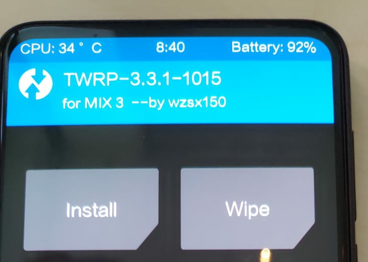

dirty installing this broke my install. It seems to be down to the download coming with a recovery install. What happened was that when trying to install the system did not want to boot after install and going back to recovey just caused bootloop. Reinstalling TWRP then did not prompt me with decryption and did not work with command line decrypt either.
Clean installed on top of that and after setting up I went to TWRP to make a backup and noticed that TWRP has been reinstalled again with a new version (noticed due to different TWRP boot logo and language set to chinese by default which my install did not).
Why was TWRP included in this package for MIX3?

first a big praise to all developers and my thanks for your great work.
When installing the improved version of monday, a twrp flashed on my own. I uploaded a photo.
works great but how does that work?
anyone have a clue?
greeting

I did not have it installed, but when I restarted recovery only came the normal 3.3.1, restarted again and then wa of this recovery on it. I just do not know why. but it works really well

i would love to have this if the encryption is back.
Yes encryption is back.
I searched the Internet for the .img but not found. As if with magic hand it is on the mix 3 now on it. Would it like to install this recovery on the mix 3 of my wife but do not know where I get the .img ago
Mi Mix 3 - last update, TWRP-3.3.1-1015-wzsx150, clear install, all wipe's.
