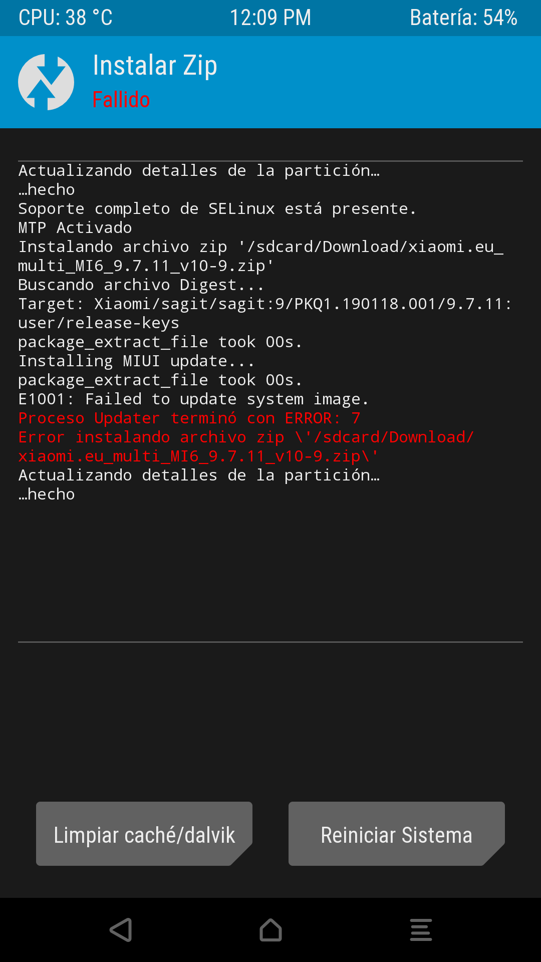

I Lost all files error 7 reset factory

I Lost all files error 7 reset factoryView attachment 25316
Xiaomi mi6
Did you format system partition?
If so, you may need to install official rom from Xiaomi, through fastboot, and then install Xiaomi.eu rom, note that all your data will be gone...
When installing fastboot, if you use xiaomi flash tool, make sure not to lock bootloader...
Before doing this, try to format data, and sd card, download the EU rom, and try again...
Make sure to use twrp3.xx
