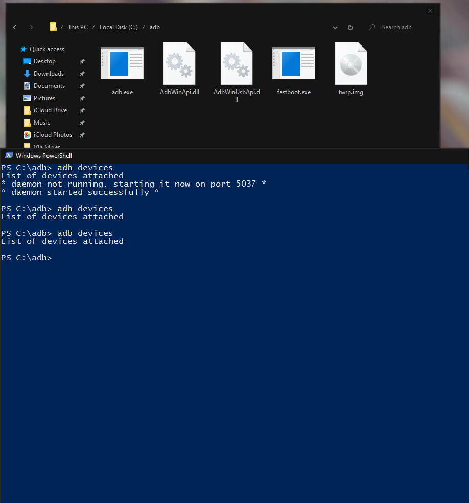

Hi all, apologies if this is in the wrong place. Looking for some advice. I have not really dabbled in rooting or flashing for around 10 years so im super rusty and cautious. I have a Mi 10T Lite from the UK Xiaomi store. I would like to flash the Xiaomi.EU ROM for custom themes so i have successfully unlocked my bootloader and now at the install twrp step im coming across powershell not detecting any devices.

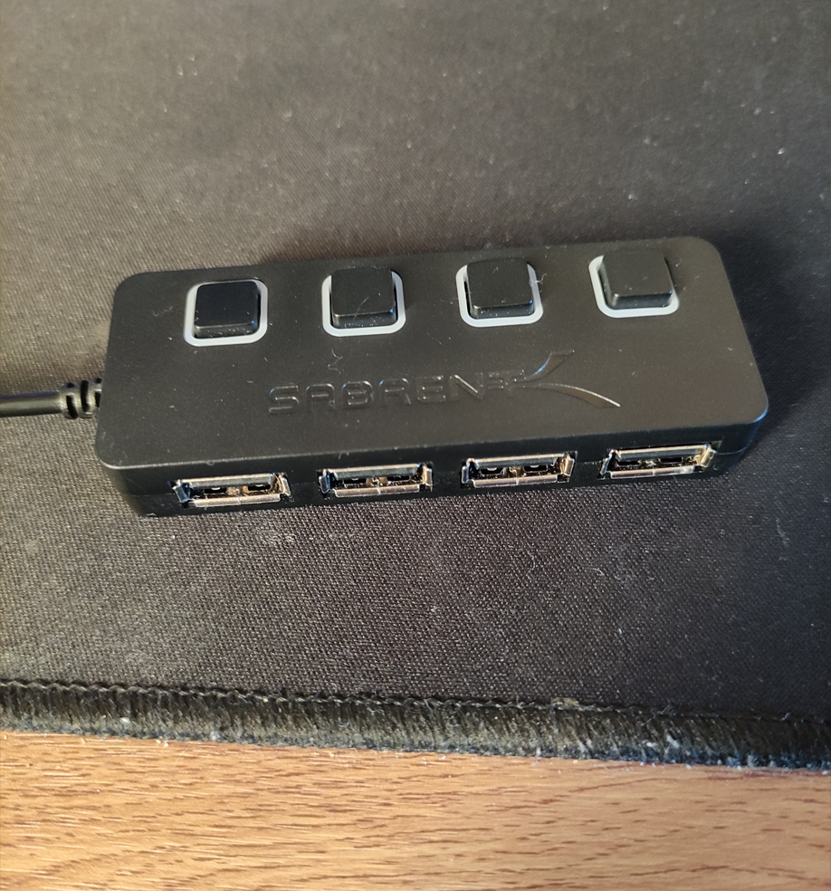

Im sure i have the correct drivers installed, im trying with usb debugging enabled and disabled, im trying with usb 3.0 ports on my comp and a usb 2.0 adapter hub and nothing is working. My fear is that im missing something blatantly obvious thats probably staring me in the face xD
Any help will be much appreciated, thank you.
Ryan

Sorry i forgot to say, the phone is in fastboot mode while trying all these things. Just tried command prompt and i get the same result, like theres nothing there. Can someone point me towards the latest drivers for Mi 10T Lite please? Cant help but feel i have a driver problem. Thanks so much for your replies so far guys.
EDIT: I attached pics to my original post of what the powershell was saying, cant you guys see them?
Послато са Mi 10 помоћу Тапатока
C:\Users\ryan1>adb devices
List of devices attached
C:\Users\ryan1>
First time with usb debugging, second time without so no matter what, this is all i get with powershell and command prompt:(
