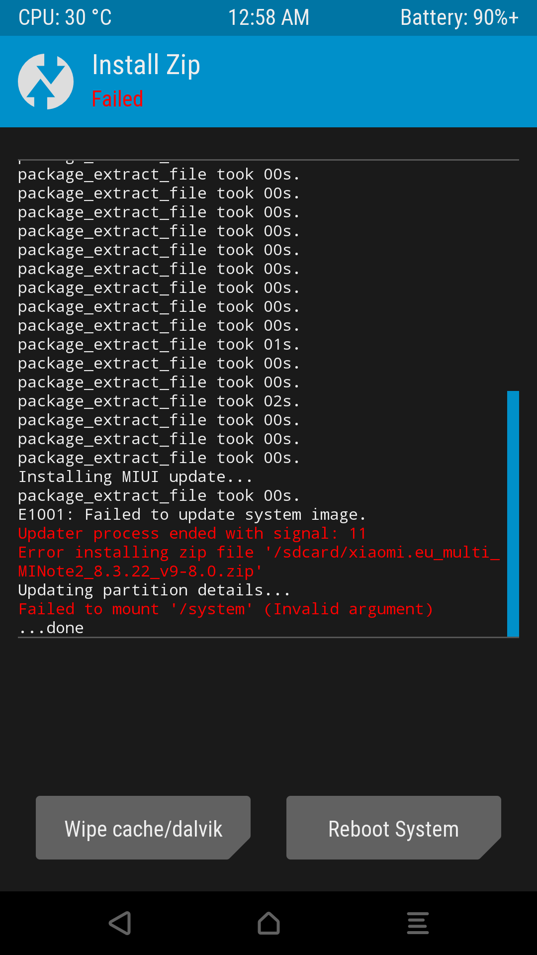

Dear All
What TWRP shoud I use for Xiaomi EU ROM ?
I try all of them.
All the time I get error during installation .

Try this:
do wipe sysyem, cache, data, dalvik. reboot in recovery and flash of the Oreo.zip rom
Inviato dal mio Mi Note 2 utilizzando Tapatalk
This TWRP is for scorpio Mi Note 2 ?
For weekend I will try again to flash xiaomi. EU ROM.
This wipe I make in TWRP before flashing EU ROM?
Yes it is for Xiaomi Mi Note2.
Do the wipes and then restart in recovery.
Then install the Oreo eu rom zip firmware.
I do like you say ... but now no recovery no fastboot mode on Mi note 2.
When connect to Pc say unknown USB devices :(
What now ??
