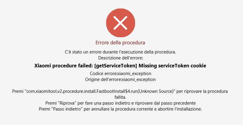

Try using the XiaomiTool - https://www.xiaomitool.com/V2/download . It does everything for you.Someone can help me with the mi unlock problem i think i don't have the driver but the driverinstall.exe and the driverinstall64.exe doesn't work, also the check driver to install into mi unlock doesn't work, what i have to do.
i'm using it, now i have this errorTry using the XiaomiTool - https://www.xiaomitool.com/V2/download . It does everything for you.
The program uses the original mi unlock - https://en.miui.com/unlock/ . For some reason, I could unlock my mobile only with Mi unlock and not this program. When you use the original, what error you get? Have you set Mi 12 from developers to unlock status?

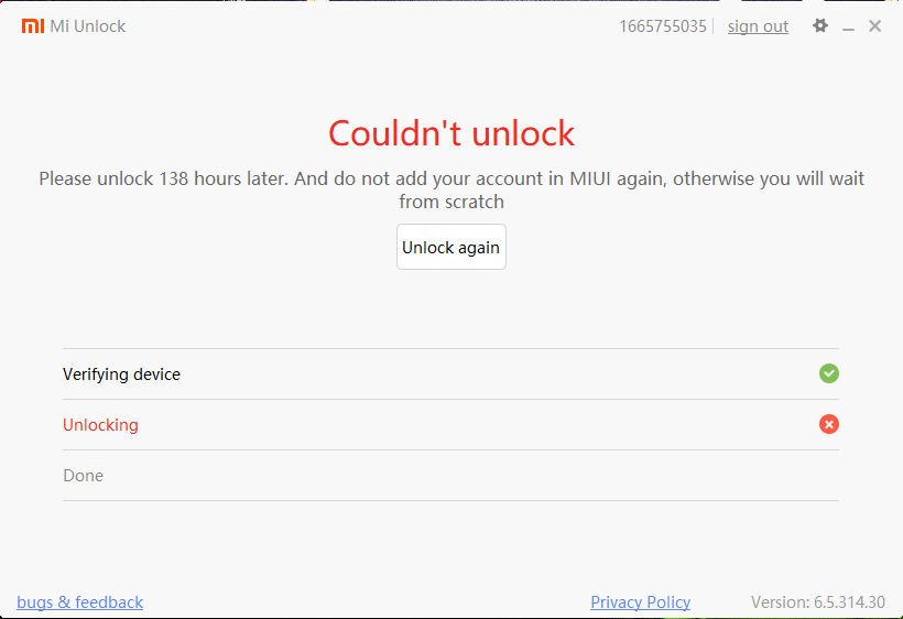

Yes i setted the mi12x, but after the installation of the driver of the xiaomitoolsv2, the original mi unlock worked fine and now i have to attend 168 hour. Thanks all.The program uses the original mi unlock - https://en.miui.com/unlock/ . For some reason, I could unlock my mobile only with Mi unlock and not this program. When you use the original, what error you get? Have you set Mi 12 from developers to unlock status?
Good to hear that. So now is waiting time....Yes i setted the mi12x, but after the installation of the driver of the xiaomitoolsv2, the original mi unlock worked fine and now i have to attend 168 hour. Thanks all.
Hmm i dont think so.... I have to wait 7hours from now, then i know if that also here. I hope notAfter 168 hour, i have to attend other 138 hour is that normal ?
