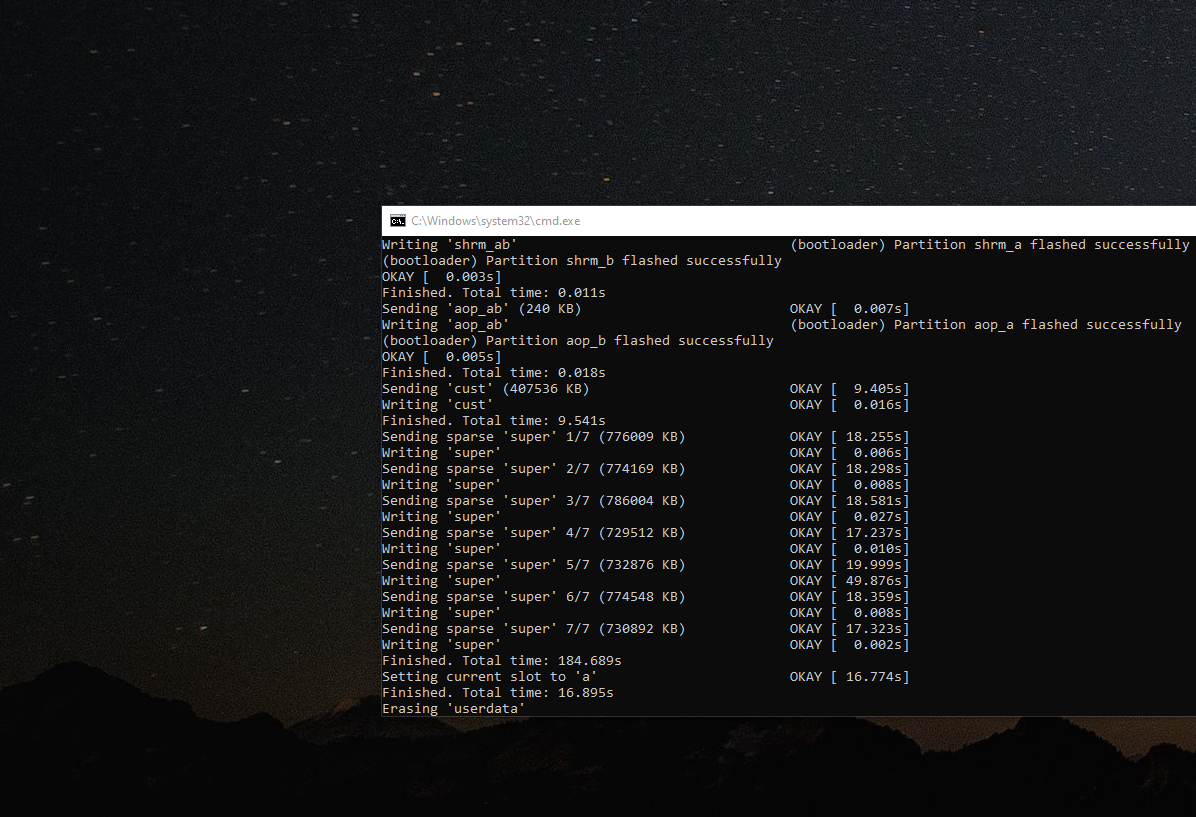

I have BRICKED my phone trying to flash this rom, I unlocked my boot loader and waited the 7 days, followed the instructions and now im stuck in a fastboot loop. I have tried to reflash the stock fastboot rom using miflash and it says it successful but i cant get past the fastboot screen please help
post log from flashing our ROM..
Installation worked perfectly! Took not even 5 min for first boot. Thanks for your hard work and your support here. You bring a lot of value to us and Xiaomi!

Hello, can someone help me flashing eu rom on my mi11?
what does it mean with
- Run fastboot installation script from unpacked zip according your PC operating system
For Windows OS ./windows_fastboot_first_install_with_data_format.bat
I downloaded the unlock tool, in a few hours it will be possible. Then I use this miflash-unlock-en and there is " fastboot" programm, right? Because i dont see windows_fastboot_first_install_with_data_format.bat ??
And after this i download the rom and follow instructions
Steps to install update of xiaomi.eu ROM (All your data and files on internal storage will NOT be deleted!)
- Download our ROM zip file WEEKLY or STABLE
- Unpack downloaded zip file in the PC
- Connect to PC via USB cable
For Windows OS ./windows_fastboot_update_rom.bat
In this case, i the data "windows_fastboot_update_rom.bat ", i need so start that?
Thank you!
Install adb tool on your PC. Go to Fastboot and connect your Phone and use the install script in the build. That's all. Don't know why people have problems to install this build with the script the format script and update script works.
