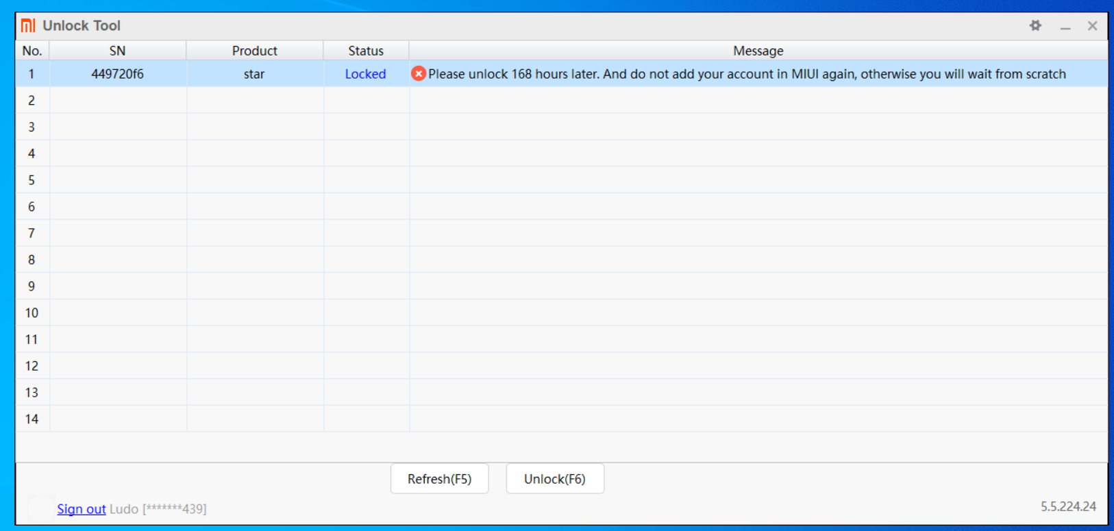

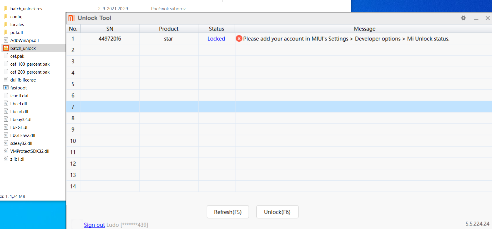

Guys, I have a weird problem that I'm unable to solve.
I just got my Mi 11 Ultra and I wanted to unlock it.
When I hook it up to my pc it's recognised and I can use it for filetransfer.
But when I connect it in Fastboot mode it's not recognised and it doesn't pop up in batch_unlock.exe.
I tried downloading several different drivers and adding it in devicemanager, but nothing works.
Please help me as it's nearly useless with the china rom on it.
Thanks in advance :)
Got it working, thanks to this video.
