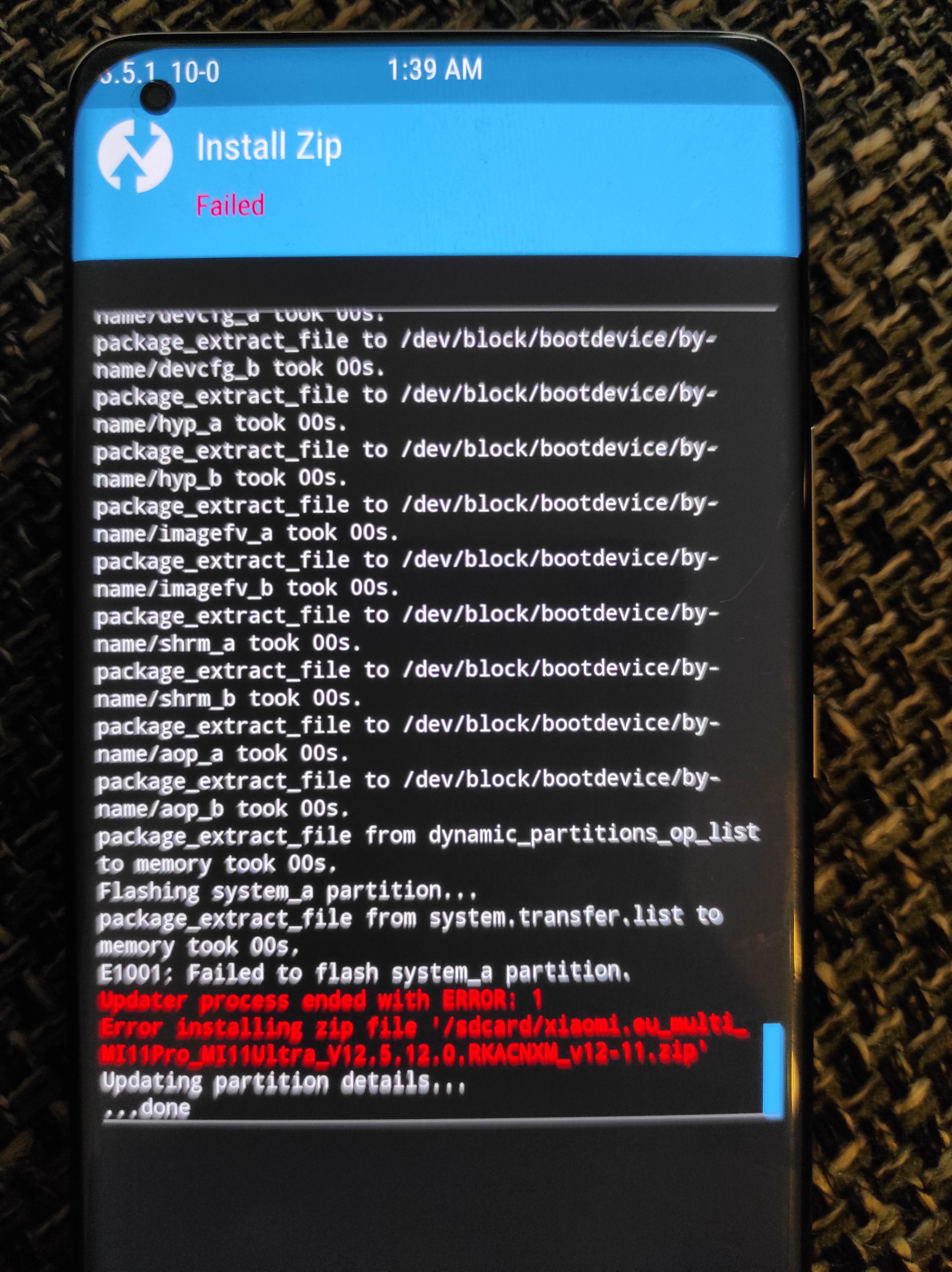

I tried to flash but I had no access to storage and after that I formated it. Now I only have fastboot and nothing else. What should I do now?
I started in TWRP now and flashed via adb the xiaomi.eu file to internal storage but all time at flashing it faults like on the picture?how can I solve the partition fault?

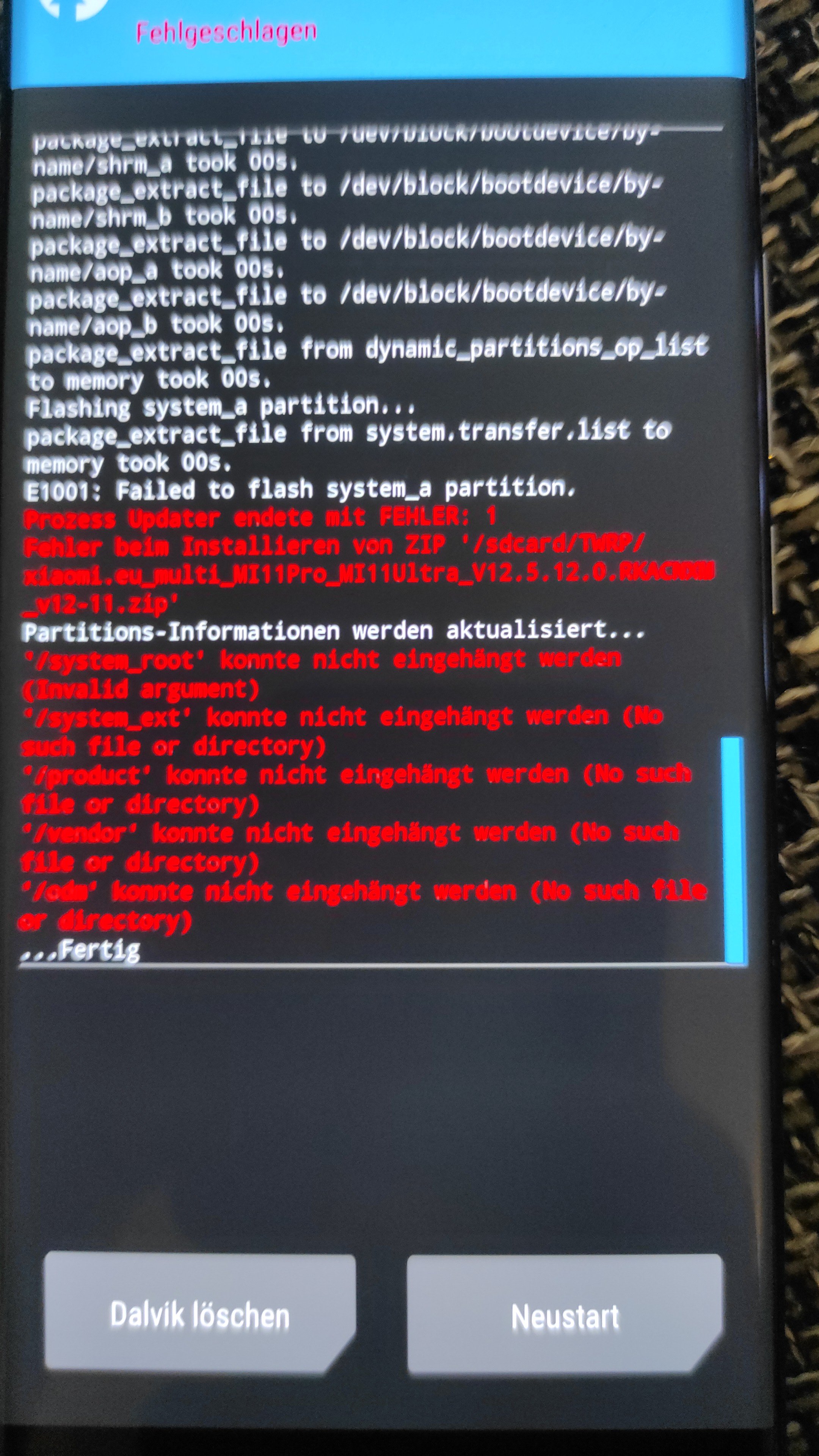

I tried it again, fresh from the cn officially. Everything as described. Twrp and then the zip install but the message comes up that the partition a could not be flashed. What should I do??
@Poney70
