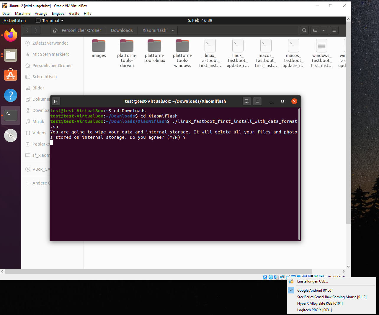

So i did setup a Ubuntu VM, downloading xiaomi.eu ROM atm. Do you think i should flash a china rom on my Mi11 or just go with the xiaomi.eu flash?
just check in updater for latest china version and install it..
Just flashed the 21.2.3 successfully, 1st & 2nd time was failed and stuck at fastboot mode, 3rd time auto reboot and flash successfully !
I flashed 21.2.3 successfully, using a Lubuntu VM in VirtualBox. Everything works fine so far. Thanks and respect for the hard work

How did you do it?
I tried to execute the .sh file and it doesnt do anything.
34681
i guess i completely destroyed it now. It wont turn on again or charge. rip....
even miflash only detects it as COM20
its in EDL now.. you need an authorizes account to flash it now..
