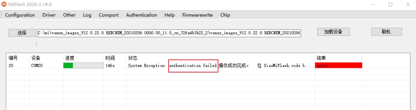

@coolqi maybe it will help you too:
"fastboot oem edl"
then flash your mi11 in edl mode
I had to flash a chinese ROM via EDL, now it is working again. Never touching xiaomi.eu-roms again.
Here is more information. But you do not need to physically open the phone. You can go into EDL mode via "fastboot oem edl"

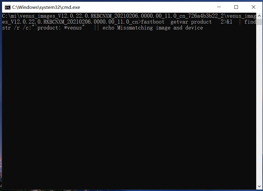

try this MiFlash
or copy "fastboot.exe" to the ROM folder and start the bat file
or you need to contact "*spam*paid*service*"
Telegram https://t.me/*spam*paid*service*
he can do it with an authorized xiaomi account via EDL for a few $
there was an other user here in the forum who can do it too
Successful unbricked with him. Thanks for you infomation.
