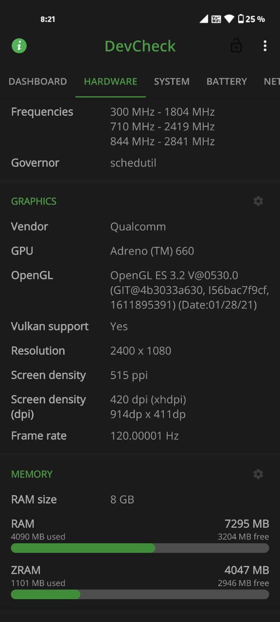

Flashed and updated to 21.3.24 just like I'm hoping for on my Mi 11 with no problem at all. Kudos to dev for the hard work!
GPU driver on Mi 11 also updated just like in the changelog and thread that I share earlier.
