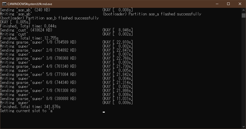

I have Mi 11 ultra and I'm trying to flash "xiaomi.eu_multi_MI11Pro_MI11Ultra_V12.0.10.0.RKACNXM_v12-11-fastboot"
so I did bootloader unlock, enabled usb debugging and fastboot.
now I've been waiting here for 30+ minutes.
If you have any advice it'll be grateful

You can try kill it and reboot to MiRecovery and wipe userdata..
All images has been flashed already.. Just wipe part missing..

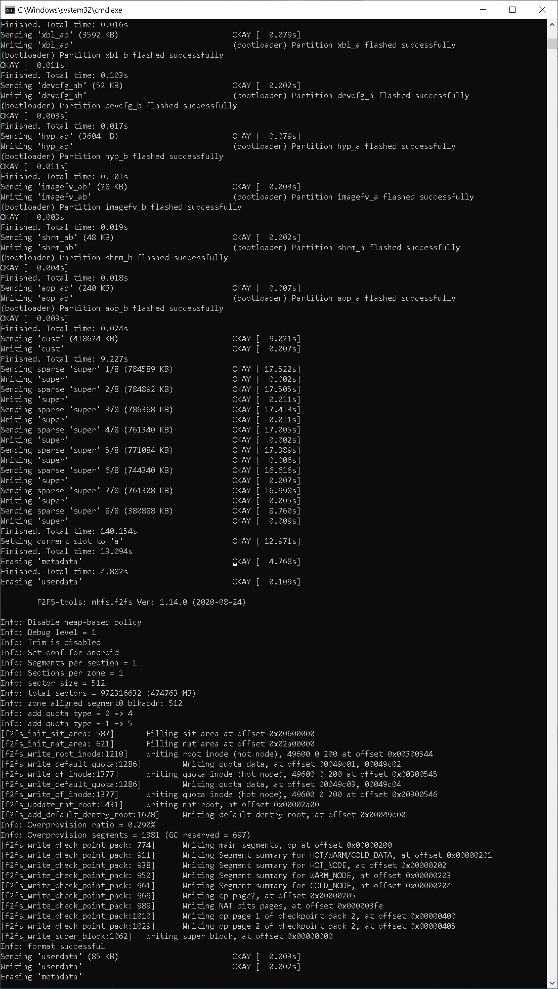

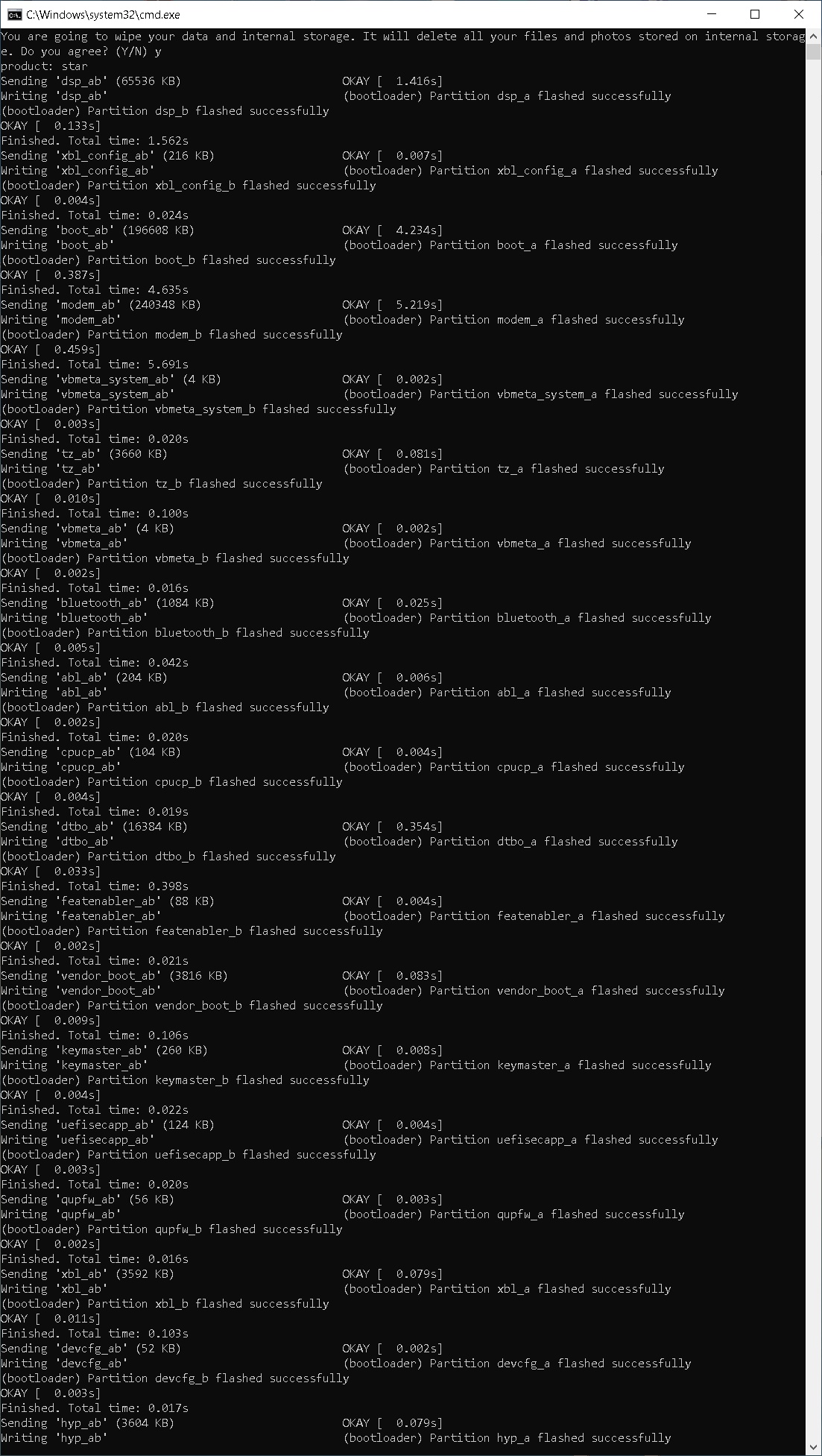

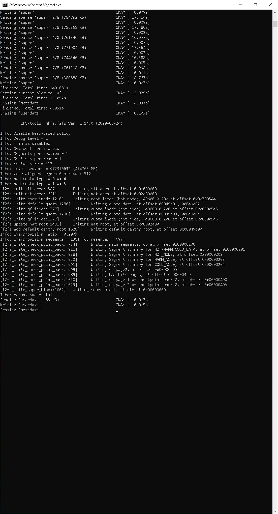

Hello ingbrzy, I have the same problem, I am in bootloop, for a moment Mi logo, than stuck in fastboot, I can't go to recovery. First flashing ended with "Seting current slot to 'a'", second attempt ended with "Erasing 'metada' "

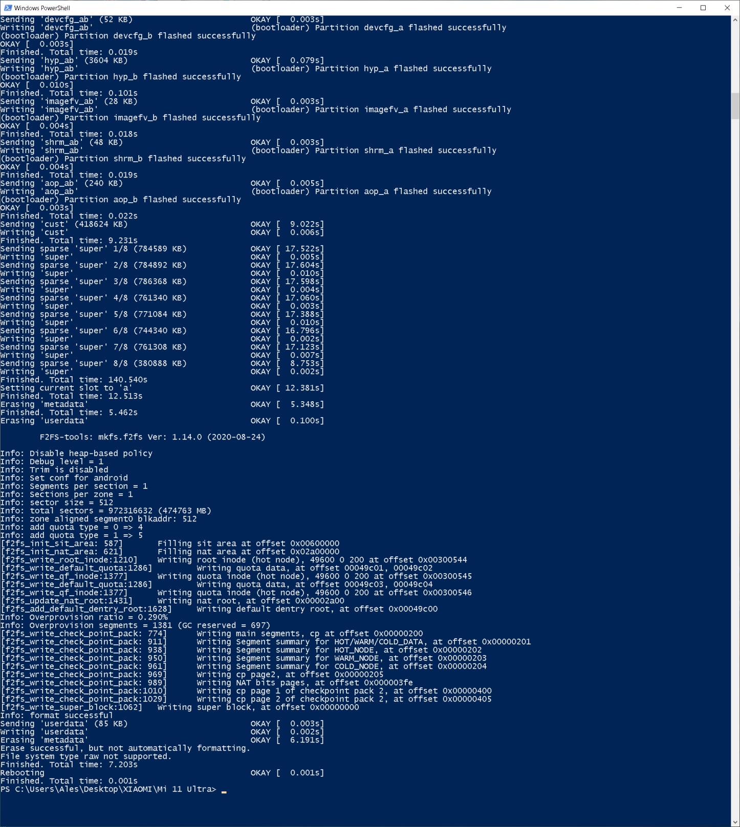

here's my MiFlash log when I got sparse crc error.
btw I flashed a global ROM before trying xiaomi.eu and then I got flashing super error.
global rom with XiaomiToolV2 [flashing super error] I might have entered fastboot loop at this time.
Xiaomi.eu [stuck at setting current slot to 'a' ]
latest CN rom [Not catch checkpoint ] XiaomiFlash problem maybe?
retry global rom with XiaomiFlash [sparse crc error]
retry xiaomi.eu [flashed successfully but stuck in fastboot loop]
enter EDL mode via adb
contacted support who has an authorized account and he flashed EEA rom.
fixed.
now I have a problem with safetynet but I can't have courage to flash xiaomi.eu.
maybe I'll try later.
Thank you for all of you.

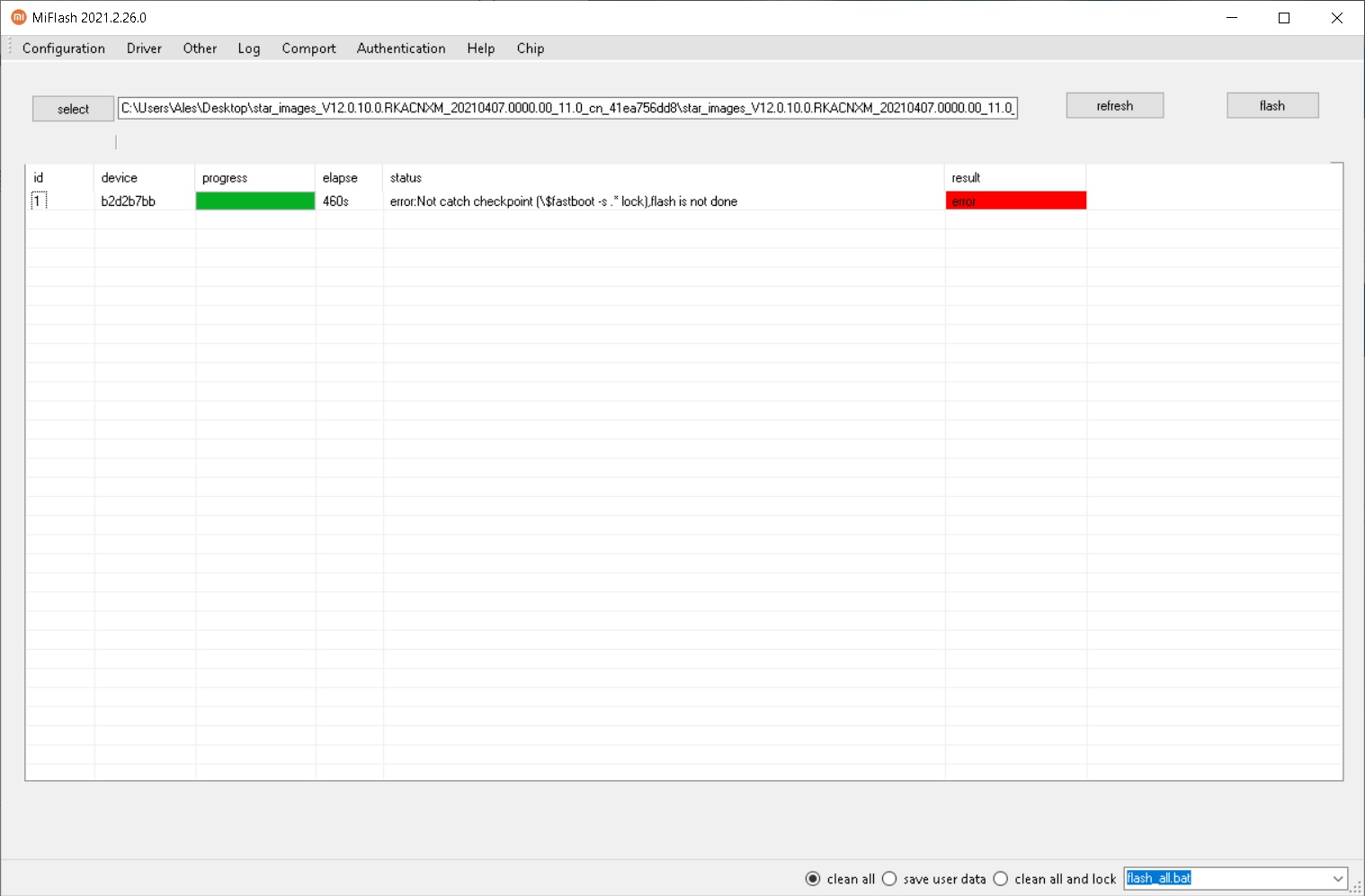

Originally installed V12.0.10.0 RKACNXM Chinese version, flashed with xiaomi.eu_multi_MI11Pro_MI11Ultra_V12.0.10.0.RKACNXM_v12-11-fastboot.zip.
Flashing with original China ROM ending with error, phone still in Fastboot
