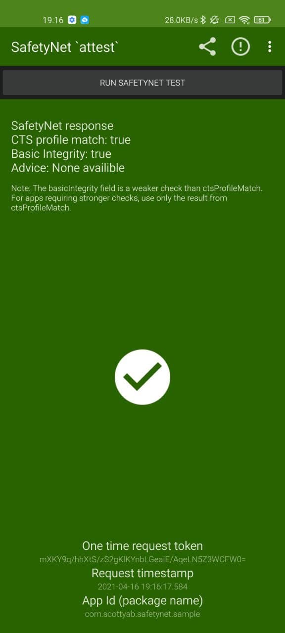

The DJVG, Is your Xiaomi Ultra 11 the Chinese version ?? I can buy the Chinese version and go through the saftynet and use google pay and banking applications ???

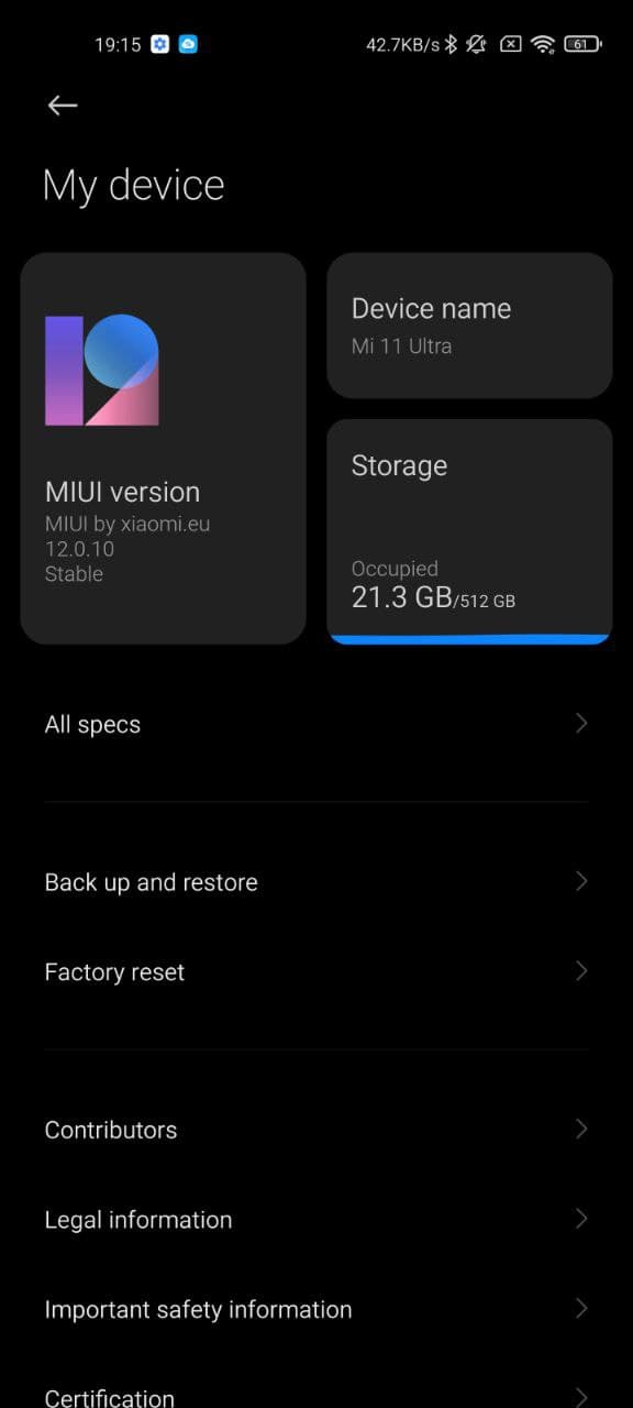

Yes Chinese version. The things you mention work for me on the current version installed.The DJVG, Is your Xiaomi Ultra 11 the Chinese version ?? I can buy the Chinese version and go through the saftynet and use google pay and banking applications ???
TheDJVG, what was the Chinese version before flashing EU 12.0.10 Stable?

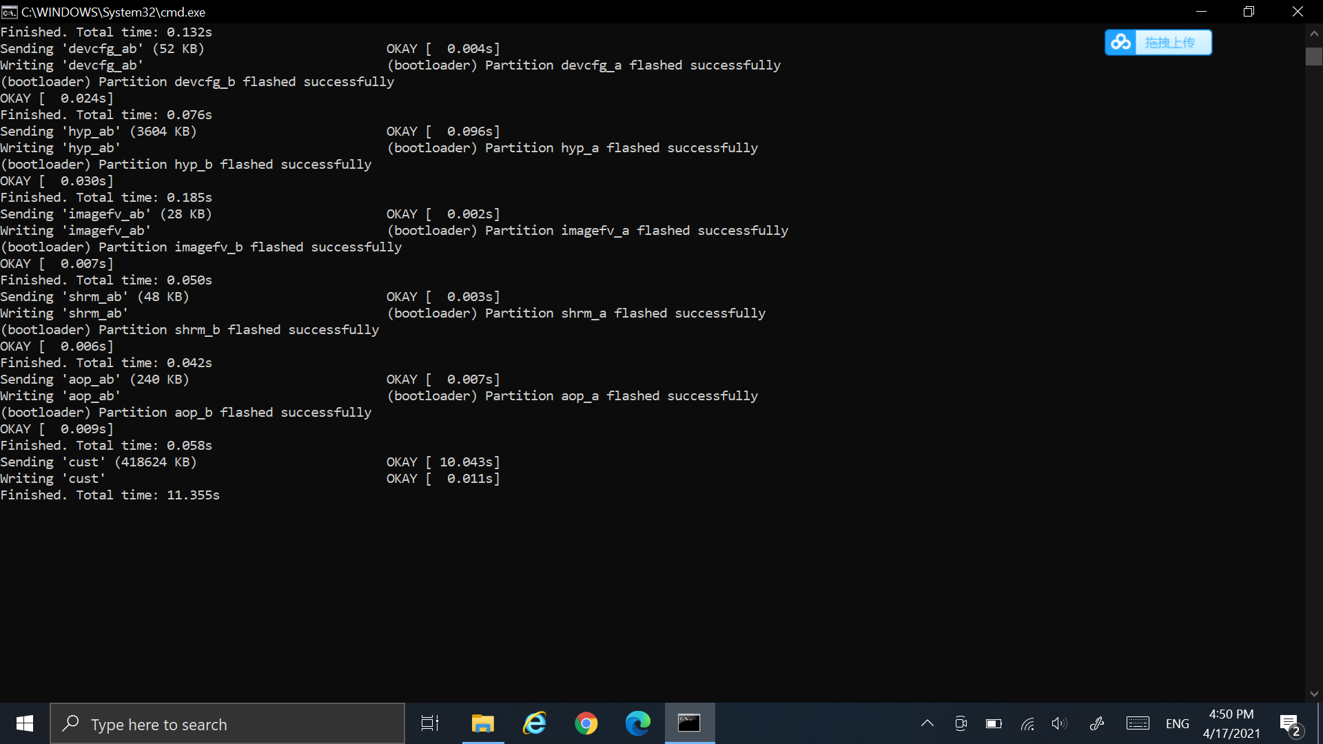

Could you write your steps of flashing the EU rom? You flashed over CMD using the fastboot script from the dev?Just want to confirm I'ved installed "xiaomi.eu_multi_MI11Pro_MI11Ultra_V12.0.10.0.RKACNXM_v12-11" on my Mi 11 Ultra without any problems using the fastboot method.
The steps are in the first post in this topic. I just did exactly what was put there and it worked fine.Could you write your steps of flashing the EU rom? You flashed over CMD using the fastboot script from the dev?
After recovery of bricked phone in Xiaomi service, again downloaded xiaomi.eu_multi_MI11Pro_MI11Ultra_V12.0.10.0.RKACNXM_v12-11-fastboot.zip, flashed Chinese V12.0.10.0 RKACNXM stable, working perfectly...O
Originally installed V12.0.10.0 RKACNXM Chinese version, flashed with xiaomi.eu_multi_MI11Pro_MI11Ultra_V12.0.10.0.RKACNXM_v12-11-fastboot.zip.
Flashing with original China ROM ending with error, phone still in Fastboot

the flash/install process is at this point not finished ! you need to wait....Redownload
Redownload and install again still no good
Update: Retry again and waiting for a long time at above stage, this time finally can boot into system and setup the phone!
