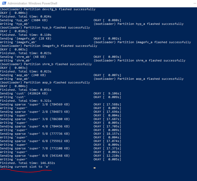

Now flashing my m1 11 ultra but kind of stops at "Setting current slot to 'a' "
is this normal? been on that prompt for 5 minutes while writing this. I haven't disconnected the phone yet. still in fastboot.

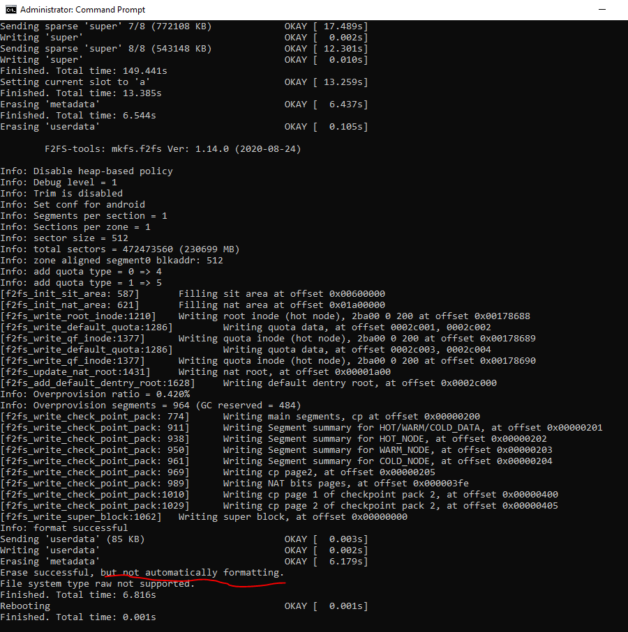

Edit: I've repeated and was successful but now just rebooting to fastboot. Any advice guys?
Probably this will not help but it is worth a chance. Put your phone in fastboot and open up fastboot in cmd on your computer then type
"fastboot set_active a" and then "fastboot erase metadata" followed by "fastboot - w" and finally "fastboot reboot"

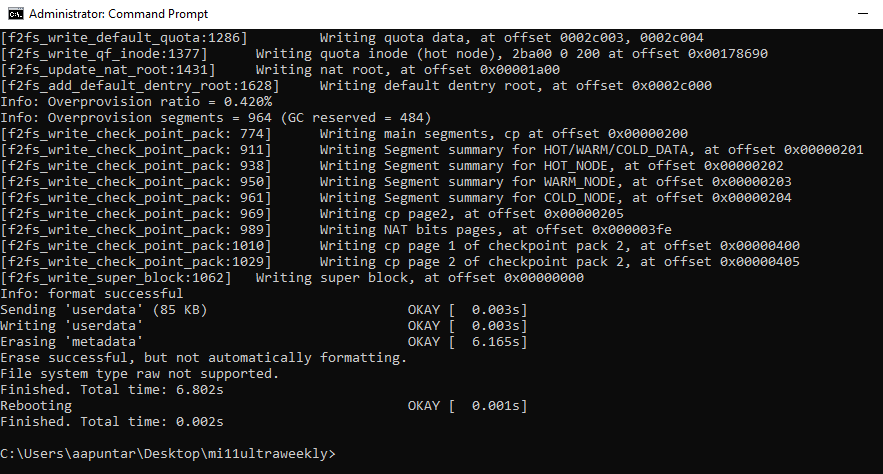

repeated again but still rebooting fastboot. then noticed message below "but not automatically formatting" what does it mean? :(

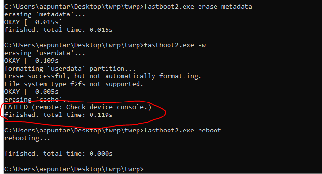

Did this but failed on formating. Did I just brick my phone? :(

ok.. try run command in fastboot:
Code:
fastboot erase boot_ab
and then run again our installation script..
use cmd, not powershell..
