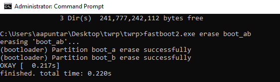

Thank you for your answer. I am still scrolling through the 53 pages here trying to find solution. I was trying to use TRWP but I guess it is useless since its not supported yet. I tried:
"adb reboot recovery"
But it did reboot into fastboot again. Which commands I should use to wipe? You have suggested above:
"fastboot erase boot_ab"
Is that something I should try?

no..
just hold buttons Volume up + power

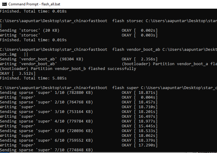

doesn't worked either. it goes to writing 7/10 super then suddenly closed my cmd window without telling any error. :(

open cmd window in unpacked folder and run flash_all.bat there.. to keep flashing log..

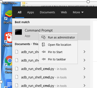

DO NOT RIGHT CLICK THE BAT AND CHOOSE START AS ADMIN
you need to open CMD as admin, then change directory to the unpacked rom folder.
then type: flash_all.bat
tried again. cmd as admin or not admin but same results, cmd window closing at 7/10. Was able to capture before closing. :(

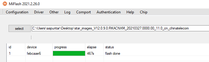

Guys. I have tried using Mi Flash Pro, downloaded the recommended star_images_V12.0.9.0.RKACNXM_20210327.0000.00_11.0_cn_chinatelecom then flashed. It was successful but still in fastboot freeze with no way to go to mi recovery.
I'm attaching the log from Mi Flash. Logs all showing success but still freeze in fastboot. any idea why? :(

is all showing success but still freeze in fastboot. any idea why? :(
