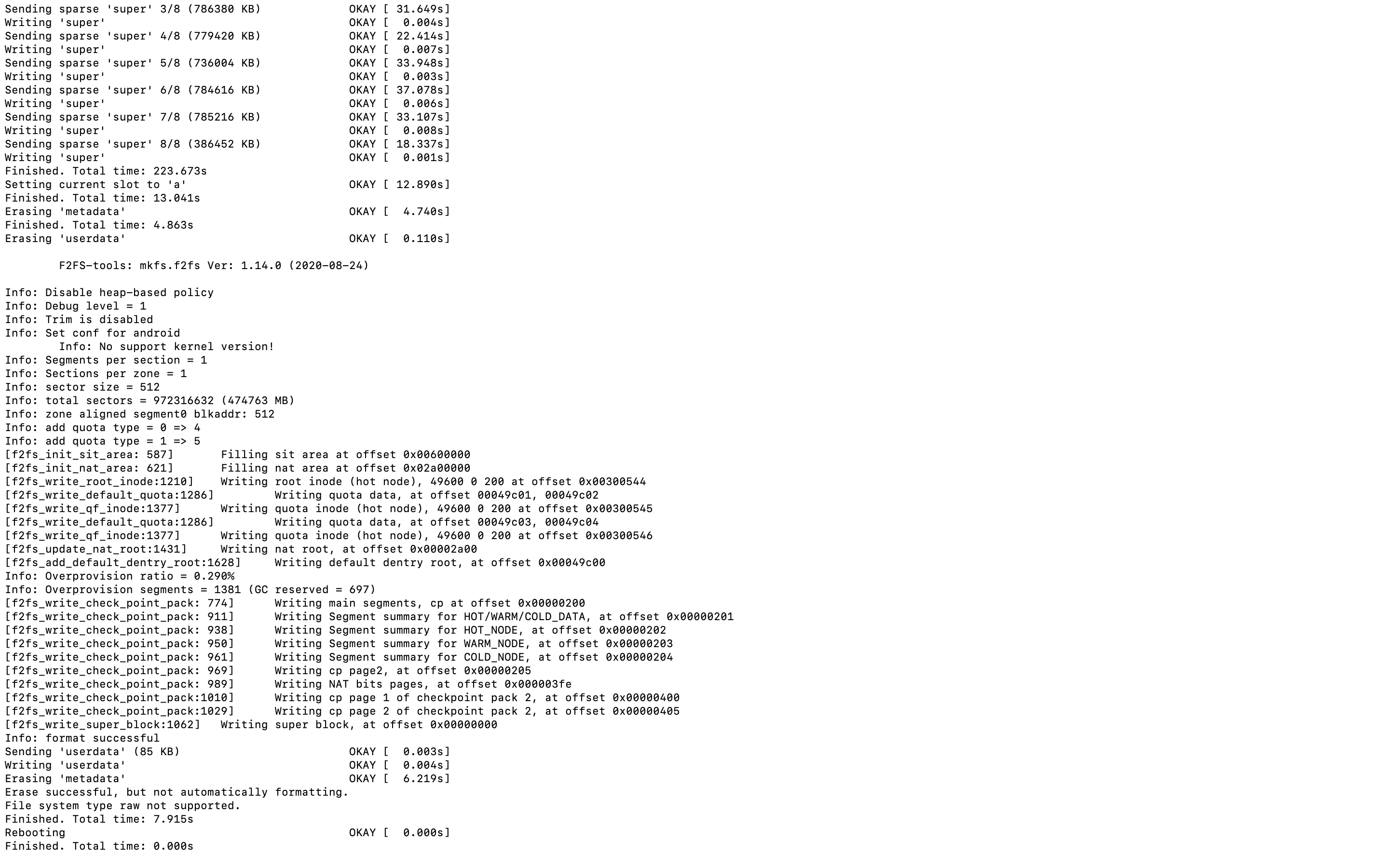

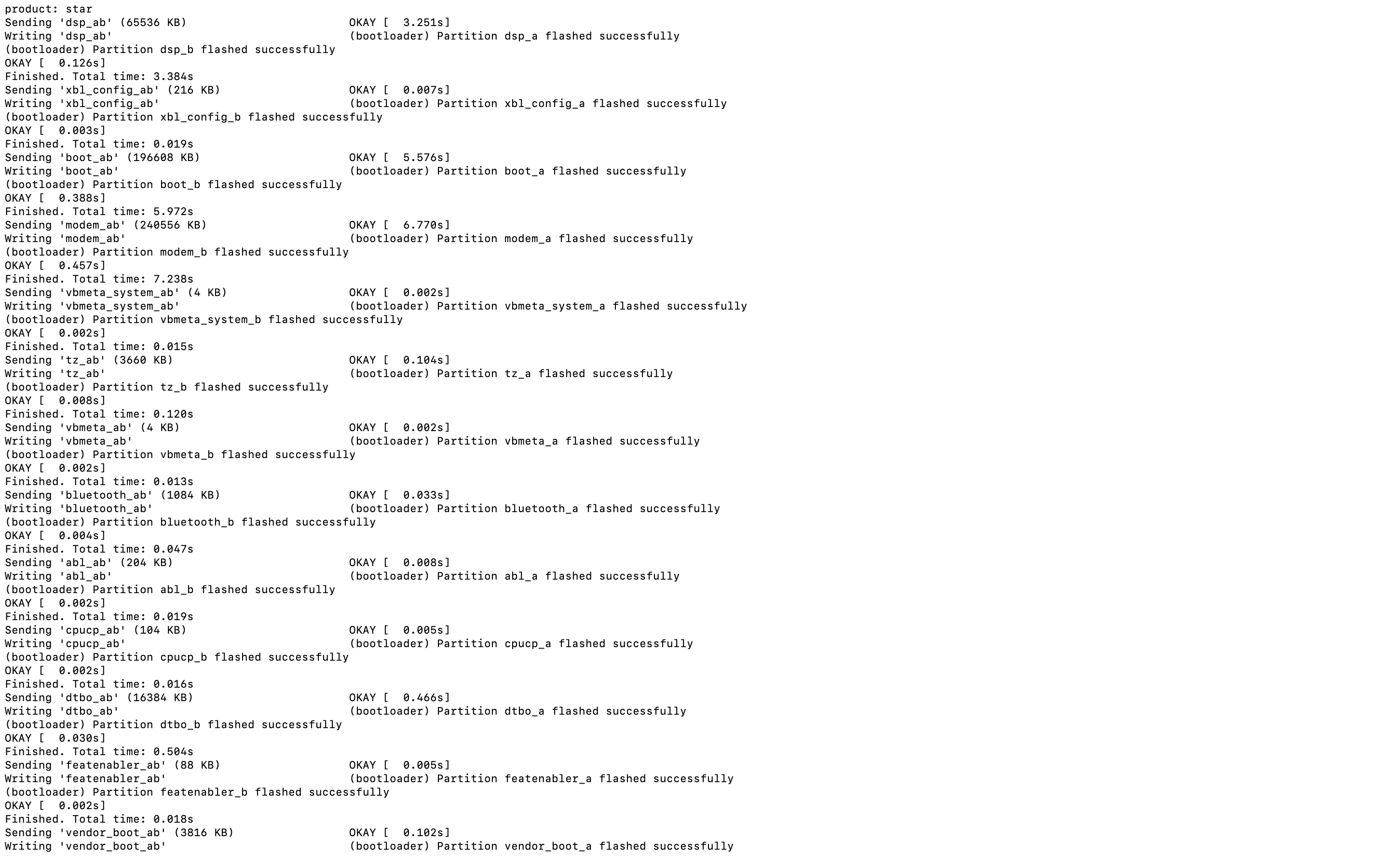

was able to get thru process and rebooted back to fastboot on my MacBook. attached screenshots if it helps View attachment 36166
