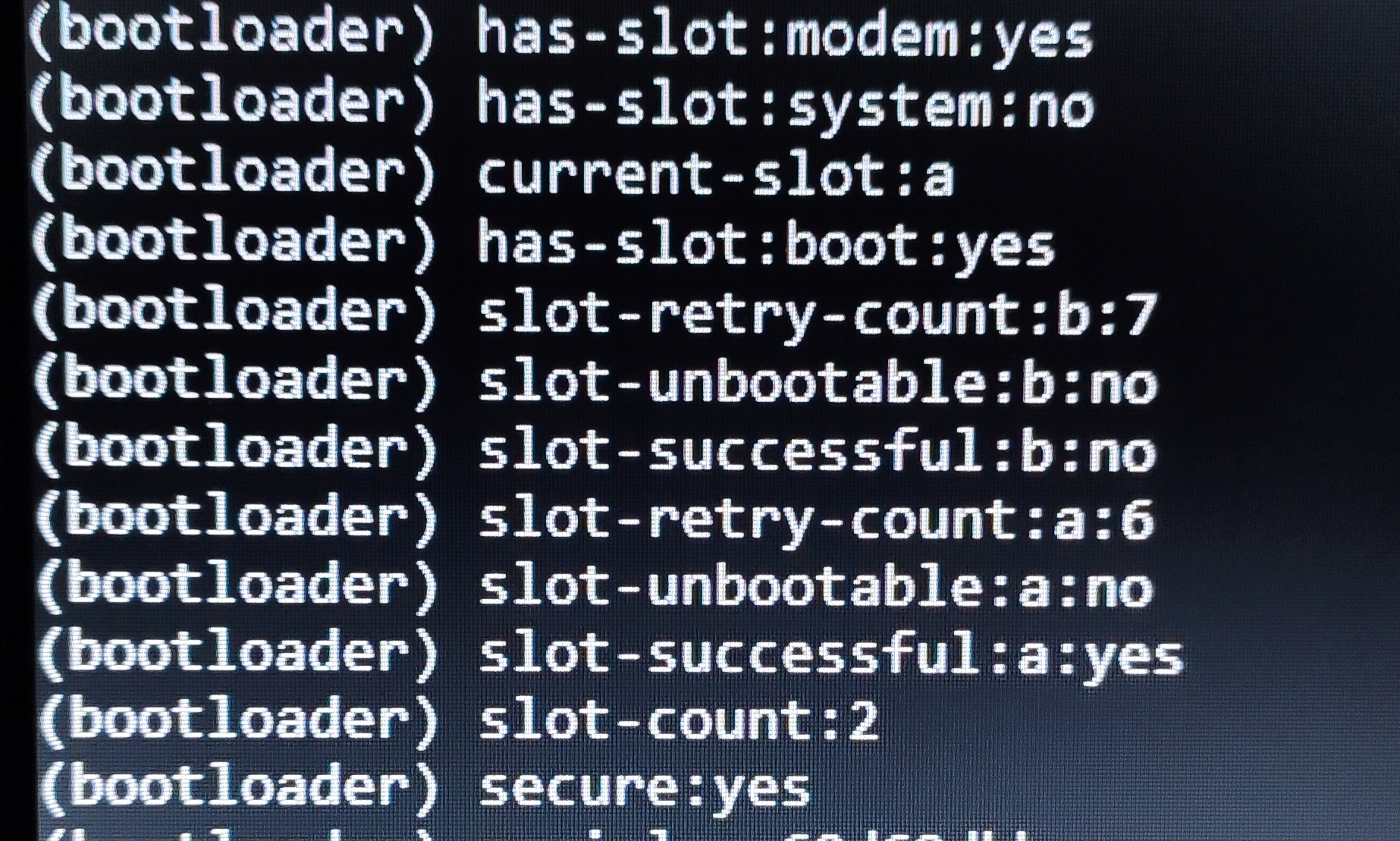

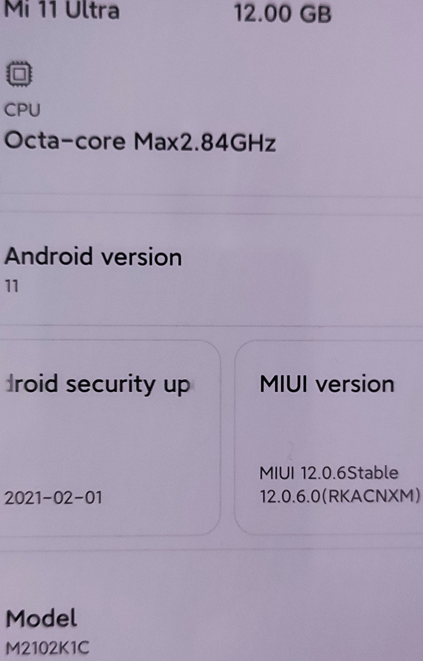

I´m on 12.0.6.0 RKACNXM , Current-Slot:A and waiting for unlock, Is it safe to Flasch Latest eu-stable 12.5.4.0,after Unlock ?
